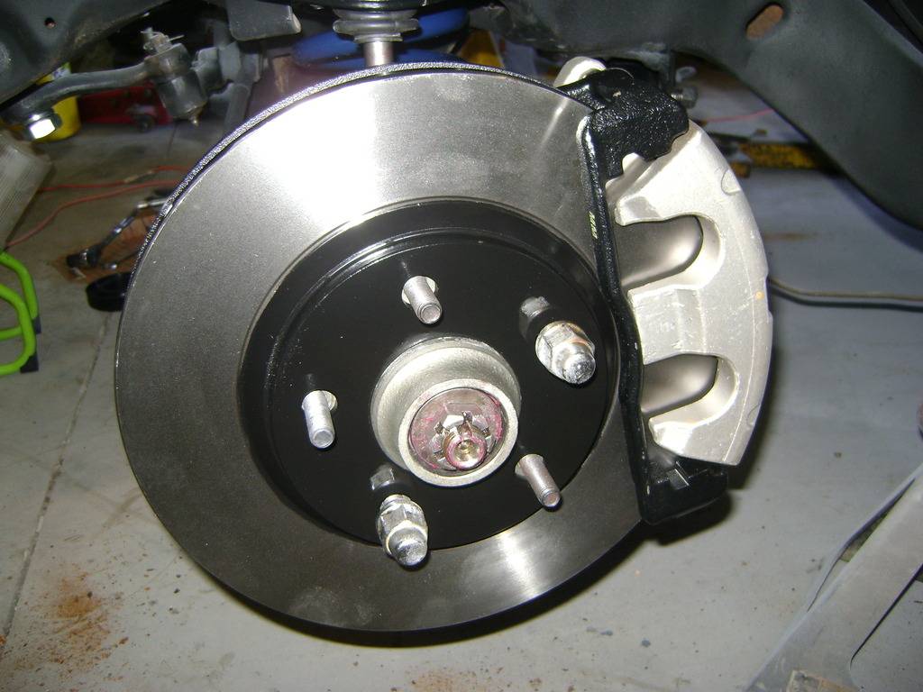

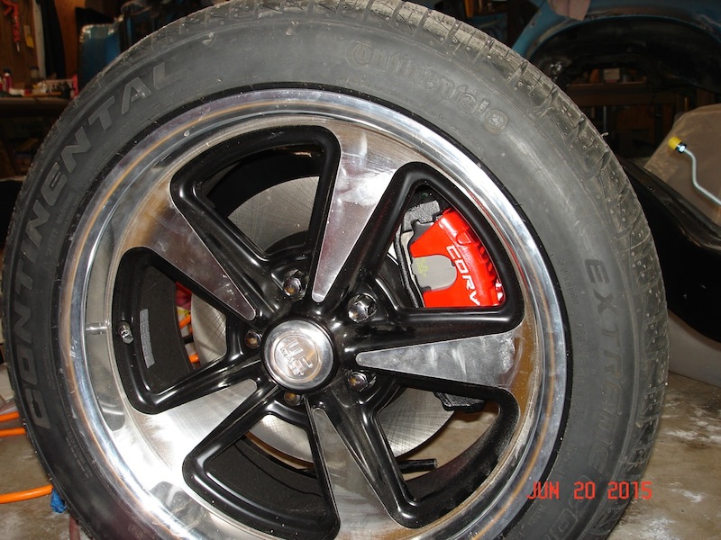

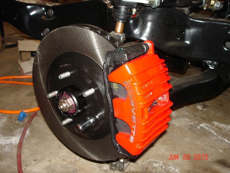

      If you want to DIY the conversion, you can run C5 Corvette brakes on your drum spindles with brackets from Kore3. You can even use your drum hubs if you turn down the outside diameter a little. I had to run 18" wheels to clear the Vette calipers.
      Here are some pics of my stuff (I'm using Kore3 aluminum hubs to reduce un-sprung weight).
      HTH, Rodney.

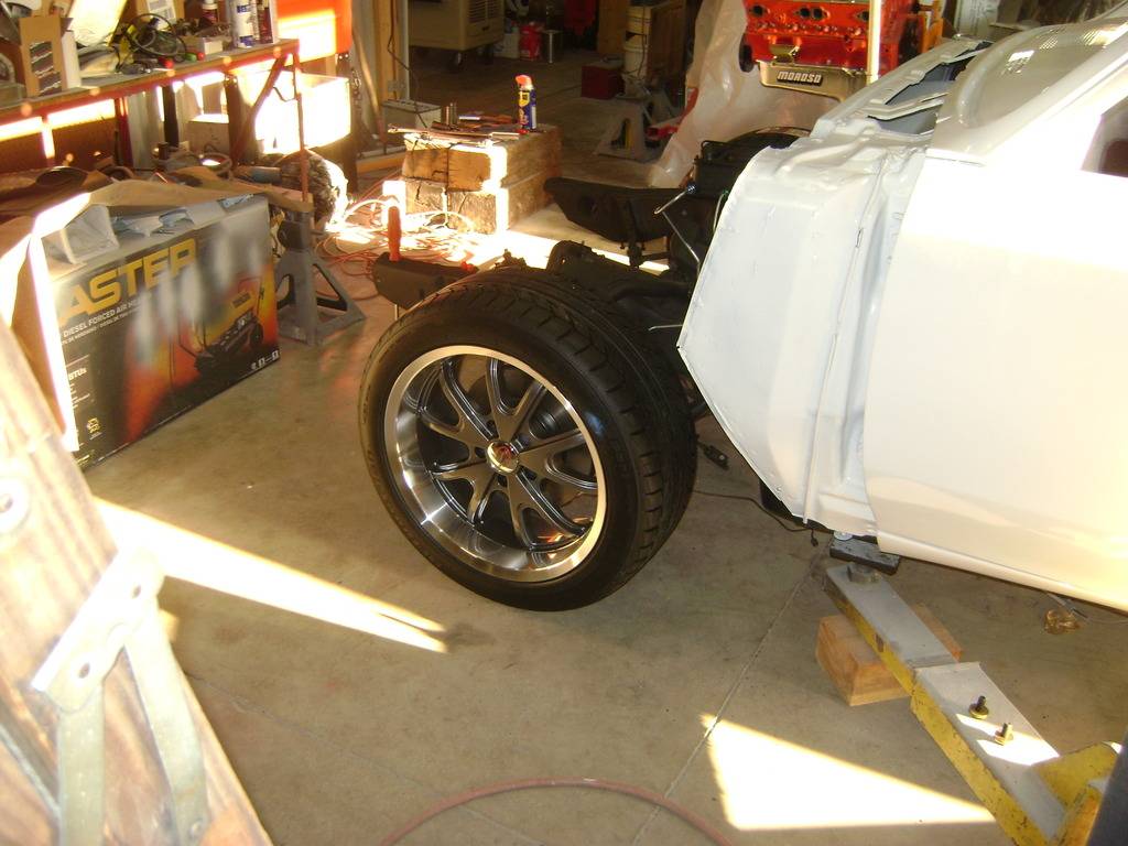

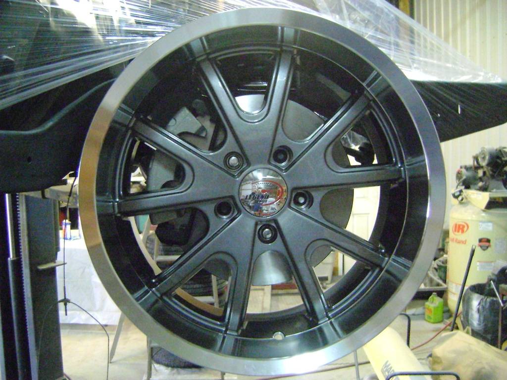

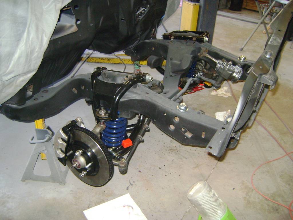

      LS1 disc brakes using your drum spindles...18" wheels shown here. Details of my experience here... http://www.chevelles.com/forums/16-b...nents-not.html

      Rich:
      Man those rims are sweet! Can provide some specs on them: brand, size, offset/BS? Thanks!
      Rodney
