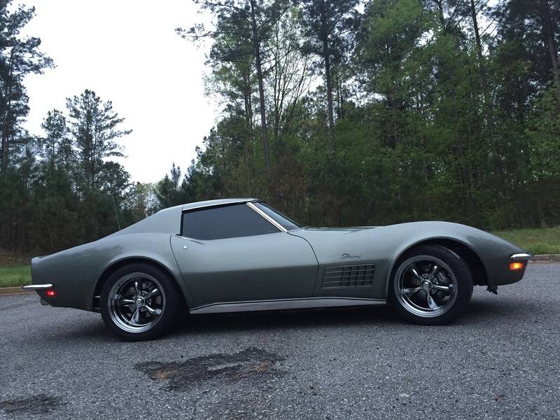

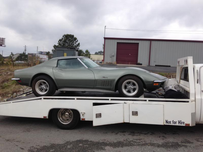

      Basically I have a 71 C3 which I acquired in 2013 as a matching number 350, automatic car in decent shape. A good friend of mine owned the car through the 90s, subsequently selling it to his uncle who seldom drove the car.
      Not horrible, paint was in good 10-15 ft condition and everything else was intact.
      A good clean up, a bit of mechanical (brakes, fuel tank, etc.) set of 17" wheels and I was rolling!

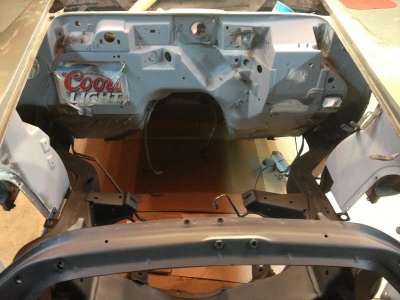

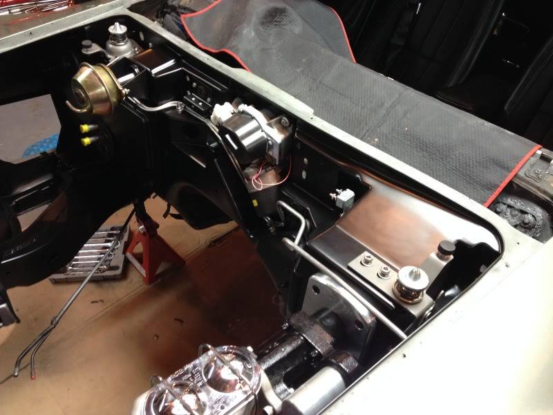

      The firewall, and entire engine compartment were cleaned, smoothed and painted by a buddy and owner of a local Corvette parts house.

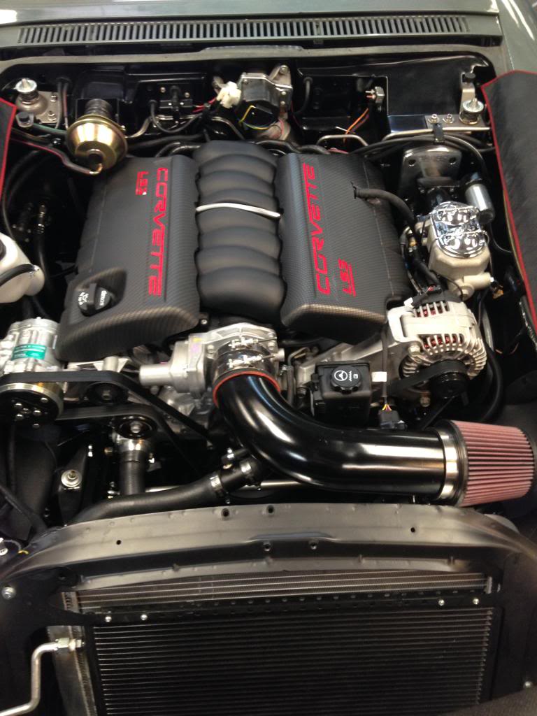

      Jumping ahead many months and many hours, the car was ready for a new power plant and at the time, Vette Brakes composite monoleaf suspension components.

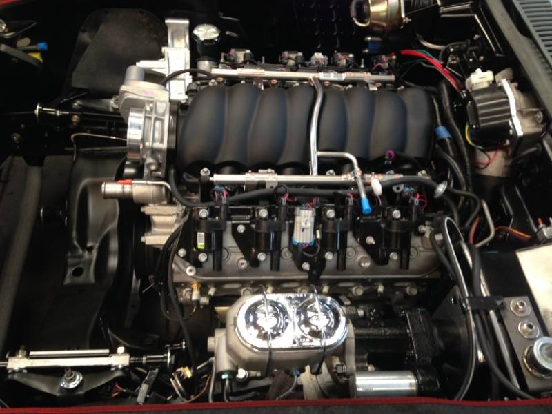

      Many more weeks later, the LS3 is sitting between the frame rails of the vette

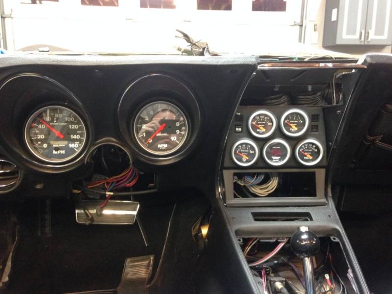

      Updated the interior with Autometer gauges to keep an eye on everything, and improve the overall appearance.
      An LS swap is no new feat, especially on a forum like this, so I'll jump past all the little details that made it all work and just say, what a tremendous improvement!!

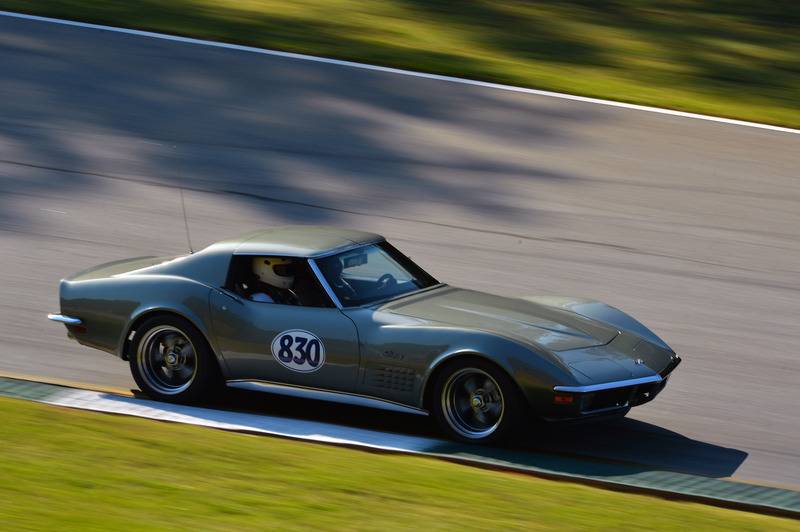

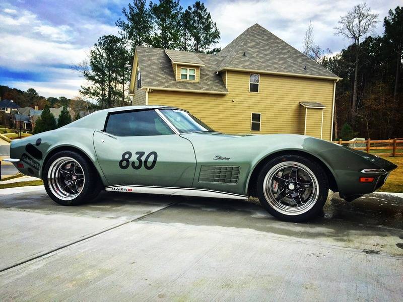

      Next step was to start playing around with wheels, as the 255 wide 17" Vintage Wheel Works were no longer cutting it for track duty.
      This is with 18x10" Torq Thrust IIs - was getting to the point of being very happy with the car. It looked good, was moving out on track, life was good!

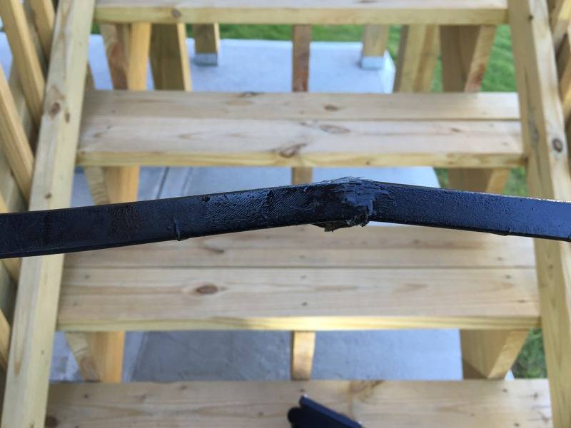

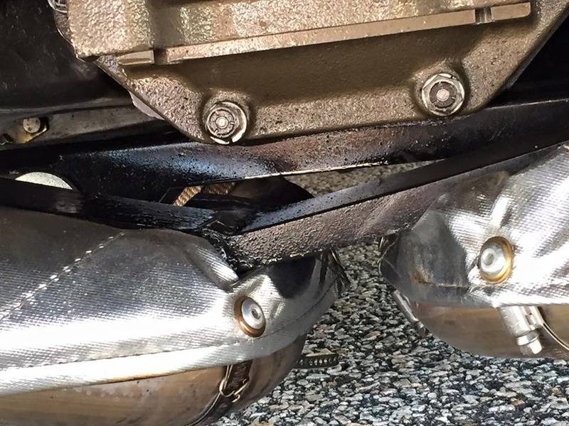

      Then I had a nearly catastrophic failure at Road Atlanta. The heat from my exhaust, and possibly some other factors, caused my rear monoleaf spring to melt resulting in my nearly loosing control on the fast back straight during a track day.
      Well that was all it took for me to ditch the monoleaf set up and give ridetech a call ordering their new coil-over suspension. If only I knew now how many more phone calls and upgrades I would be making....

      The car was performing excellent! At open track days, people were amazed this 40 year old car was blowing past them not only on the straights but all over many bumpers through the curvy sections too.
      Things were good, then I started competing against some of these high dollar, bigger name players. I quickly realized I was a solid mid-pack car at events like LS Fest and Goodguys. The solution, throw more money at it!

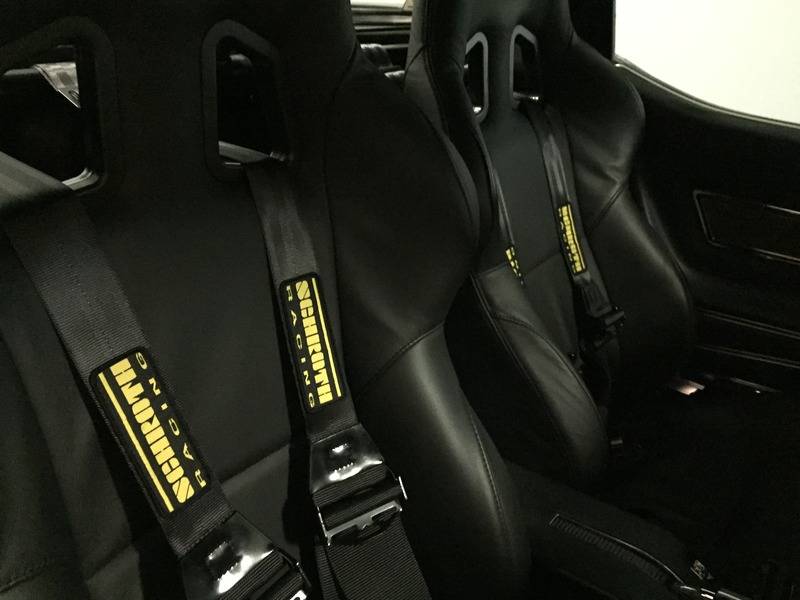

      Harnesses were swapped to a Schroth as tracking the car began to intensify

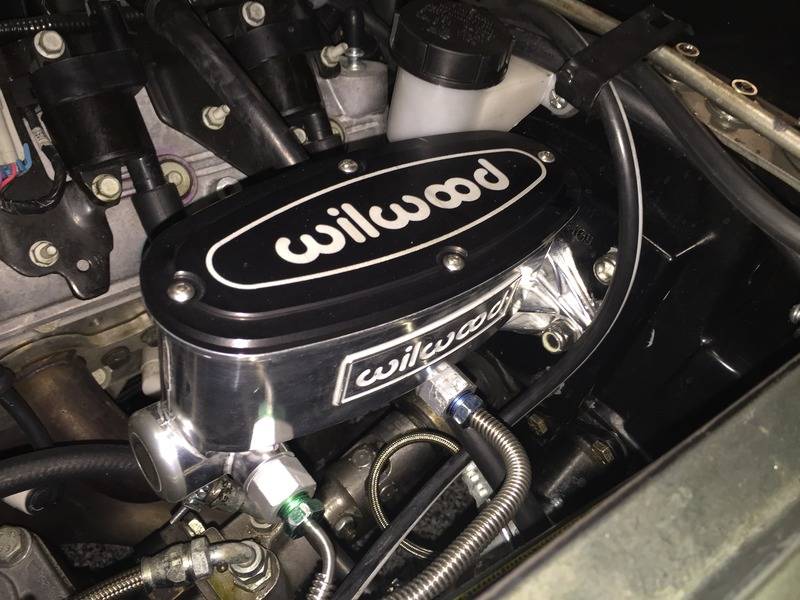

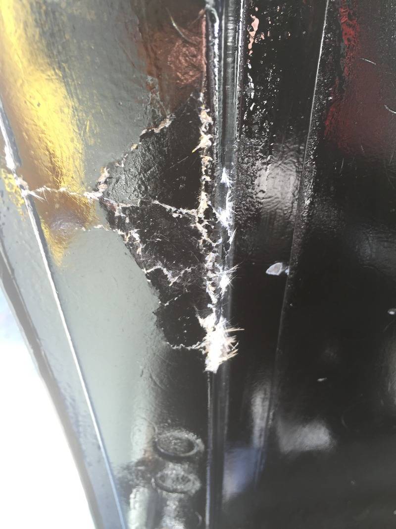

      It shattered the reinforced area of the hood
      That resulted in a manual brake master cylinder swap!!

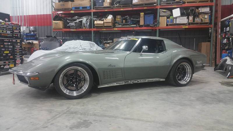

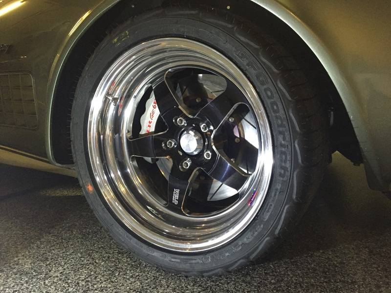

      The next round of upgrades were wheels and tires, allowing me to run BFG Rivals in an attempt (dream really) of keeping up with some of these faster guys!
      Back to the track for some more abuse!
      Even went so far as toting the car all the way to Austin, TX from Atlanta to run it at COTA with a friend!

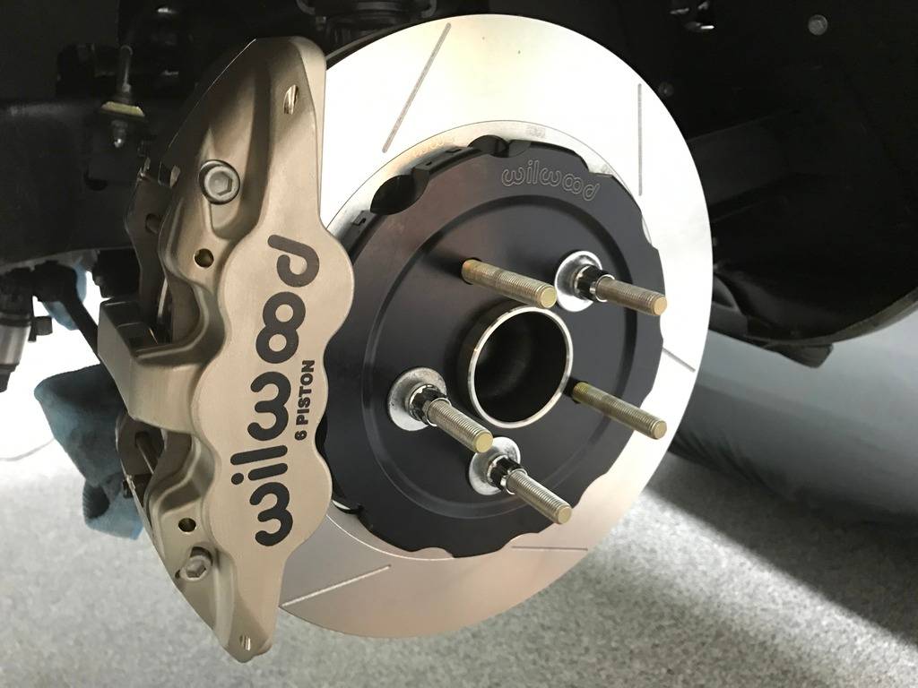

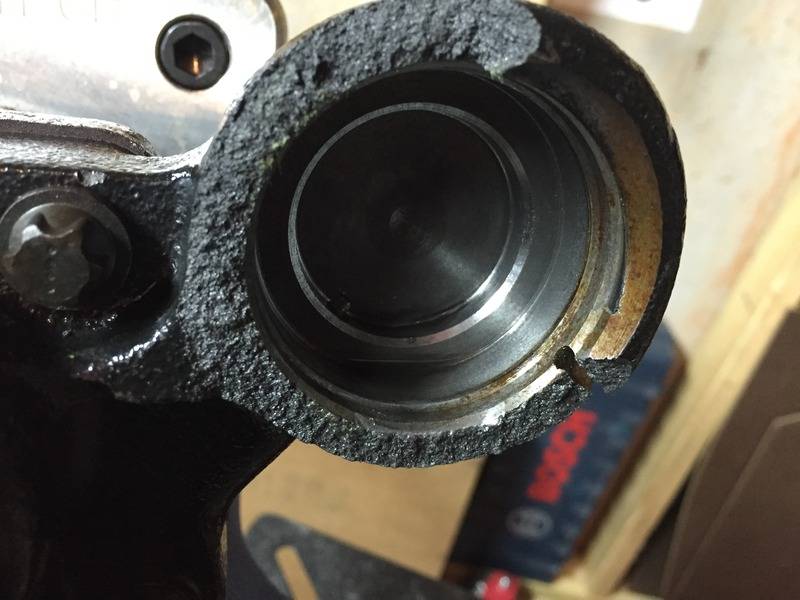

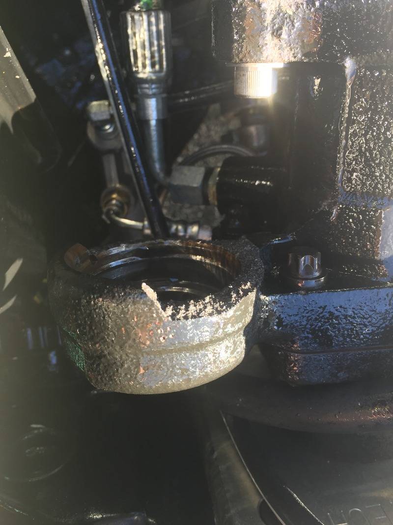

      The car, up to this point, had been suffering from a really, REALLY bad caliper piston knockback issue. Every single turn I would approach (on the race track or autocross course) would require me to pump the brake pedal 2-4 times to get the pistons to seat.
      This is more video from COTA, chasing my friend's Z06 and ultimately spinning because I did not pump the pedal enough and the brake bias was terrible entering the corner.
      http://www.youtube.com/watch?v=NkGXzIUogok&t=7s
      I measured, I mic'd, I photo'd, rebuilt parts, replaced hardware.....did everything I could trying to find the problem. The ultimate solution, albeit not the ideal situation, throw more money at the car. Through my ridetech contact, I was able to get my hands on a Wilwood kit with the good parts, thermloc pistons, spec 37 rotors, etc. Ta-da, that fixed everything. My honest opinion is that the Baer system desperately needs knockback springs but they refused to acknowledge that fact.

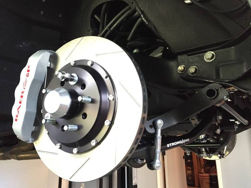

      So that brings me mostly current/up-to-date. But I'm not done.... The car just went though an entirely new round of upgrades. The front suspension was swapped again with Speedtech Extreme spindles, improving the geometry and replacing the front wheel bearings with C7 hubs.

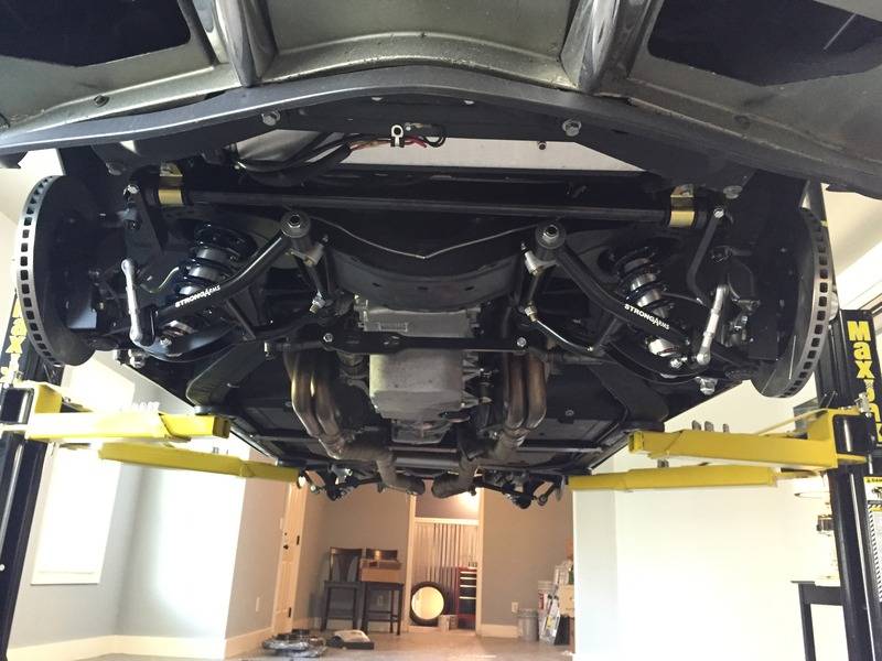

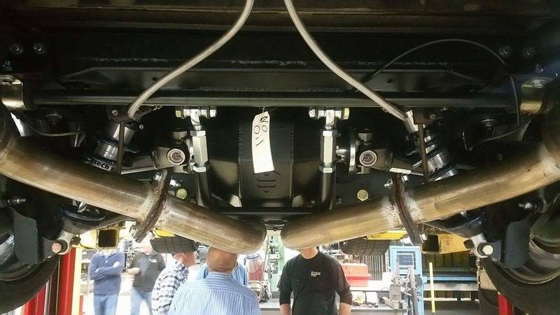

      Just recently my car received one of the very first "production" Track1 rear suspension upgrades which basically replaces the rear running gear with a Currie IRS 9", upgraded axles and revised housing mount. This dramatically improves the rollcenter, adding strength and durability to an otherwise ticking time bomb in a C3!.
      So that should pretty much do it right? Unfortunately not. I couldn't have their newest suspension without also having their newest shocks too! They just released the Instinct electronic shocks by DSC Sport. I have the ridetech Magentuner in my 2016 Z06 and that thing is money! Unfortunately I don't yet have these shocks installed as a few pieces are still in manufacturing but should have everything completed in the next month or two.

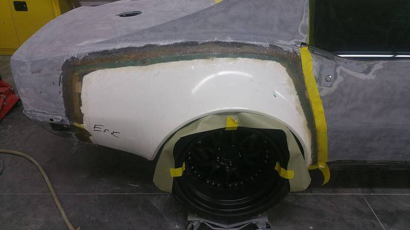

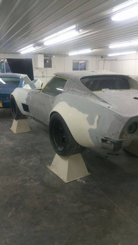

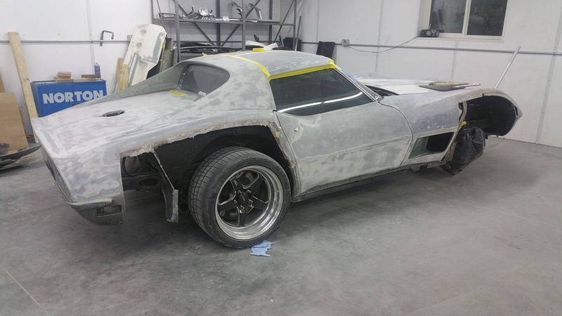

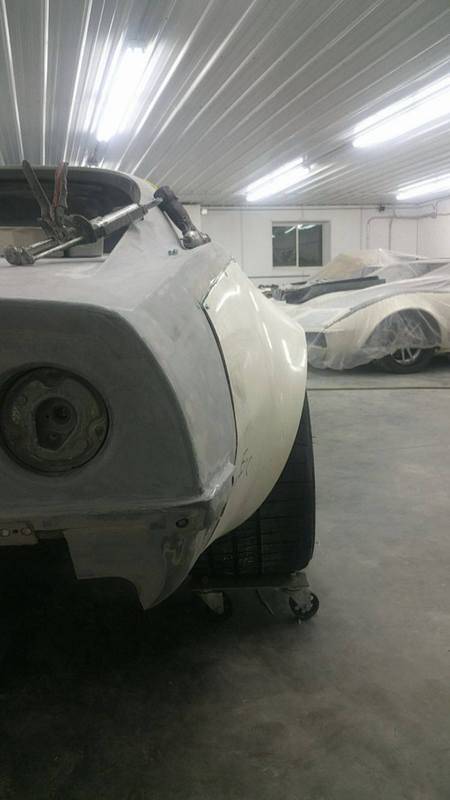

      So while I wait.... decided it was as good a time as any to send the car to body shop jail. I enlisted the help of Josh at Custom Image Corvettes to perform the dirty work.
      As delivered

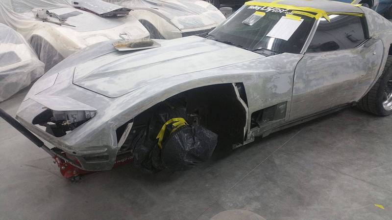

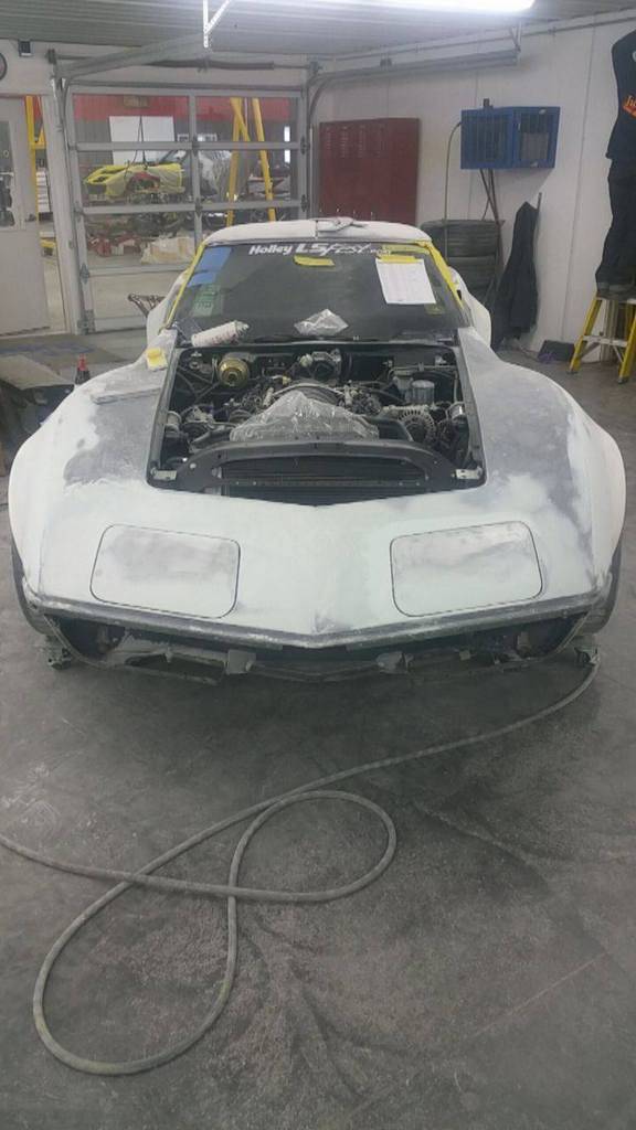

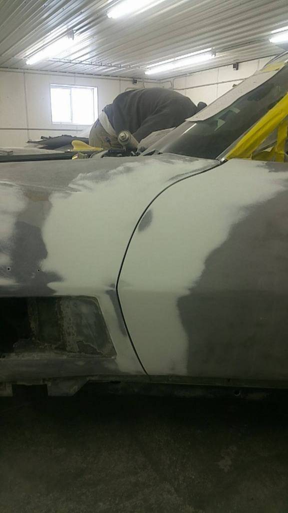

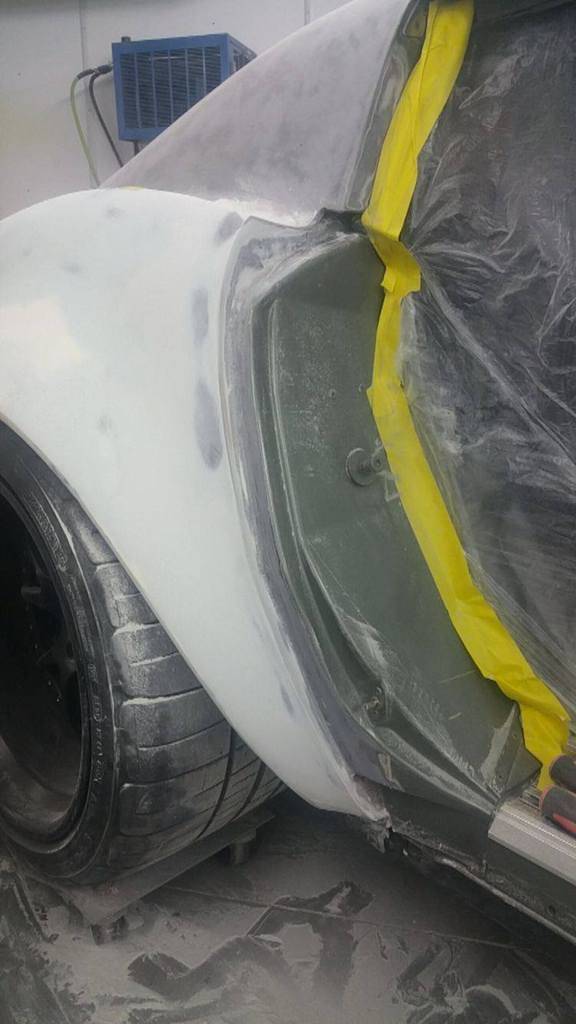

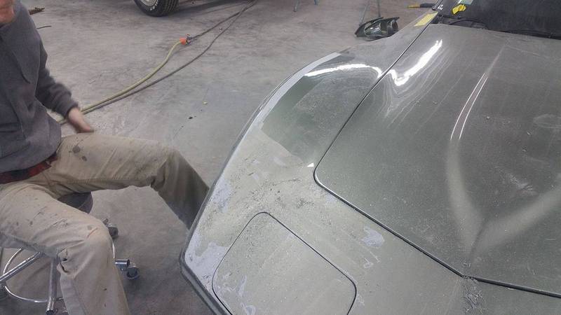

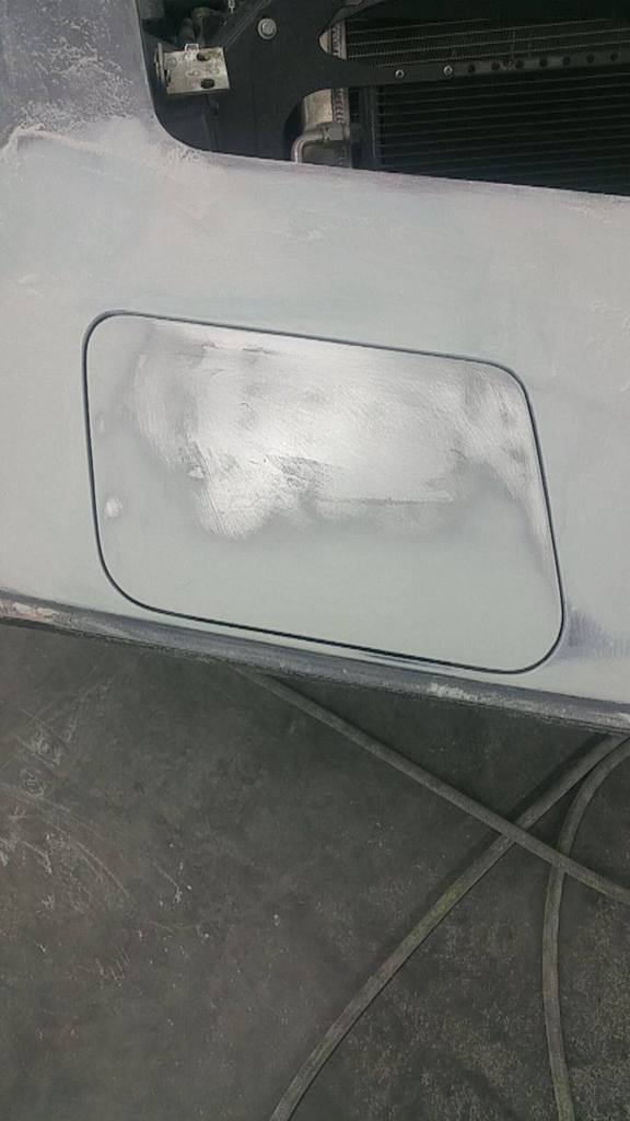

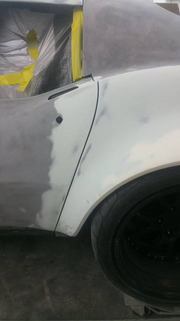

      Not quite as awe-inspiring as the rendering, but the progress continues on the 71. Body gaps are shaping up. I can only imagine how dusty the entire car is right now....
      Jan 2014
      54

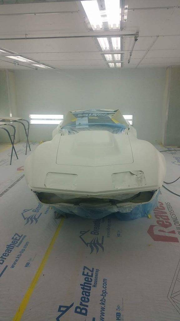

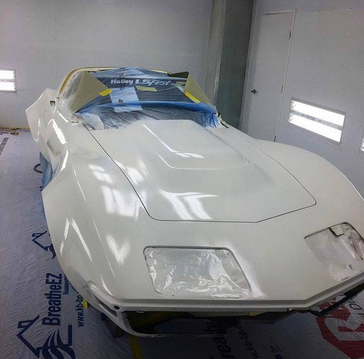

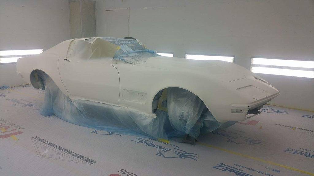

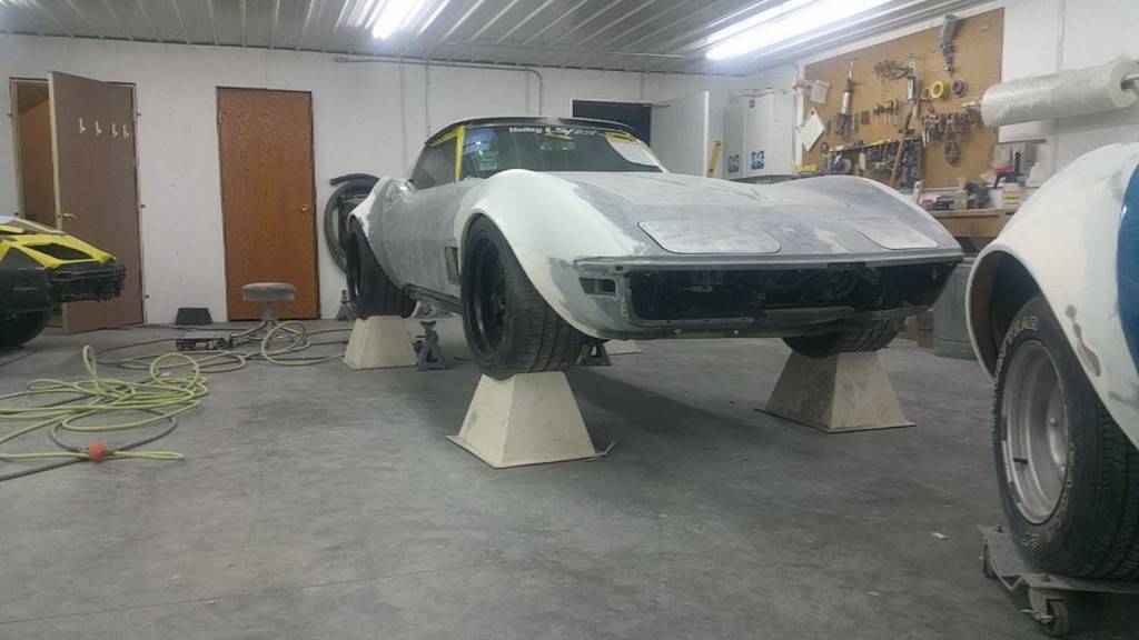

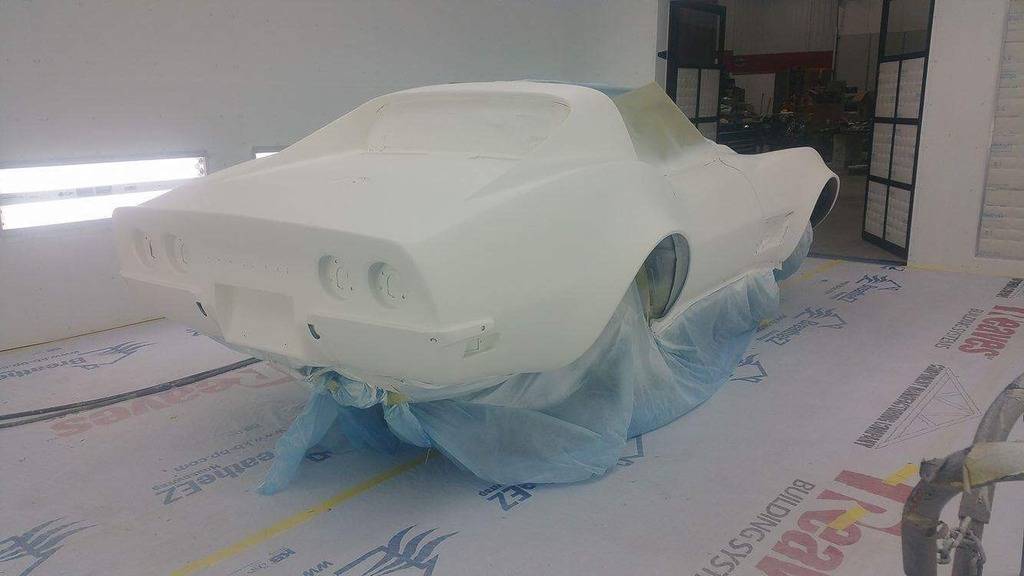

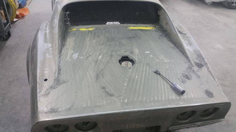

      The car is finally a single color again, even if just gel coat!
      I guess this was the first Corvette to go through the new booth at CIC. The flares and body lines are lost on the white but it is going to look amazing when that first drop of Indigo Ink goes down!

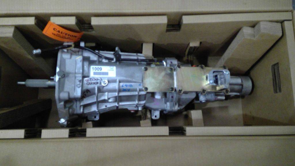

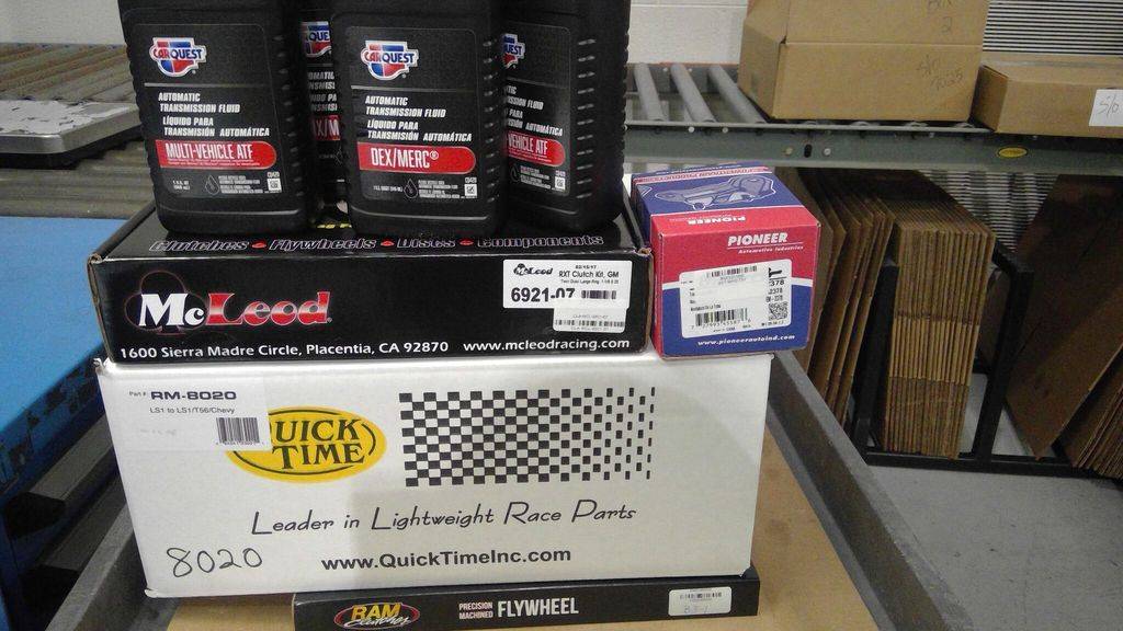

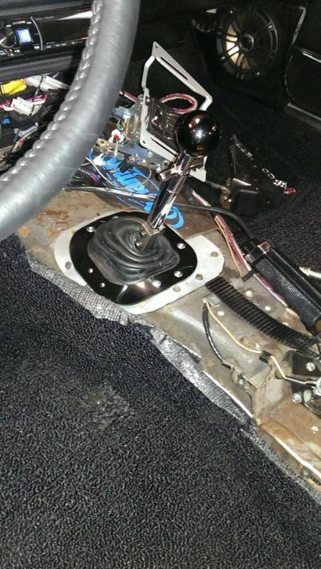

      Another "upgrade" from the good guys at Silver Sport Transmissions. Replacing the TKO600 for a T56
