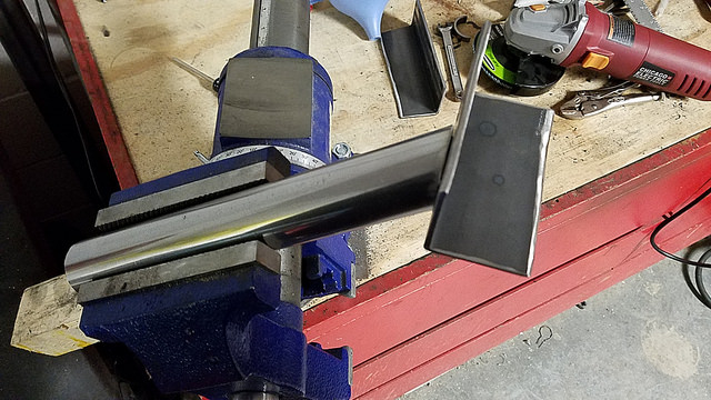

      Got a few updates,
      Been working on building a panhard bar and 3-link for the rear. Current I have the rear out and working on removing the upper control arm brackets.
      Here is the Panhard bar
      Frame mount
      Trying to get the right angle lol
      Here is the mount attached to the rear
      Found out the hard way, that the rear end tubes are not 3in in dia. So I made some shims to fit the 3in clamps I ordered.
