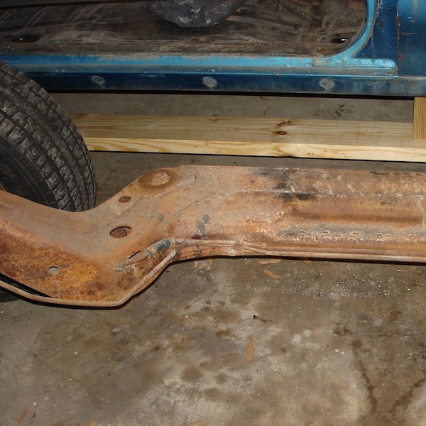

      Downl50:
      Some '70 A-body cars have a 2-piece fuel line the connects with a short section of rubber hose at the passenger side body mount (see pics). This section of hose should at the very least be upgraded to a barrier-type hose, or replaced with braided or something that can handle the ~60psi pressure from an EFI fuel pump. To minimize connections (i.e. possible leak points) I'm planning to use a compression fitting at this point and run -6AN brained line through the frame rail all the way to the throttle body.
