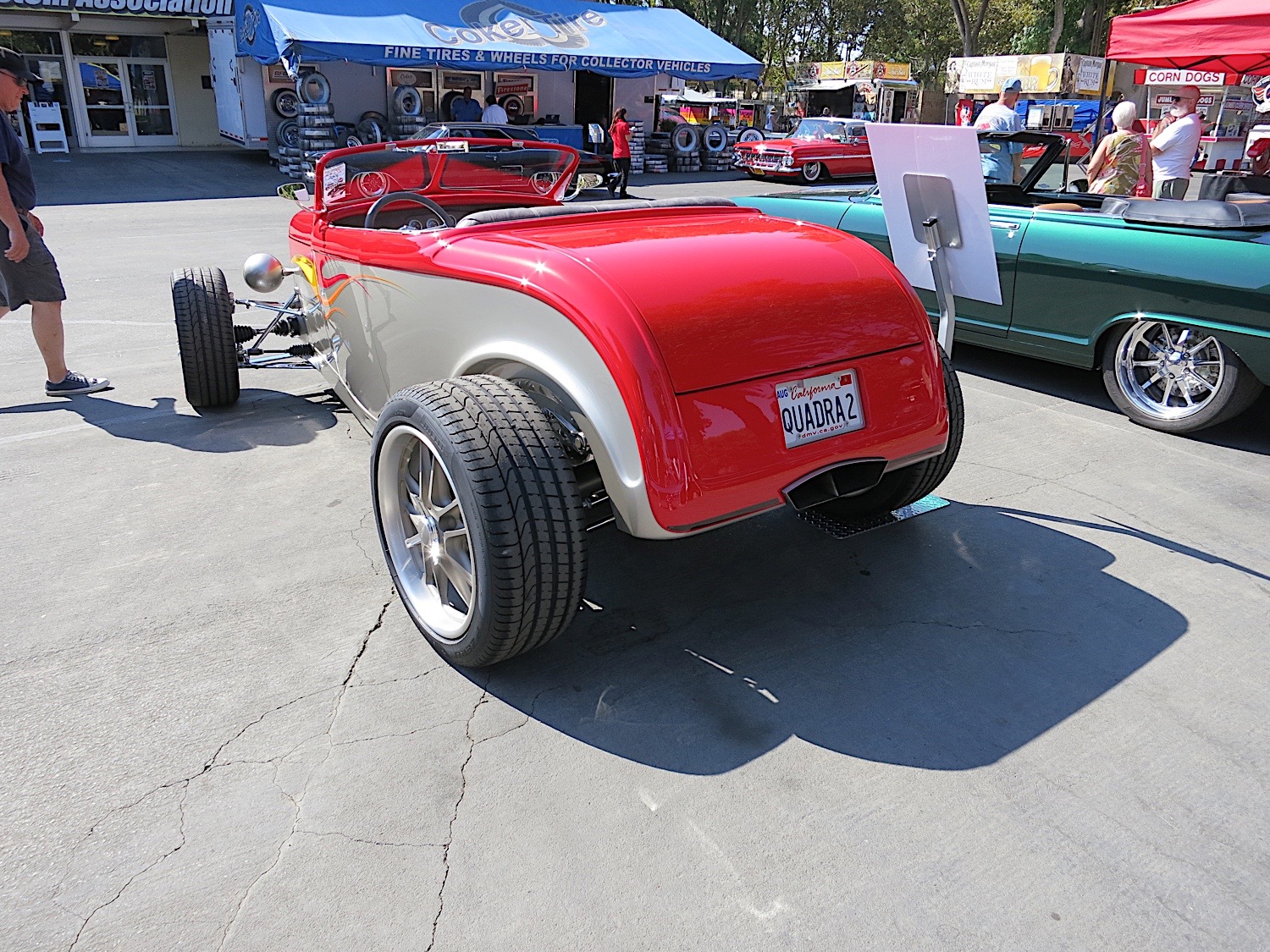

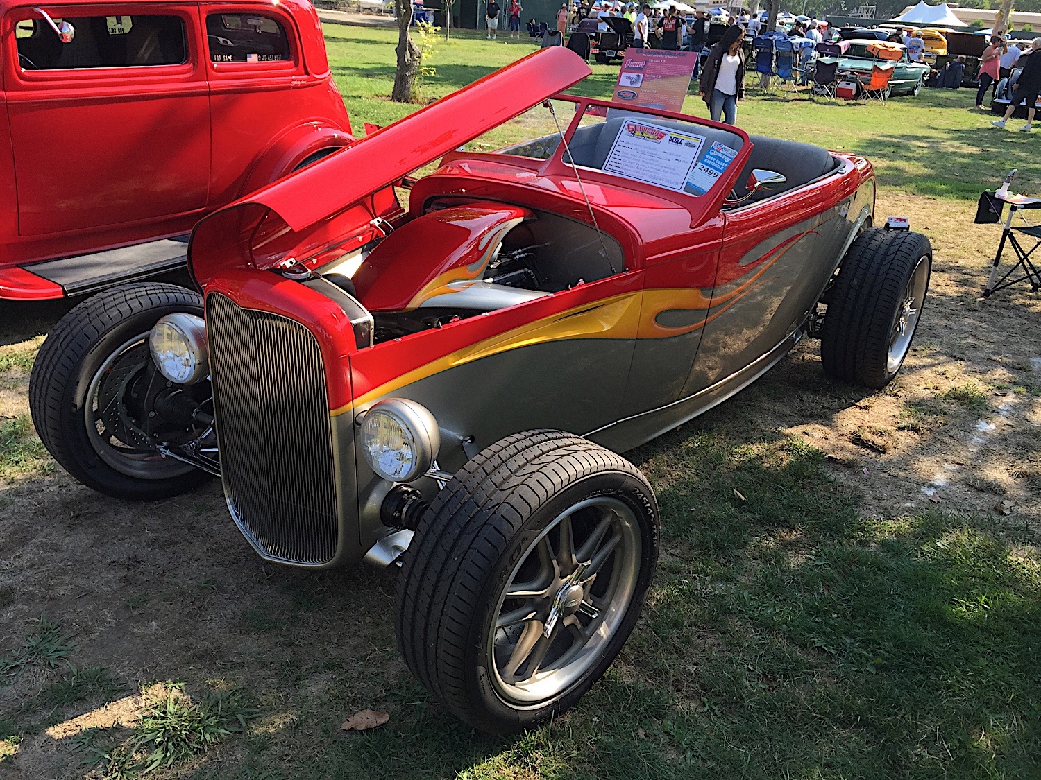

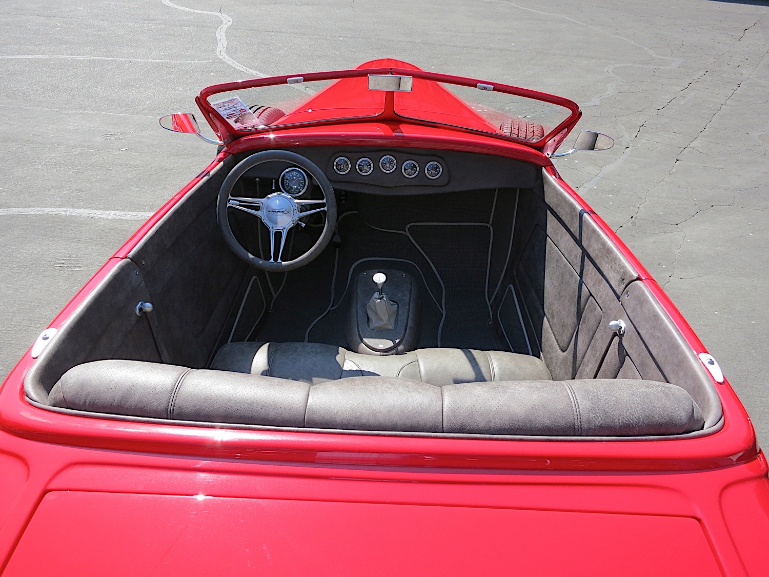

      And here are some recent pictures from its recent outing at the August 2016 Good-Guys in Pleasanton.
