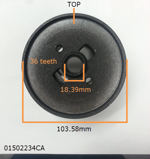

      Decided to shift gears a little bit and would like to go with a Sparco wheel. Sparco has informed me that they do not have a hub that could work with my Nova, even though they have a hub part number listed in their accessories as, "STRWL HUB CHEVY 68>82". I asked if that one would fit a first gen F-body, assuming the steering columns between my '70 Nova and a '68-'69 Nova are identical, and they didn't know. (Which I thought was odd.)
      Does anyone know if the Sparco hub will work with my Nova steering column? Far fetched question, will the Grant hub work with the Sparco wheel, or no because the Sparco wheel is a 6 bolt vs. Grant 5 bolt?

      My best guess would be that the part you listed 68-82 would work. Momo has one hub that works for 69-82, I'm pretty sure Sparco is similar. I would buy the Sparco HUB

      Here are the two Sparco hubs...

      The first one is supposedly for "Chevy Car". Would someone please confirm that's the correct one for my Nova column?

      Here's the Sparco hub info...
      Steering Wheel Hub Adapter: STRWL HUB CHEVY 69>82
      Part #: 01502234CA
      Good luck!
