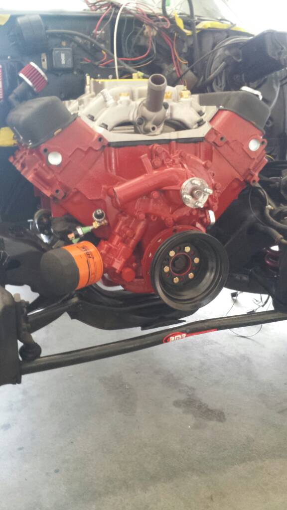

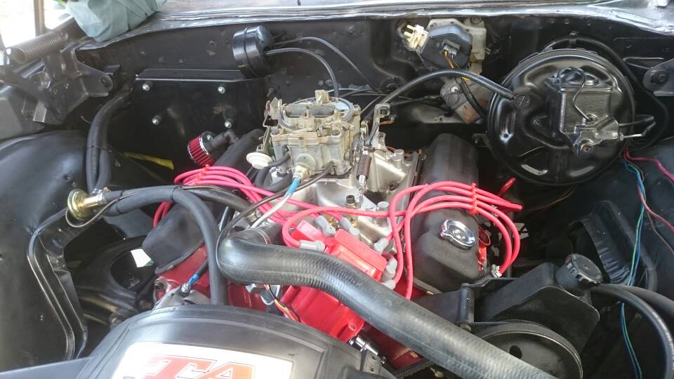

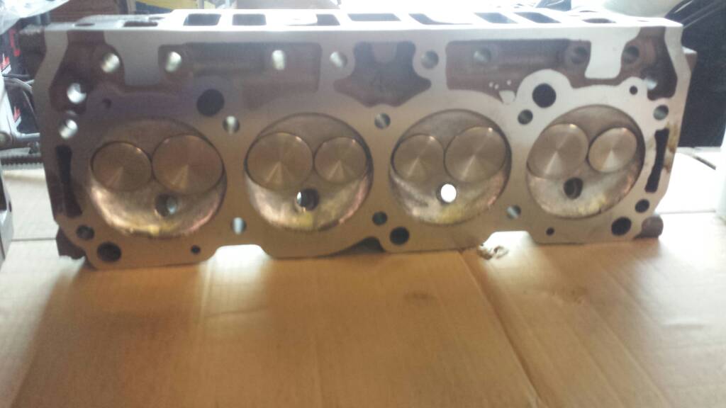

      further i decided to rebuild the buick 350 motor and beefed it up with buick performance parts and a lot of work
      so i ended up with a 9:21 compression very good running motor..
      (single plane intake, ported heads with bigger valves and springs , race adjusted Quadrajet, hooker headers, 3" x-pipe, custom performance cam etc) before i dropped it back in i fixed the frame rails that where bent.

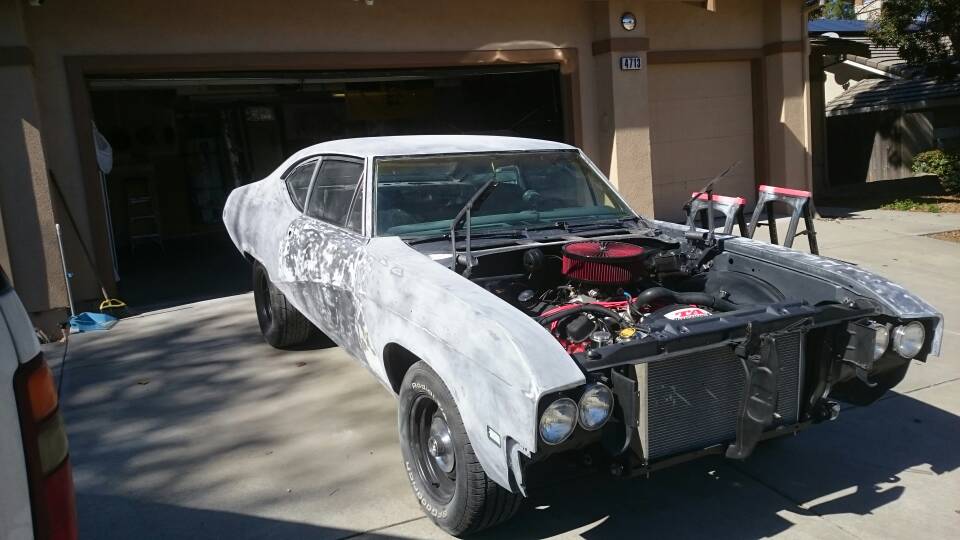

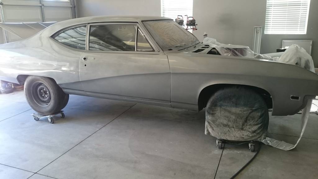

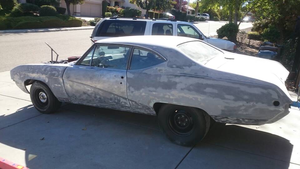

      1st of all i stripped the car again since the cheapo Paintjob lifted an was totally BS..thats what i get for beeing cheap!!!
      So i prepped the car for REAL PAINT

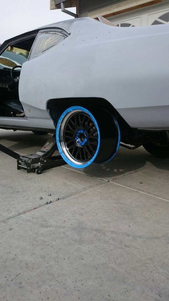

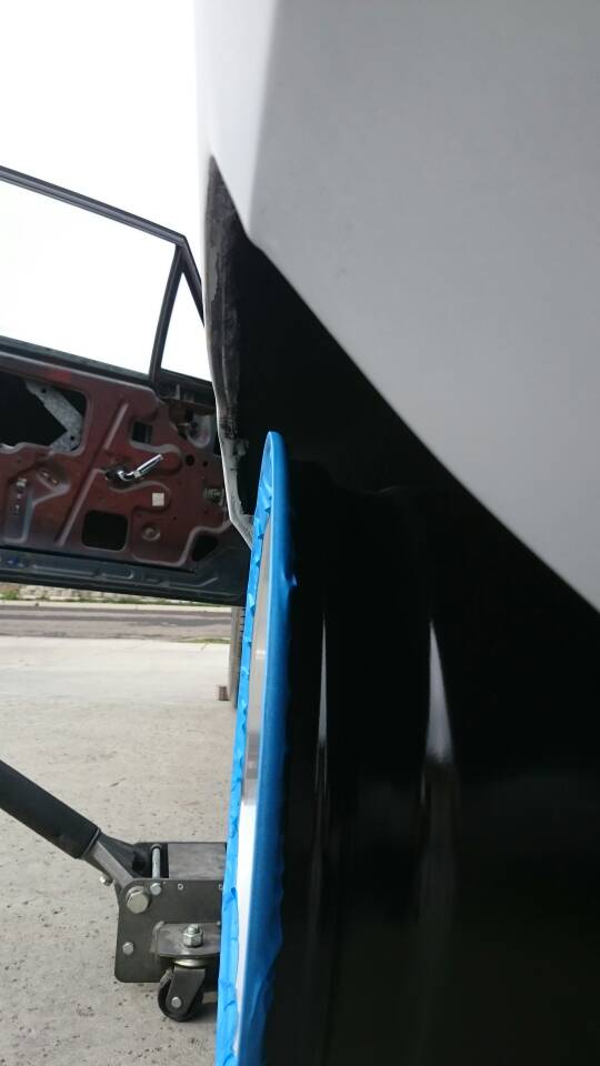

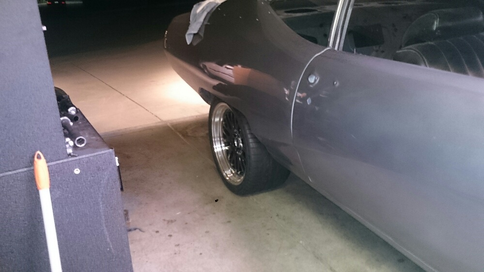

      i am planing on running 19x10 ET 15 wheels that equal a BS of 6.09.. in the BACK
      Not to easy on the 68-69 A bodies.. and especially not easy on the Buicks with there straight quarter panel lip..

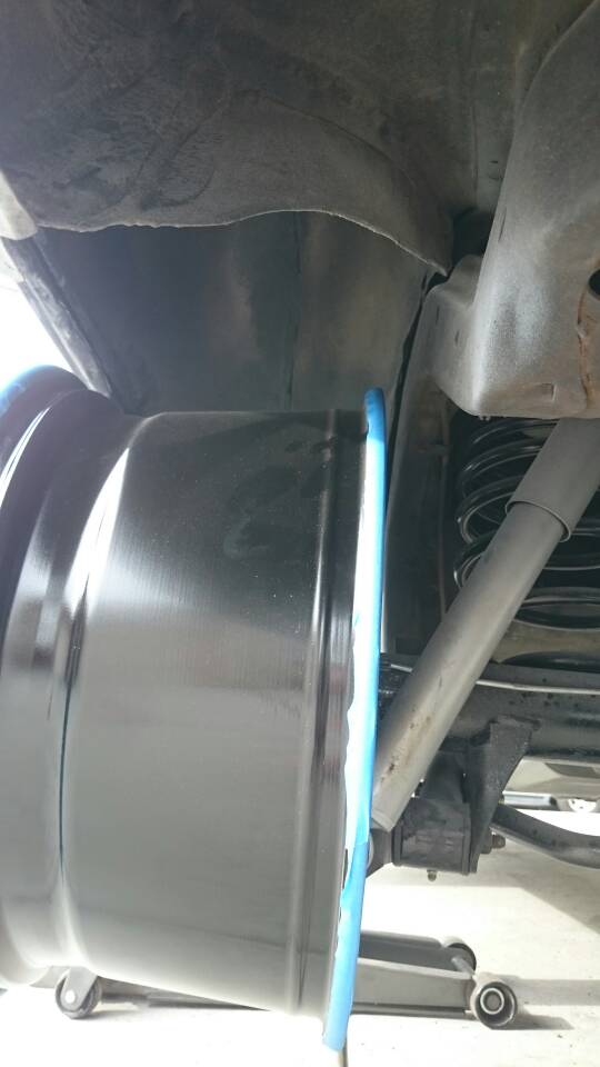

      had to cut , grind and rol the inner fenders to create space..
      .im pretty lucky that they fit... just need longer studs
      now will be the tire question.. i thought about 305/30/19 but i think they will bulge to much .. i dont have the necessary space on the outter lip (maybe 0.5 inch)

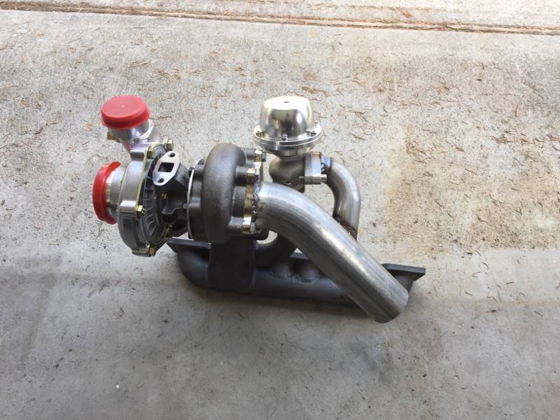

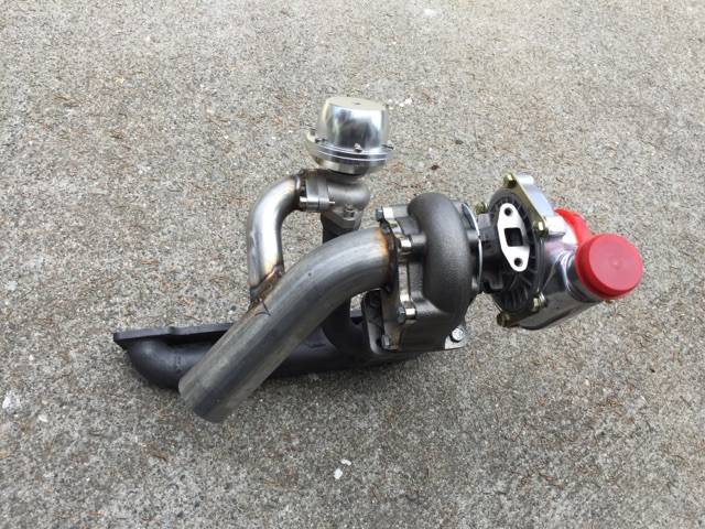

      so i decided to twin turbo my beefed up Buick 350, and i got some turbo manifolds from MARK BURTON , i decided to keep it simpel with some T4 60 trim turbos, they spool fast , create more than enough power and they are reliable.
      i plan on 8 psi daily and 14-16 top end

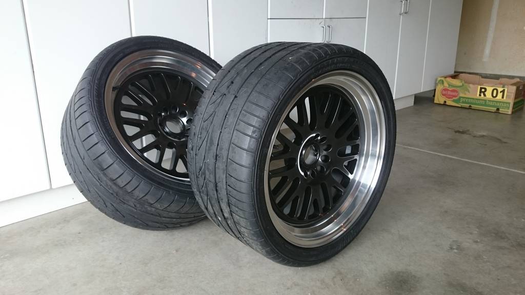

      Nice to see another Buick! I am surprised you can get that wide a rear wheel in there. What brand of wheel is that? Keep up the good work.

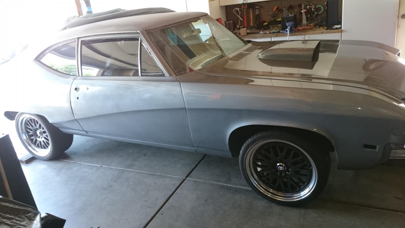

      this are CCW style wheels from XXR

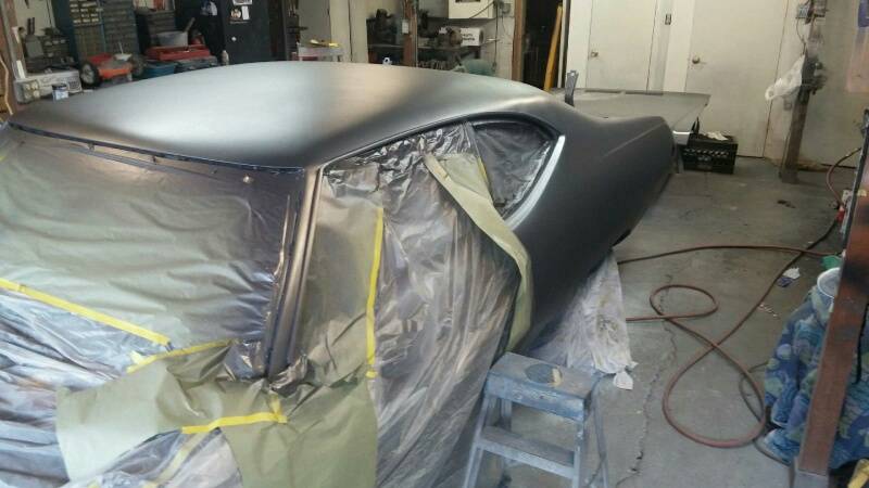

      Soooo 1st of all the car is back from paint after 4 month ..
      the next step will be the vinyl top and interior.

      wheels are XXR 531 they are a knockoff CCW style 19x10 with 6 Bs in the rear with 295/30 Bridgestone , 19x 8.5 in the Front with 255/35 ContiSports
      the rears are on already and they fit well without spacers/adapters. Only think needed where longer Studs (1-3/4) and Tuner Lug nuts for the wheels.
      the car still has some Spring spacers in the back (2") on top of the Coil springs, i ll wait until the car is fully assembled with the interior, bumpers etc that will add some more weight and make it squad down even more before i possibly remove them.
      i wanna see the stance 1st. and i would like to have the car pretty leveled.
      The Front assembly is based on OEM setup with BMR 2" lowering springs but i kept the horseshoes since there is nothing wrong with it.
      the wheel fitment will require 1.5" adapters.

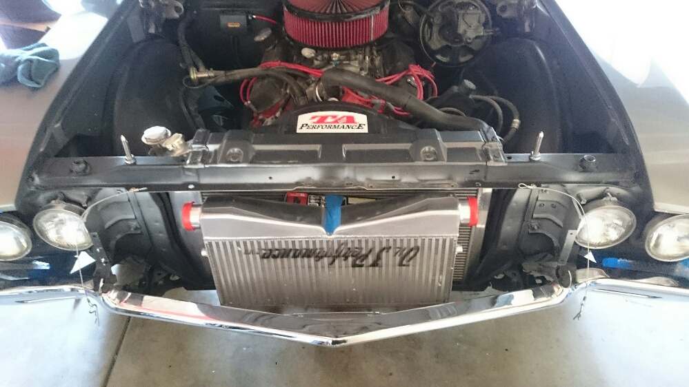

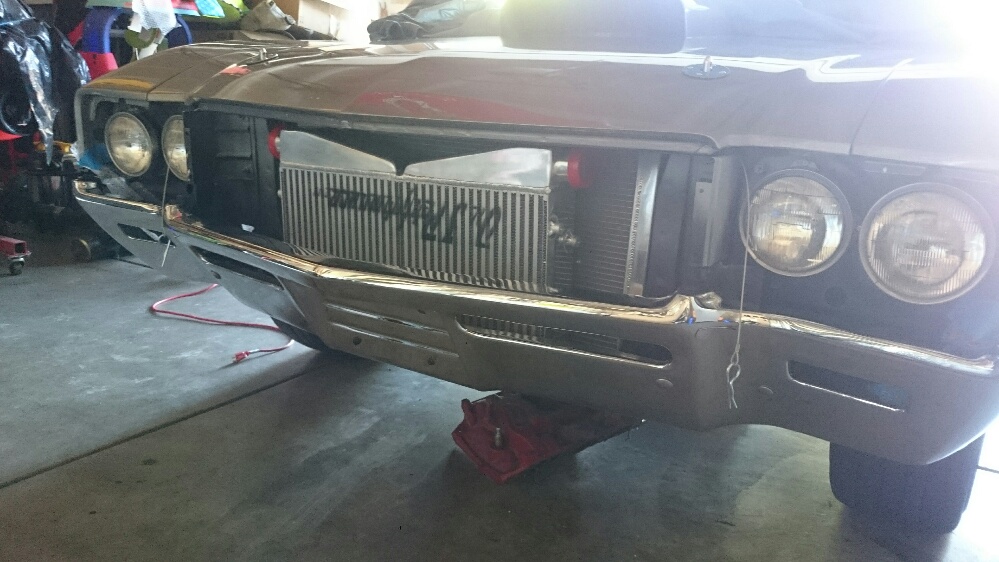

      I took off the hood latch bracket and installed hood pins to gain enough space for the IC.
      Mock up looks good i just need to build brackets and cut the lower bumper a bit to clear the piping and BOVs.
