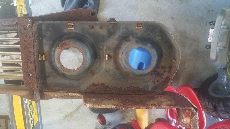

      Just looking through some stuff. Does anyone make repo vertical grill support brackets or the upper grille filler? I see the upper grille filler is available for the 67, but can't find one for the 66. Or am I going to have to start searching for some used ones. I know a bunch of stuff is reproduced, but I have a feeling a bunch isn't also.
      Anyone know about this. I also found this front part for $100. Not sure if its worth it or not. I do not have any of the piece in the picture. I feel it should clean up decent, but then again, maybe not.

      Looks pretty rusty. If the parts are hard to find you could have it sand blasted and spray a lot of high build primer to fill the small pits.

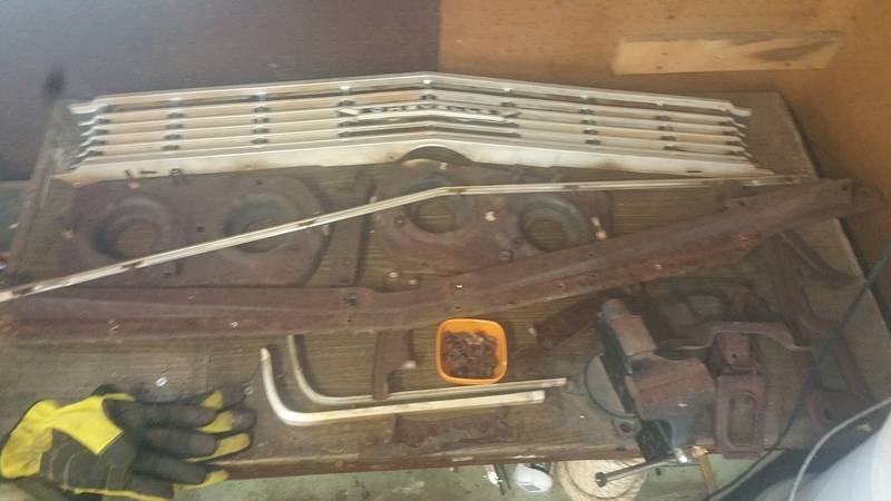

      Alright been doing electrolysis, evaporust, and vinegar baths on all of these parts. They have cleaned up nice so far. I was planning on replacing the bottom bumper to grille filler, but have decided against that since I bought a welder. I plan on just patching the areas that are needed on it. I used a hammer and dollie for the first time to clean up the edges and take out the dents and bring the natural curve back on the sides. Top grille filler got some high build primer, sanded, and then some new black paint on it. The headlight bezels will be cleaned up more once I get the mig welder going. Need to replace a couple spots on the left side.
      Some before and after pictures.
