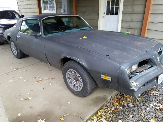

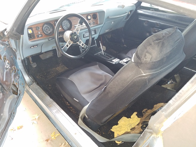

      here is how it arrived. The seller agreed on a price and drove it to my home. It is as rust free as he said.

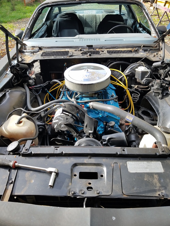

      I was quite surprised to open the hood and see this brand new engine and complete new flowmaster exhaust. he didn't even mention it in the ad! Got the whole car for the value of the engine. I pulled the broken windshield out because if there was any rust. that is where I'd find it. There's none! Also pulled the hood to put the shaker hood on. I was able to find all the t/a parts on a car being parted locally. Going to drive it on this powerplant until the body and suspension are sorted

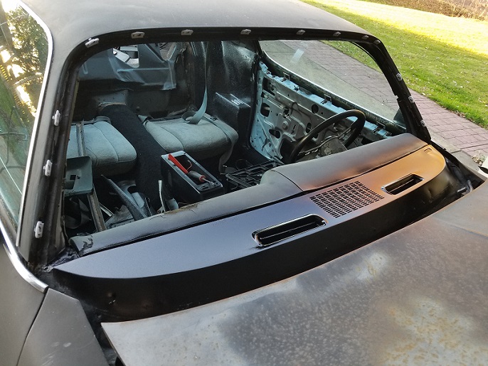

      having the windshield out was a good opportunity to paint the dash, No need for masking as the new dash pad is going on soon.

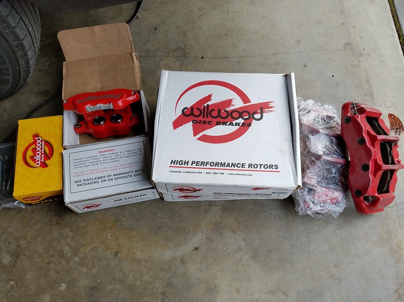

      Parts are being delivered nearly every day at the moment. Found the 12" rear brakes in the classifieds and the z06 calipers on Ebay, will be going down to kore3 this week for the front hubs and brackets.

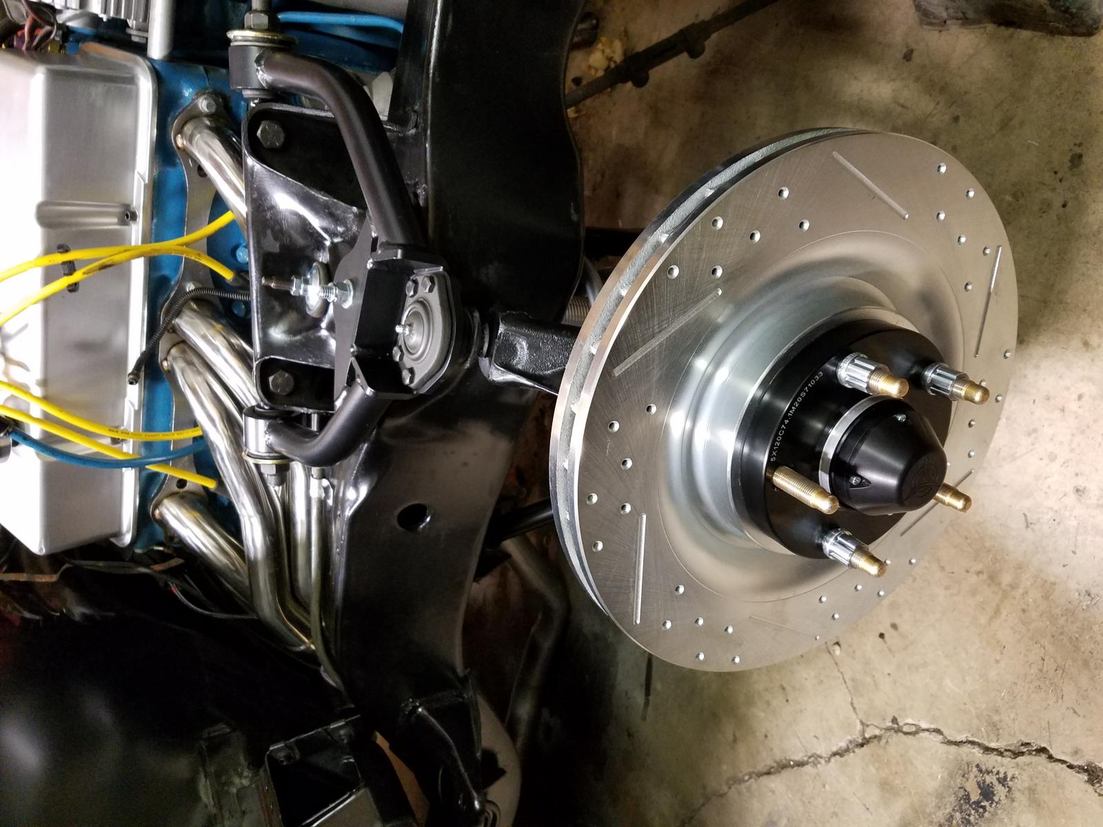

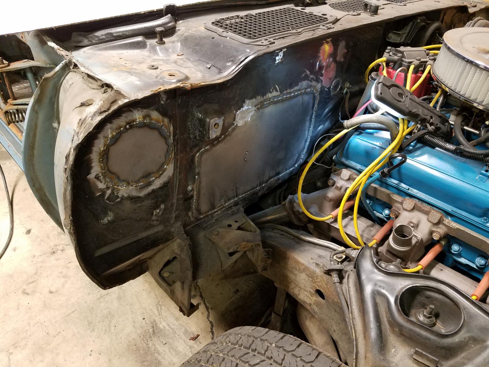

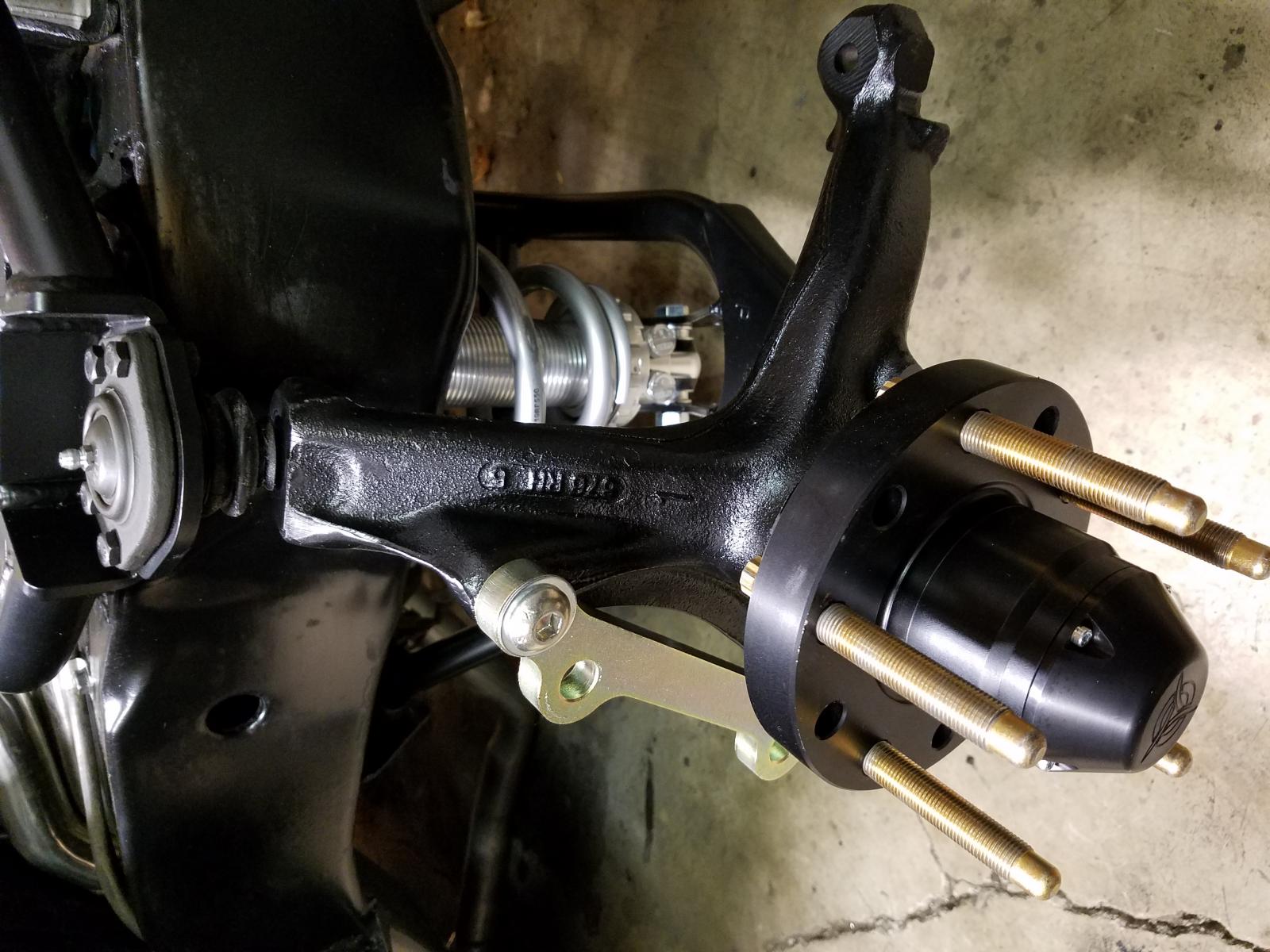

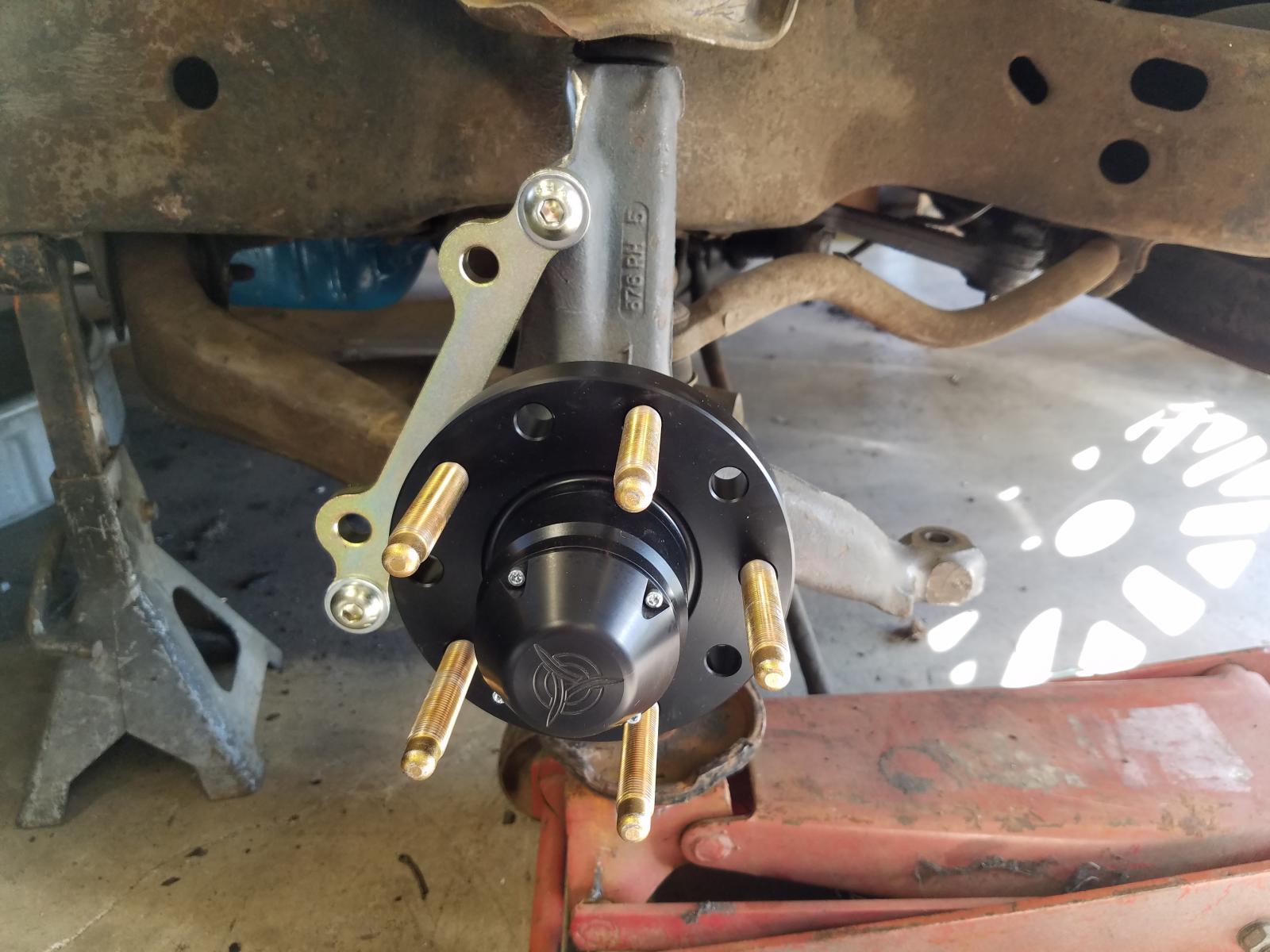

      I purchased another rust free shell for the front clip and had it media blasted. I did find some rust in the passenger floor due to a typical heater core failure. That was repaired with donor sheetmetal. Firewall got a shave and the Kore3 hubs have been fitted to 79-81 big bearing spindles.Name:  20171015_160130.jpg

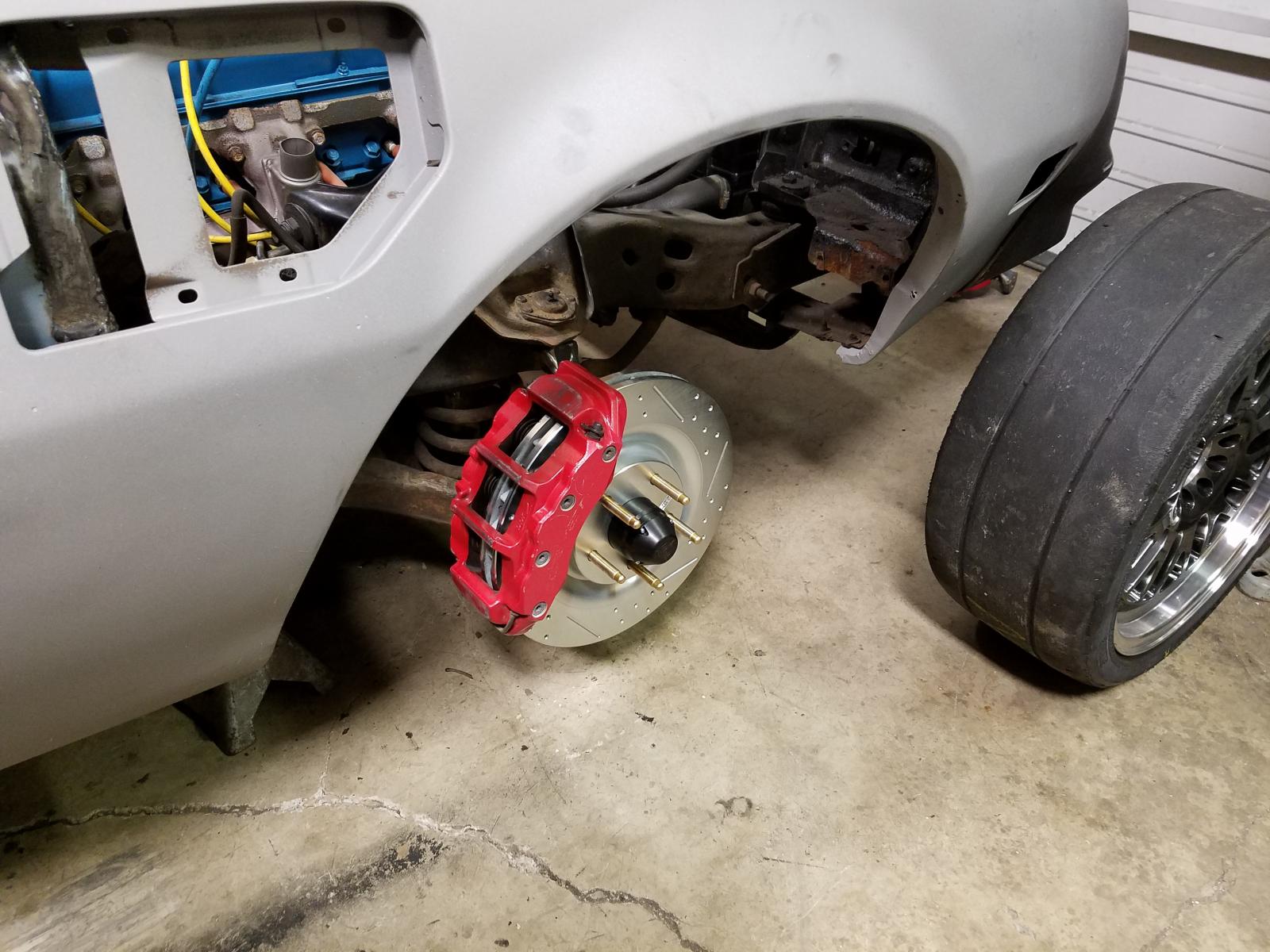

      First fitting of the z06 brakesName:  20171016_180948.jpg

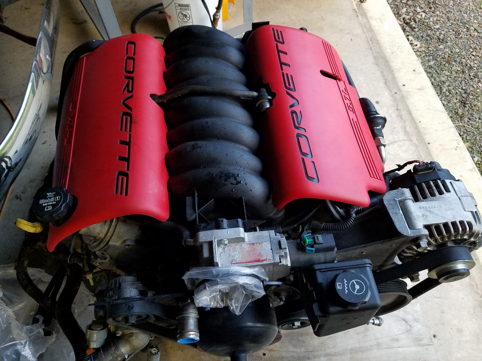

      The powerplant. Going to keep the rebuilt 350 in place while I sort the chassis.Name:  20161118_161550.jpg

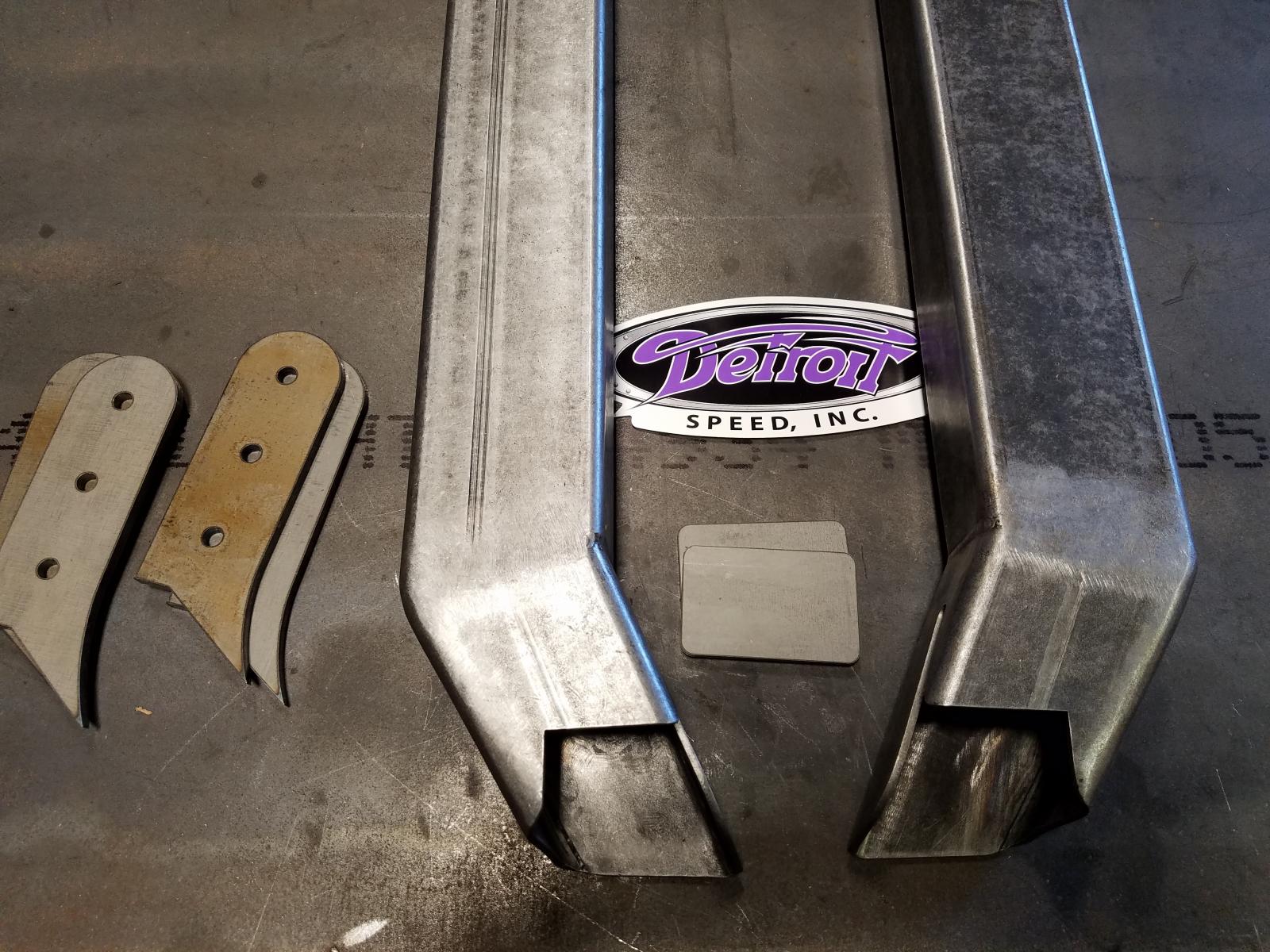

      Subframe connectors have arrived

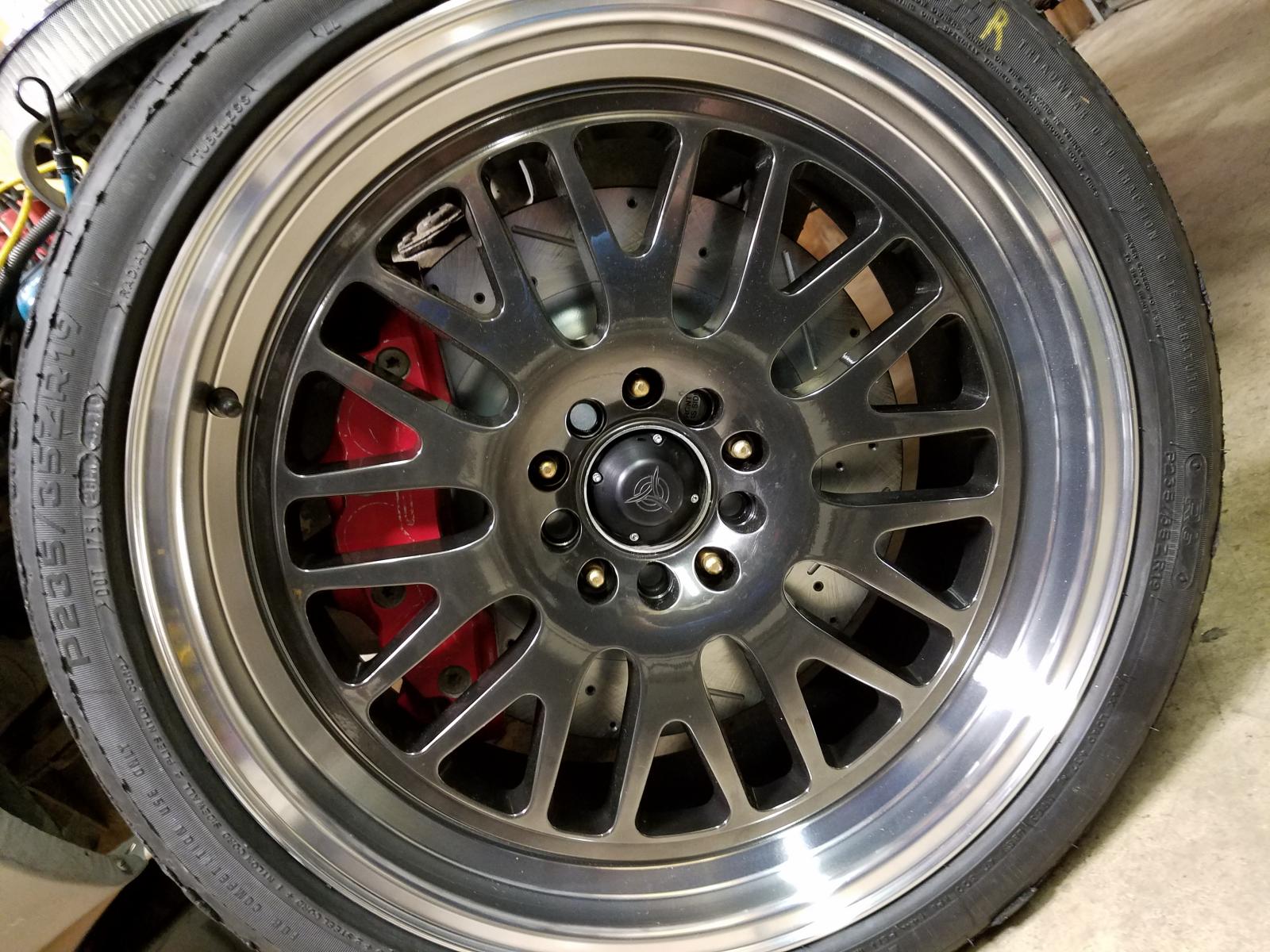

      I've been busy, too busy to post! Enjoy a few pics
