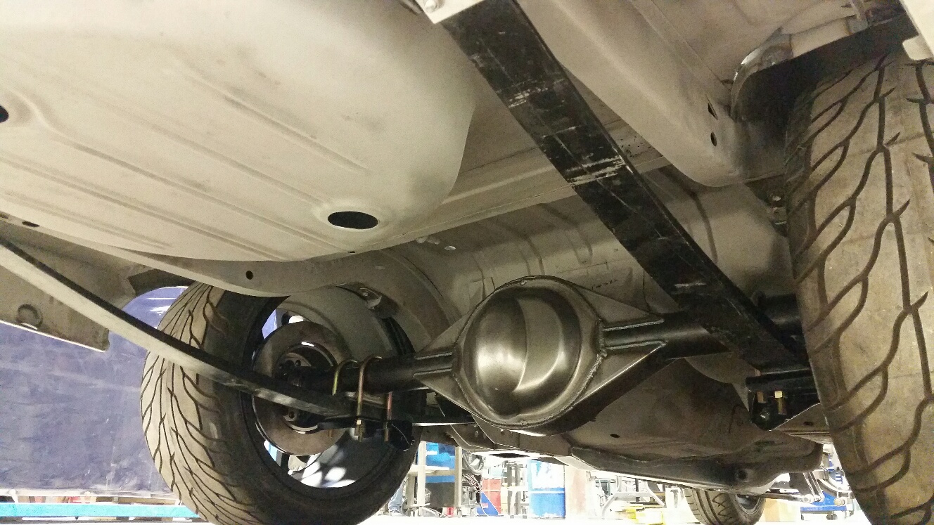

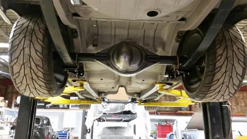

      A little about the car 1965 Dodge Dart. Some small body modifactions to clean up the ugly. Custom coil over front suspension, Flex form composite leaf springs to my specs. rear spring sliders. Ford 9 inch out back. Mini tubed.

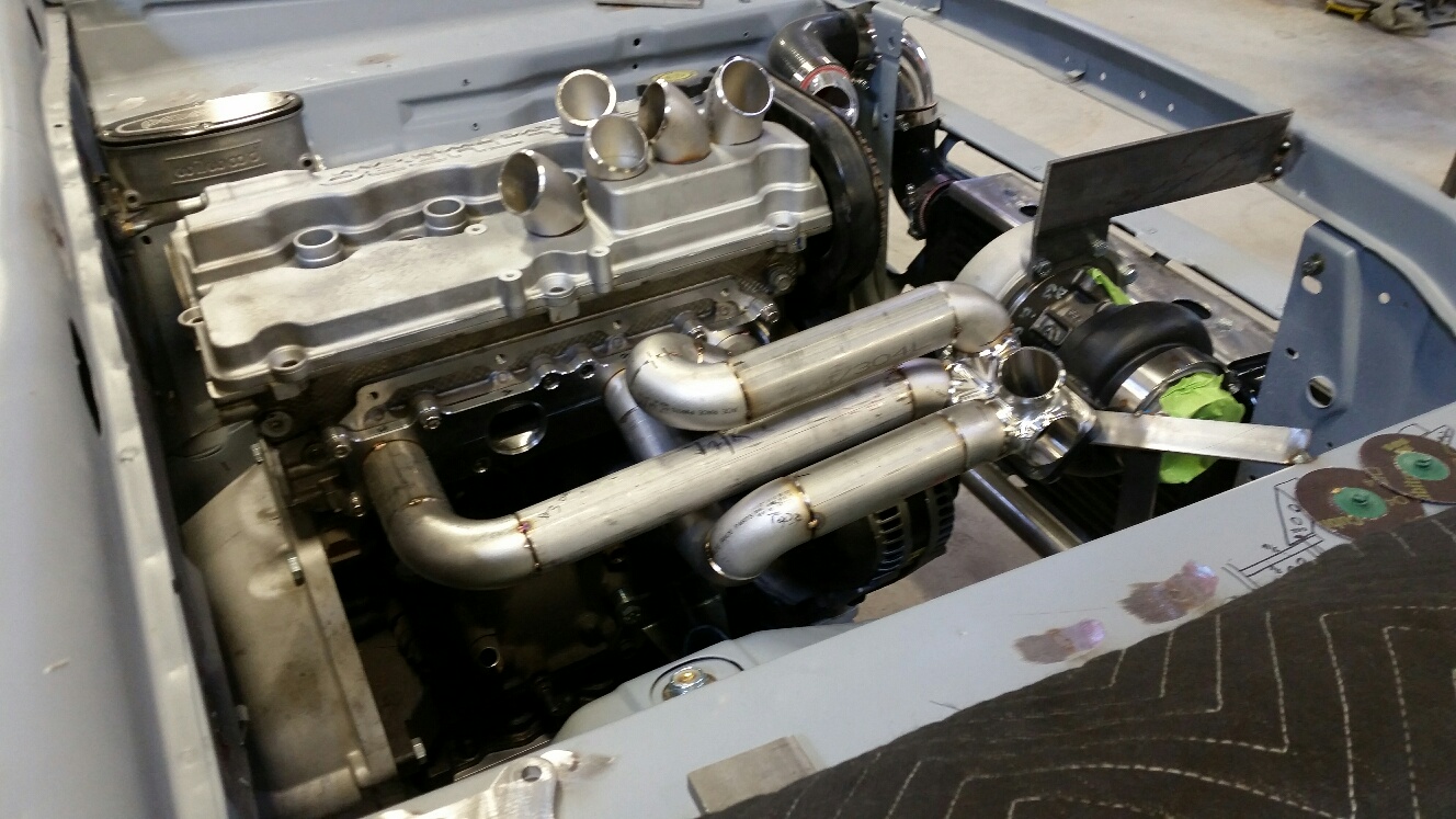

      Srt4 motor modified. Ported head. big turbo on a custom built twin scroll manifold.Estimated HP for this little motor right at 630 at the wheel. All built right here at Paradise Road Rod & Custom.This build is well on the way to completion. I will post actual pictures a little at a time.

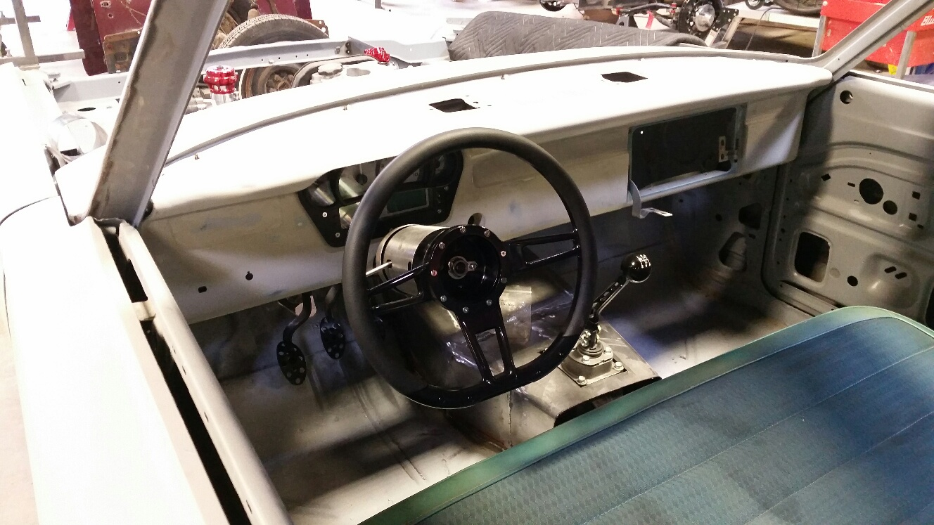

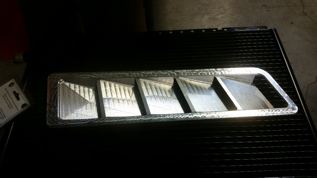

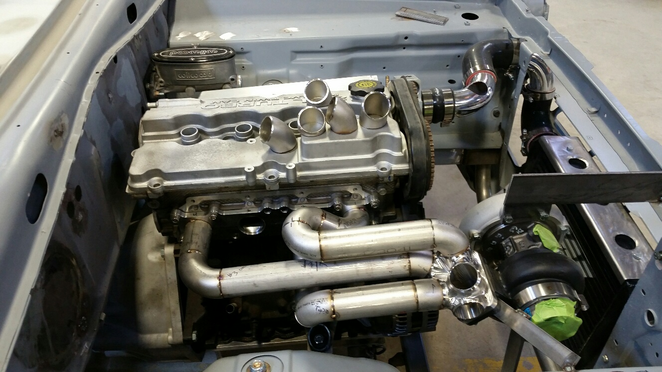

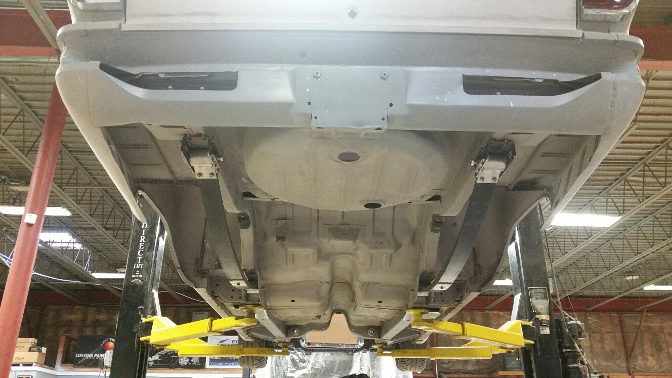

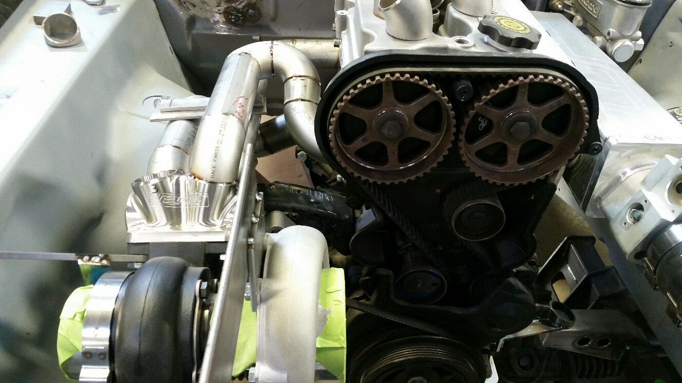

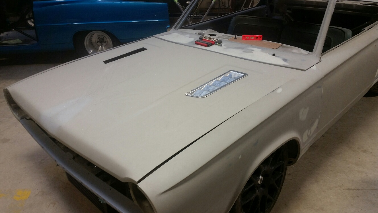

      Here are some pictures from the start of the Build.Name:  20151128_100144_resized.jpg
Size:  362.1 KBName:  20160321_174525_resized.jpg
Size:  252.1 KBName:  20160321_174514_resized.jpg
Size:  238.2 KBName:  20160321_174457_resized.jpg
Size:  251.1 KBName:  20160123_095614_resized (1).jpg
Size:  253.3 KBName:  20160409_141623_resized.jpg
Size:  357.9 KBName:  20151128_131402_resized.jpg
Size:  408.3 KBName:  20151128_121945_resized (1).jpg
Size:  30.4 KBName:  20151128_100152_resized.jpg
Size:  411.3 KBName:  20160409_141723_resized.jpg

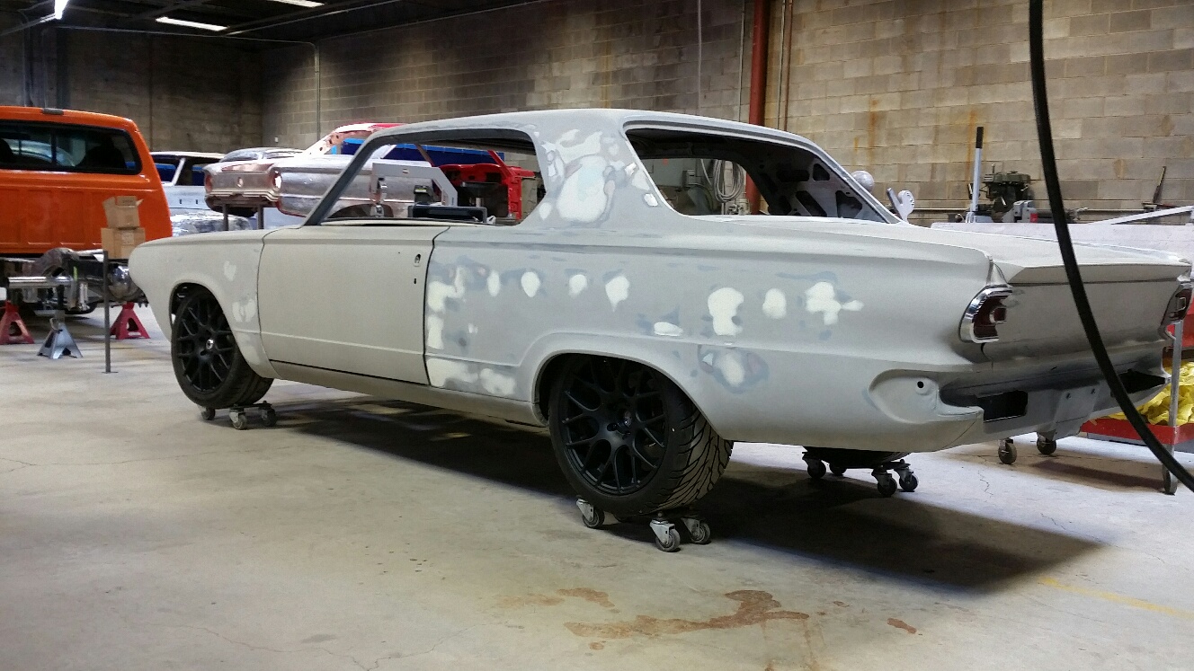

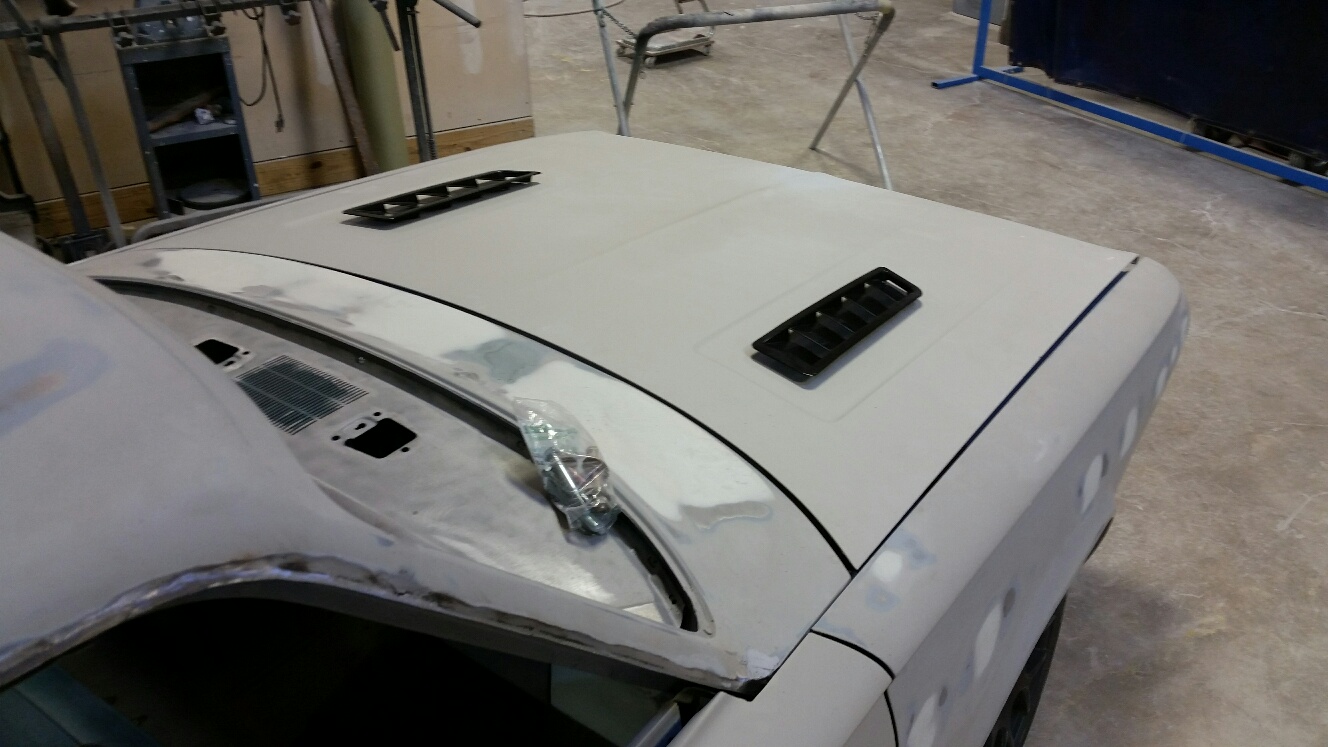

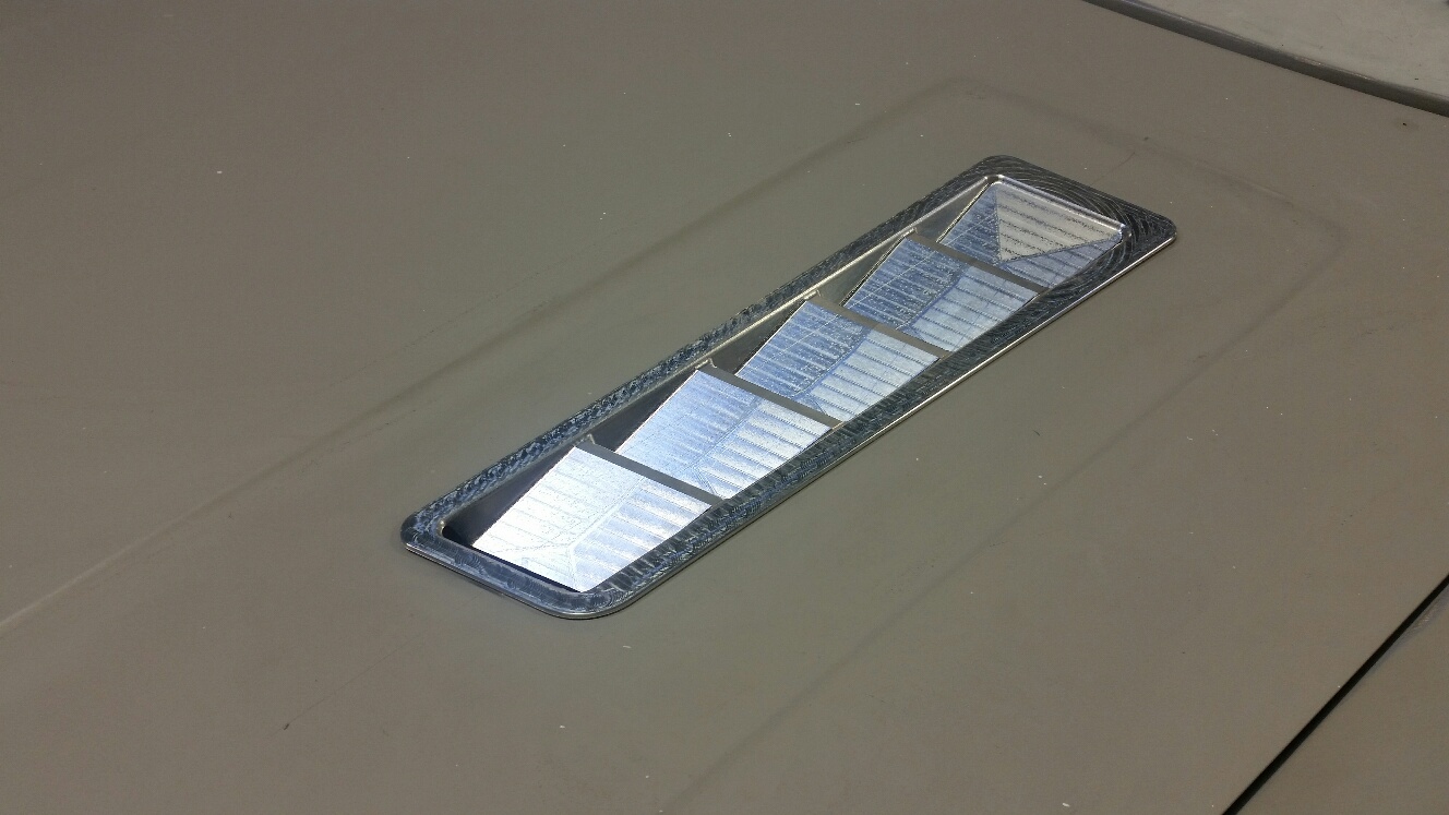

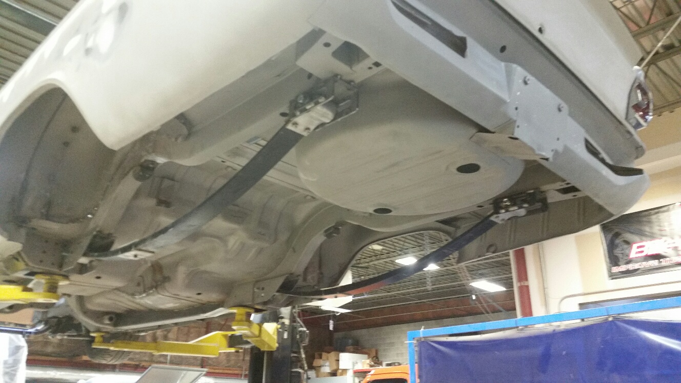

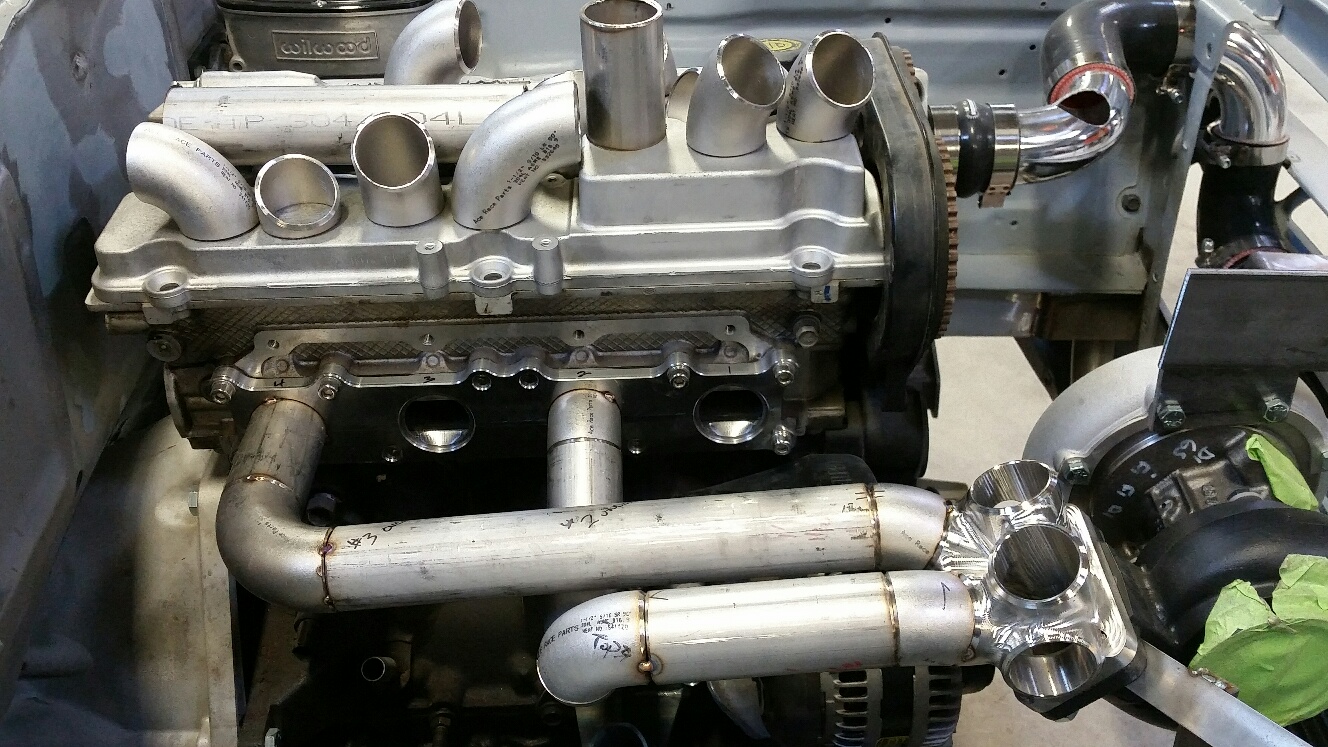

      a couple more for todayName:  20160416_111913_resized.jpg
Size:  345.5 KBName:  20160416_111919_resized.jpg
Size:  329.5 KBName:  20160416_122556_resized.jpg
Size:  323.7 KBName:  20160416_122601_resized.jpg
Size:  337.6 KBName:  IMG_5514_resized.jpg
Size:  24.2 KBName:  IMG_5516_resized.jpg
Size:  24.3 KBName:  received_1113187065381620.jpeg

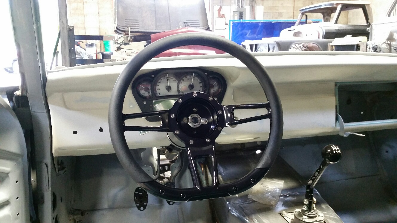

      So a quick look at the dash. Dakota Digital universal competition analog will monitor the motor. Name:  20160604_115343_resized.jpg
Size:  326.8 KBName:  20160604_115352_resized.jpg
Size:  324.8 KBName:  20160604_115409_resized.jpg

      As you can imagine using a motor from front wheel drive car and making it rear wheel drive has been trying at times, nothing is bolt on. everything is fabricated. The motor that you see is just a stock take out we are using to get everything mocked up. We had to make everything. from the oil pan to to the intake and exhaust manifolds. We are doing some spray outs tonight to get the color dialed in as close to the rendering as possible. Still a little ways to go before we see paint. But we are close.
      16,118
      What bellhousing and transmission are you using? Also, who makes that seriously wicked merge with the integrated WG port?
