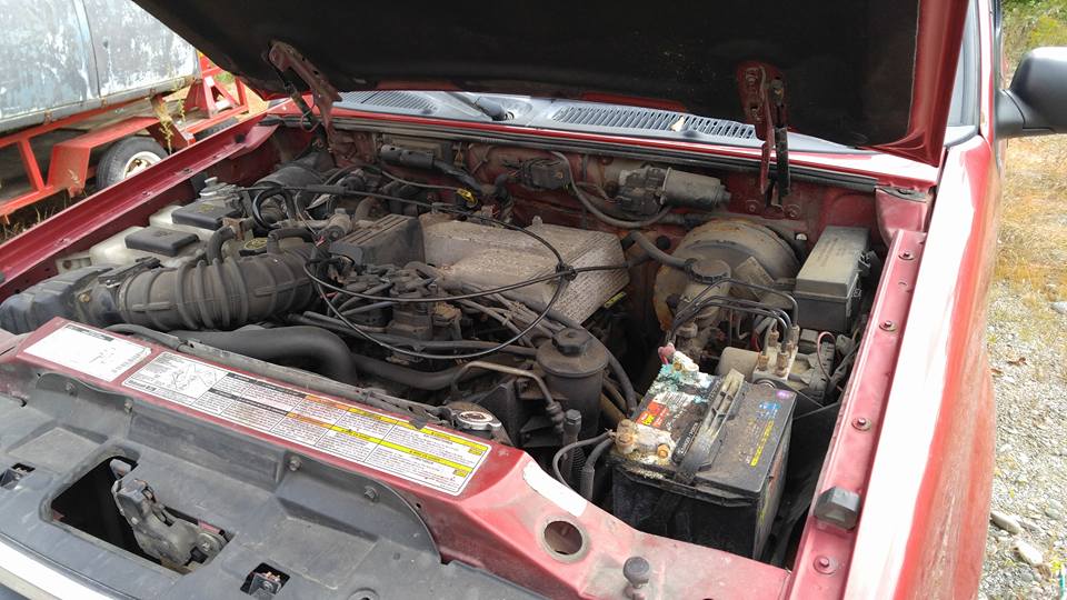

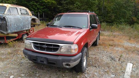

      here is my donor.. i am going to use as much of it as i can, brakes, cooling, electrical etc to keep costs down and simplicity...Name:  14572232_10211105143251395_7778763555921089914_n.jpg

      Been thinking using the Explorer AWD platform on a car as well. Subscribed.
