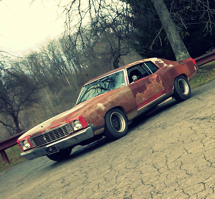

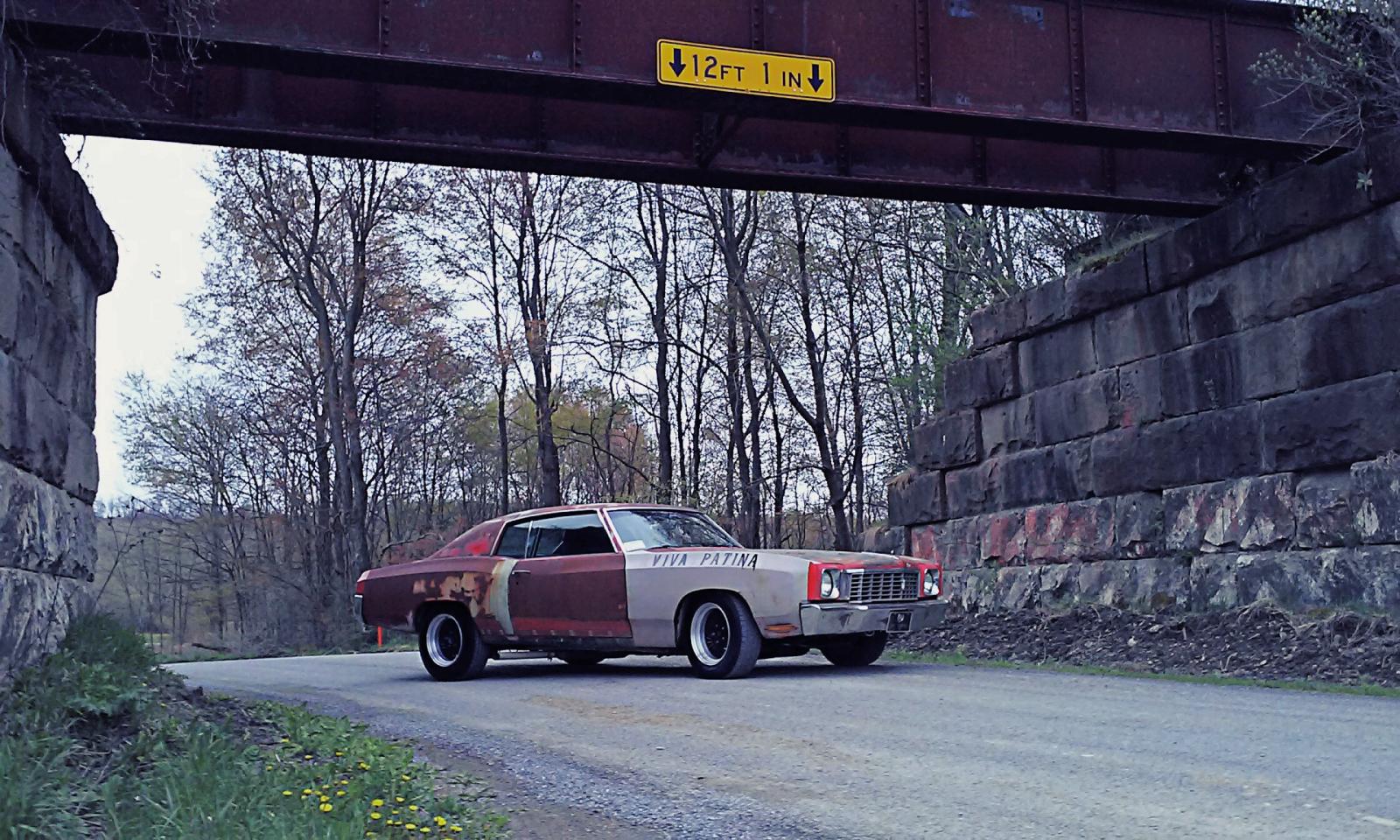

      Hey everybody, just wanted to share mypro touring build with you. The “Rot Cadillac” is a 1972 montecarlo with big block caddy 472 and th400 and 12 bolt posi in therear. As far as mods i'm runnning d52 wilwood calipers upfront andhelwig sway bar. Rear disk brake conversion will be in the future forthe car. Wider wheeels will aslo be in the car's furture. The mainthing that I want to replace is the springs, i've seen a few of thechevelle guys running circle track springs and adjusters, I don'tknow if any of you would recommend that set up or if you have anotherset up you would recommend?

      Looks sweet. I've always been a big fan of those cars. Back in HS my buddy's dad had a 1970 Monte SS, LS5 car with a 2.73 gear. Shifted into 3rd at about 80 mph...lol

      yeah my dad has a blue 1971 pro street monte, i love that car so much, so many great memories riding that car. Thats the main reason i bought one

      thanks. The monte's my first muscle car i've built. i'd like to turn her into a corner carver, just gotta figure out what parts i should start ordering. Spring are the main thing i'm struggling with, i don't really want to run coilovers, i've thought about the circle track springs. So many options.
