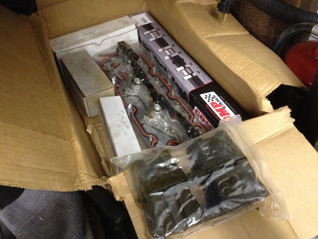

      My LS2 only had 18K miles on it and I still have all the stock parts including the cam so if these parts will work for you I don't need them.

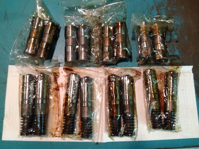

      So you have the 8 special lifters too? If so I'd love them! That should be all I would need, I'm just trying to get this engine running and quiet again.

      I should have everything including the lifters. I'll dig out that box tonight and post a pic of what I have.

      This is what I have. This website is picky about uploading pics so I had to use that spam infested tinypics.
