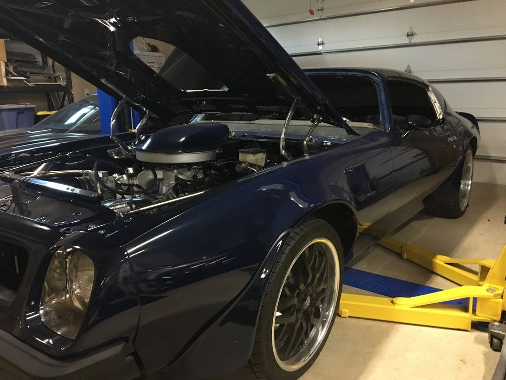

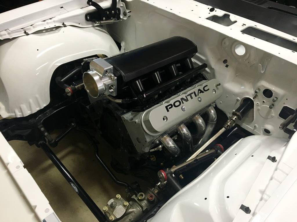

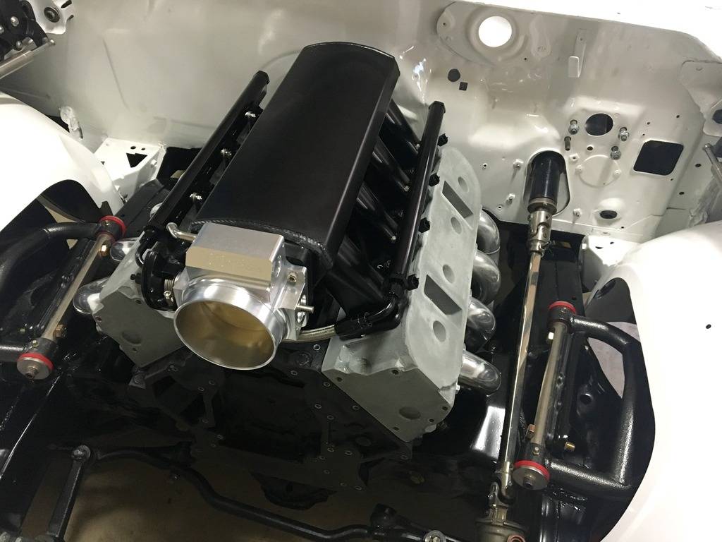

      Here is the engine on the 74

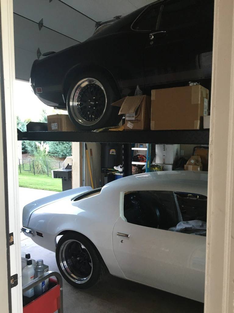

      Im all full... cant possibly squeeze anymore cars or could I LOL
      Im finishing my 74, so I can than concentrate on the 1971, my Painter Don, got the doors aligned on the 74 almost perfect.. got the gaps on door, fender and hood real nice

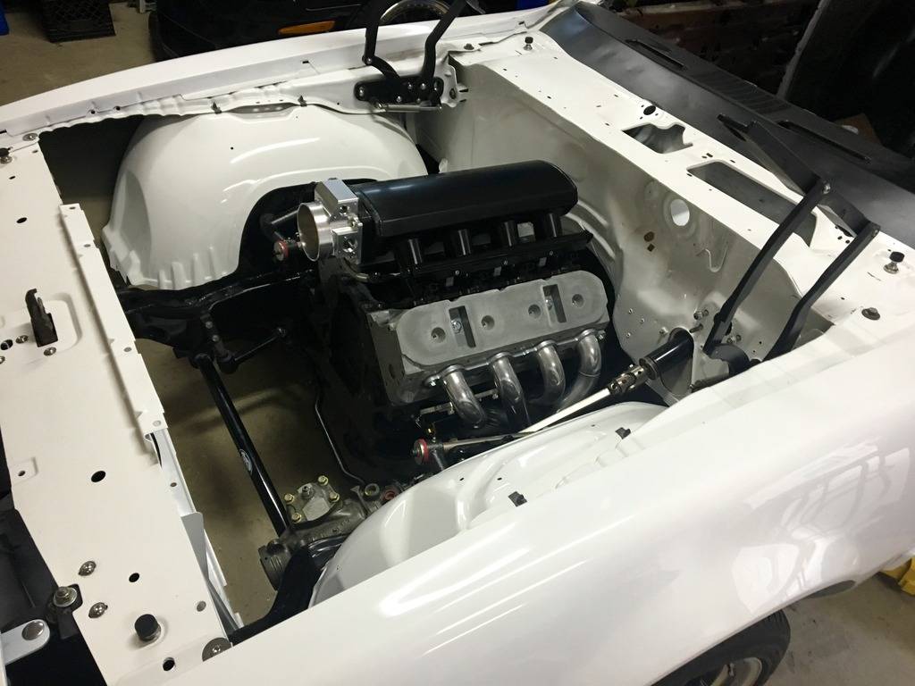

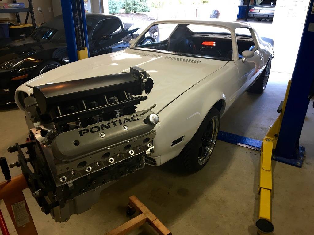

      Started to mock up motor to make sure everything fits...

      That's going to be a tight fit! Projects are looking great.

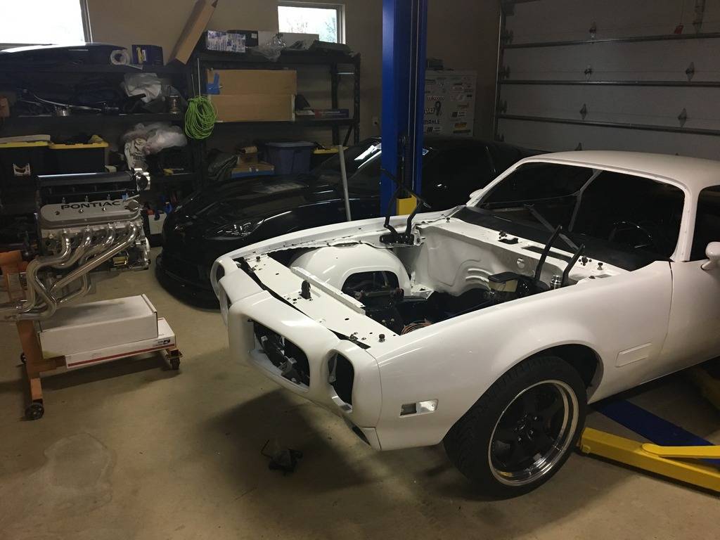

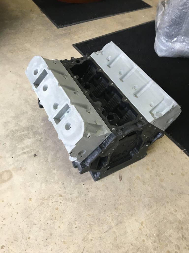

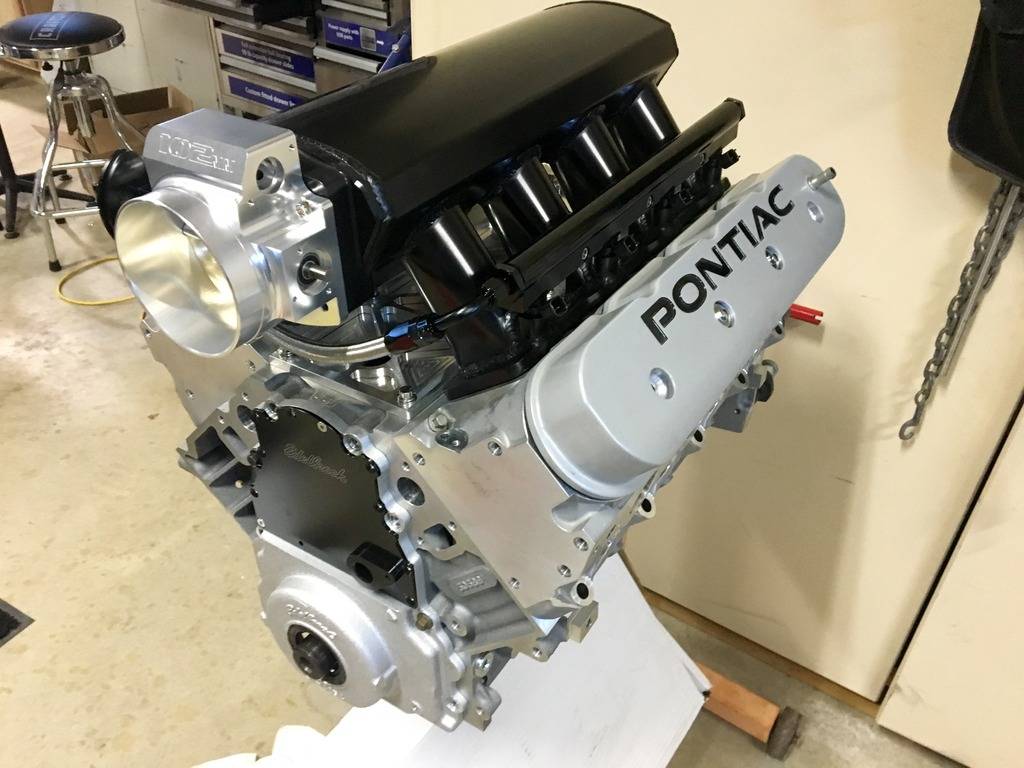

      Well did all the mock ups.. I bought a mock up LSX(the foam one) and mouthed the tranny... I bought the speedtech motor mounts and tranny mounts all worked well..intake is to high, so I oreded the short verison, I will keep the tall one for my Truck.. The mock up motor made it SOOOO easy... Its light as hell

      Going to look great in the white engine bay!
      What is your plan for the coils?

      I agree- I was hesitant on the white fenderwells but it really does look nice and modern.

      I have remote wires and coil holders.. Im mounting them on the back of the firewall hidden
