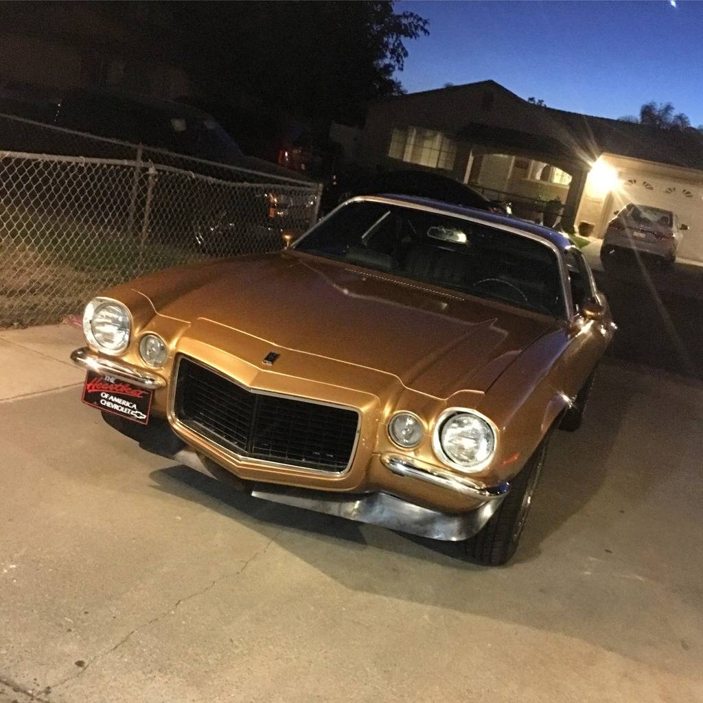

      Great looking car!
      Plans?

      Beautiful car and unique color. Looks like a great one to start with.
      1973 Hurst Edition Pontiac Grand Am: 430 CI of ERL built LS7, Tremec Magnum T-56 6-speed, Global West / Speedtech Suspension, Custom rear coil-over suspension, QA1 double adjustable shocks, Wilwood 6/4 piston disc brakes, Modulare C1 19" concave wheels. Shooting for 625 HP and 20 MPG!
      16,129
      Love the color!

      So i've decided the 1st thing i need to upgrade is suspension and steering, since it drives like a boat. I've been thinking about doing a ridetech LVL2 package and then doing a Delphi 600 quick ratio gear box, everything i've read sounds good. I've also thought about doing a DSE front subframe but i think i might be doing a little to much since i'm not going to race or anything. I really just want the car to handle well.
      I've also been looking at motors, i cant decide if i want to stick the 350 or go with something like A LS2+T56 combo, but it seems that requires alot more work than knowledge i have, so maybe ill have to do my HW before going that route. More than anything i want a clean looking engine bay, so i'd want to clean up the firewall and get rid of the unnecessary things under the hood.
      What i'm really trying to avoid is spending unnecessary amounts of money, so if i'm going to do something i want to do it right the 1st time instead of having to go back and do it again. Maybe you guys have some opinions i can take into consideration.

      The only thing I would add to the Ride Tech Lvl 2 would be a sway bar of some sort. The Detroit Speed setup is awesome but is overkill for guys like us that will see more street than track time.
      I agree with Andrew, the LS swaps are now so easy even I can do it. Do that, you'll be glad you did.

      Chuck,
      If you actually plan to drive the car a lot then doing a LSx swap with a T56 will make the car very streetable. I bet even a 5.3L makes more power than that old 350...
      LS swaps are very well documented so don't be afraid. Holley makes a very well engineered set of swap components that are all designed to work together. They have the engine mounts, oil pan, transmission crossmember, headers, and full exhaust.

      Yeah, keeping the car streetable is exactly what i want. The car wasn't numbers matching when i bought it anyways so thats why i was thinking LS2. Currently it has a LT1, (from what year i have no idea) but it runs like a champ. It has 12bolt rear end with 3.08 gears so if i swap out the gears and go with a 3.73 set up with the T56 i think that would make a great combo. i dont need a crazy 800HP to drive around. Not that there is an wrong with having 800HP but i'd be more than happy with about 450 to the wheels which im sure i could achieve that no problem with a LS motor. I'm just trying to stay realistic in my plans and manage expectations. Thanks for the advice.

      I think you'd be very happy with something like a 480HP LS3 crate engine. It would make for an excellent driver with the 3.73 gears and a T56...keeping tire diameter around 26 inches...
      Also, your car seems to be begging for the new ridetech street grip system. Keep it simple...the 2 gen geometry is pretty good already.
