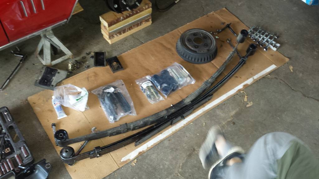

      What was involved in swapping the leafs? Was it just a bolt in place? (As I was typing I remembered I had a picture)
      Would also like to hear more on you impressions of the fiberglass leafs. Are you putting much power to the rear? Any wheel hop issues? I assume you put the rear swaybar?

      "Viperman"-I can only offer opinions on how my butt feels driving my car now. I am certain there is someone out there who can offer a complete pic/pic and technical comparison. I like the car now, didn't before.
      "rohrt"-- Since you provide pics of springs on the floor, you are MORE than capable of installing the streetgrip. Both springs simply replaced stock pieces with no modifications. (bolt in place) The rear kit came with all possible hardware for both mono and multi leaf perches. I suppose I should have taken pics but it was REALLY hot and I was in a hurry to see the improvement. Total rear swap took me about an hour. (clean car-nothing rusted) There is a vid somewhere of them installing it in a parking lot.
