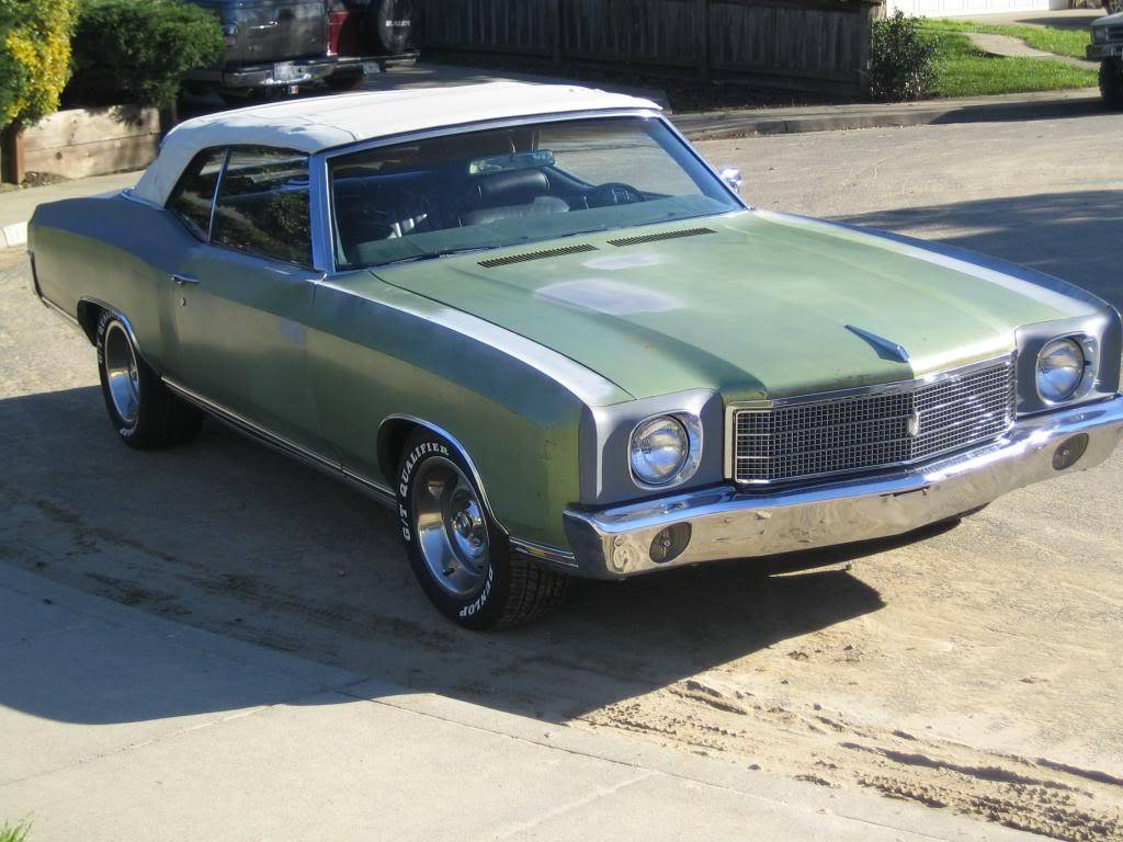

      It can be done without air bags, Your gonna need roughly 2-1/2- 3" of drop.
      I've owned several A-body's with 3" lowering springs, it won't ride the best, it won't correct the short falls from the factory geometry but it's a great "budget" option to achieve the look your going for.
      One of my old Monte Carlo had Hotchkis springs up front that I believe I cut 1 coil off and had 3" drop springs out back from CPP. I don't recall if I had the CPP or Hotchkis in the rear in this pic.
      At the time my go to tire was a Dunlop GT Quailifer in 265/50/15 square, good luck finding that size now. ��

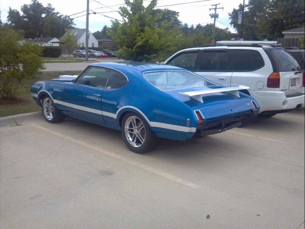

      In back I am running the (I think )9'' circle track springs from speedway. I'll try and double check when I get back. For tires I'm running 18x10 front and back(C6Z06 rims) and 285/35 front and 295/45 in back. I'll post some pics in a few.
      For front suspension, I'm using the SC&C front adjustable arms with tall upper and lower ball joints, they are great! Shocks I'm using the Factory valved Varishock SS. The adjustable arms allow you to ACTUALLY get the caster/camber specs you want. I found that the arm length requirements were different left to right due to age/tolerance..etc you know from being 45 years old(couldn't correct for this with tubular arms). I did this all on a budget, and got the arms and talls uppers first, only recently I added the tall lowers to eliminate the bump steer. let me know if you have any questions on my setup, whatever route you choose I'm sure it will turn out awesome!
