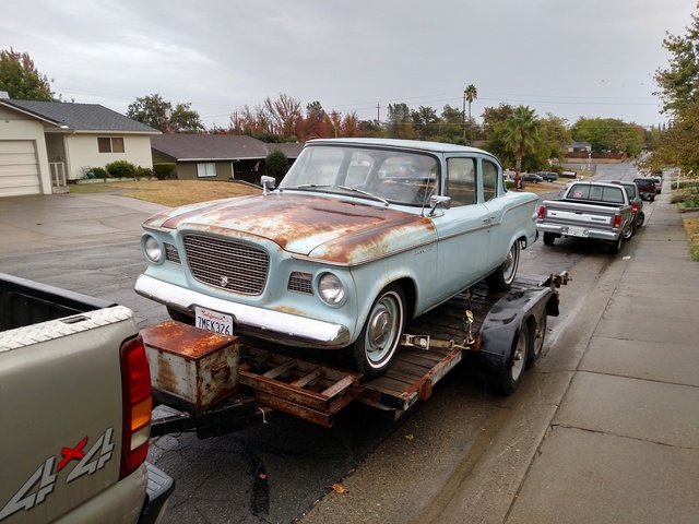

      Picture from the craigslist ad

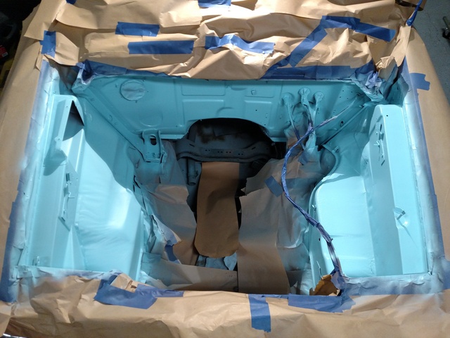

      I did clean up the trunk floor as well as the engine bay before deciding I wanted to do a modern V8 swap in it. These were the same blue just different lighting.

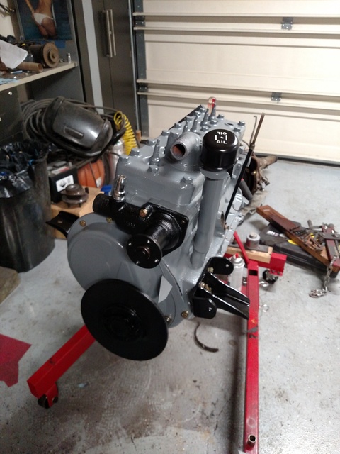

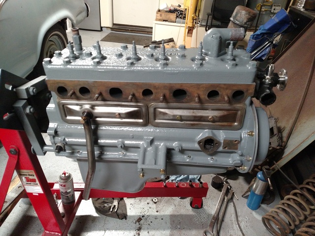

      Pulling the old flathead 6, this thing ran extremely well I cleaned it up and painted it with the intention of dropping it back in at a later date.

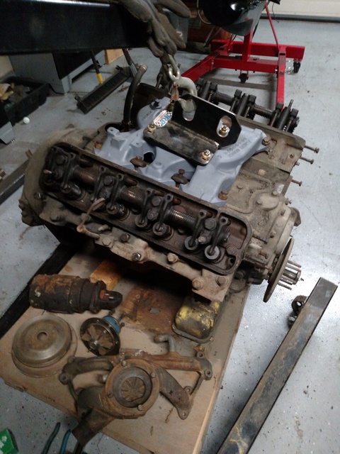

      My first thoughts of a V8 swap involved an original Studebaker 259 but then when I started looking at the cost of the rebuild kit+machine work I realized I could drop an LS in this car for much less and have a bunch more consistent and reliable power.

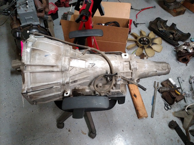

      Then shortly after that picked up a used 4l60e.

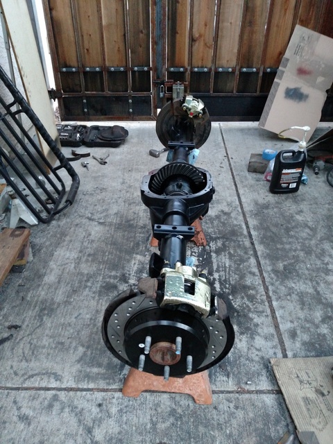

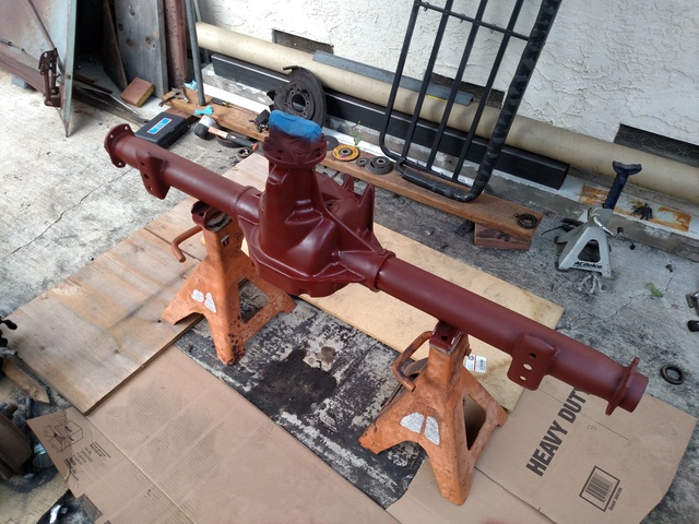

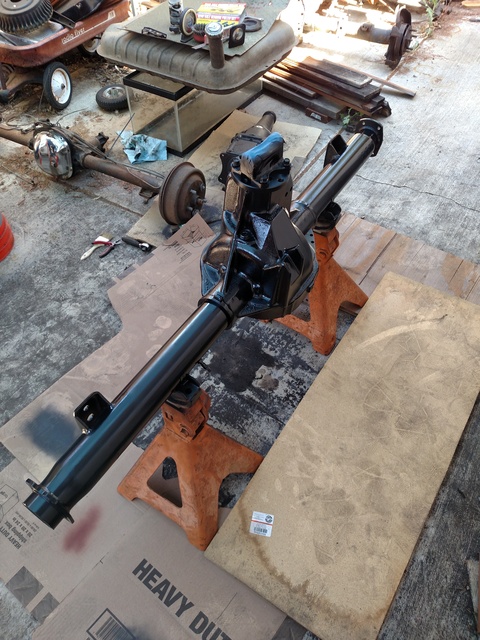

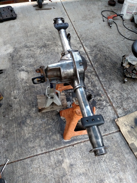

      To transfer all the new power I picked up a 31 spline Ford 8.8 with 3.73s and factory limited slip. I smoothed it all out and moved the spring perches 15/16" in on each side to match the Stude then laid down some primer and finally a satin black top coat. The original axle was a puny Dana 30.
      I also replaced the outer bearings and seals.
      I'm running Stoptech rotors all around, OEM style rear calipers and wilwood front calipers.
      Got a Moser cover and lube locker gasket an bolted it up. I left the sway bar brackets because I'll be using them.

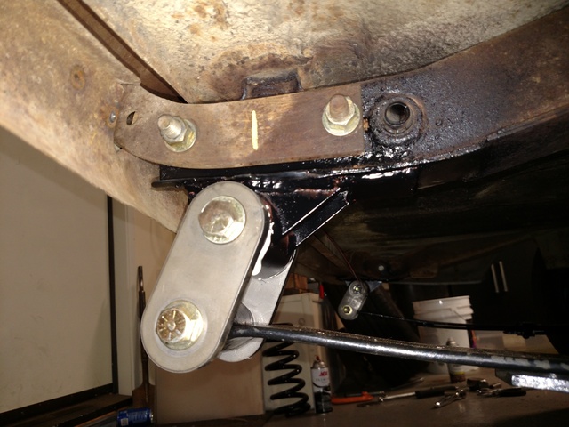

      The rear suspension is a Hotchkis leaf pack for mid 70s dodge dart. I settled on these because the front bushings to center pin distance is the same as the original Stude leafs so there was no wheelbase change and the weights of these cars are similar. The only difference was the overall main leaf length which was 4" longer so I welded up a new rear shackle hanger and it was good to go.

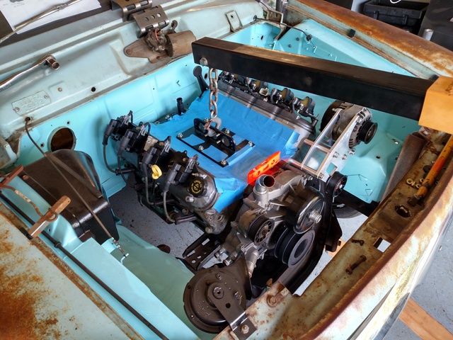

      Test fitting with the Hooker exhaust manifolds. At this point I realized I was going to have to pull the factory steering and replace the front crossmember in favor of a mustang II assembly in order to achieve the proper fit and performance I was after.

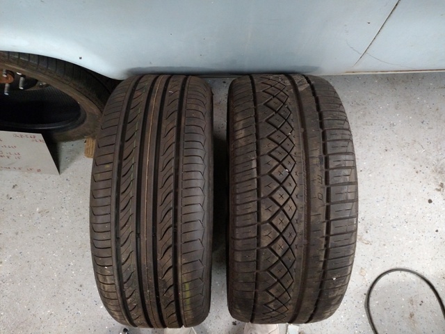

      For wheels and tires I'm going with 17x9 wrapped in 245/45r17 tires all around. I don't have the wheels yet but I picked up a pair of used 245s to check fit.
      Here they are compared to the 215s I was originally planning on running.

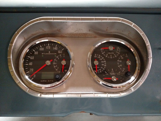

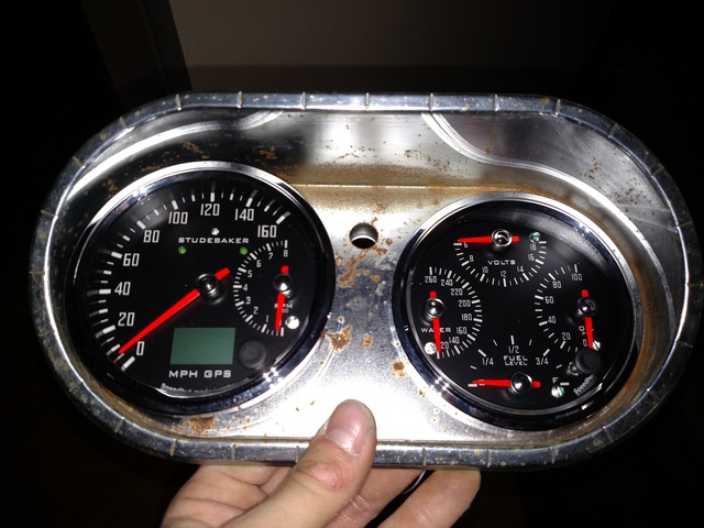

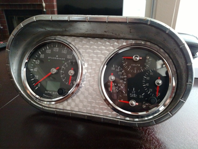

      I'm running Speedhut gauges in the original location by using a 2 in 1 speedo/tach and a 4 in 1 volts/water/oil/fuel set. I also had them put "STUDEBAKER" on the speedo gauge.
      Original set
      Speedhut set

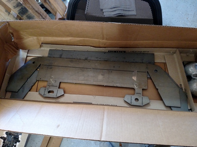

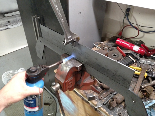

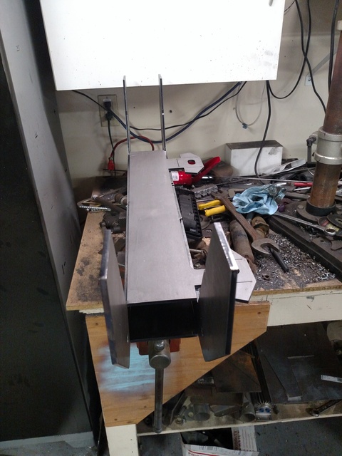

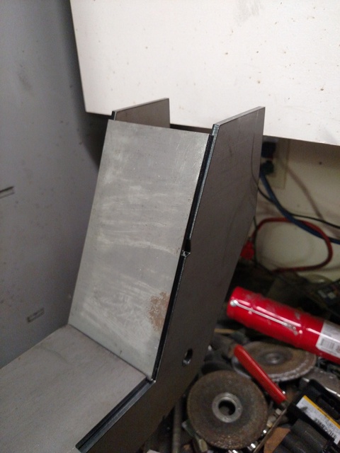

      Here's the crossmember in all it's flat glory. It's all 3/16 plate bend and weld style from Paul Horton's welder series. For the budget minded builder it's a nice piece and keyed together very tightly without any tweaking.

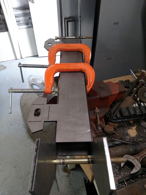

      I warmed up the tabs a little before bending as to prevent them from tearing.
      Boxing plates.
      Bolts slid through to keep everything true. I still need to clean it up before welding but just wanted to get a little start on it.

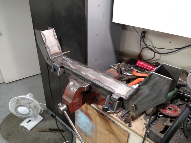

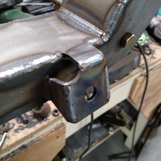

      Welded up the crossmember last night and I'm very happy with the results, I alternated sections and let it cool awhile after each section as to not overheat the entire piece. I kept the two half inch bolts in the lower control arm holes throughout the process and they still slide freely in and out so I'm pretty confident it didn't warp.
