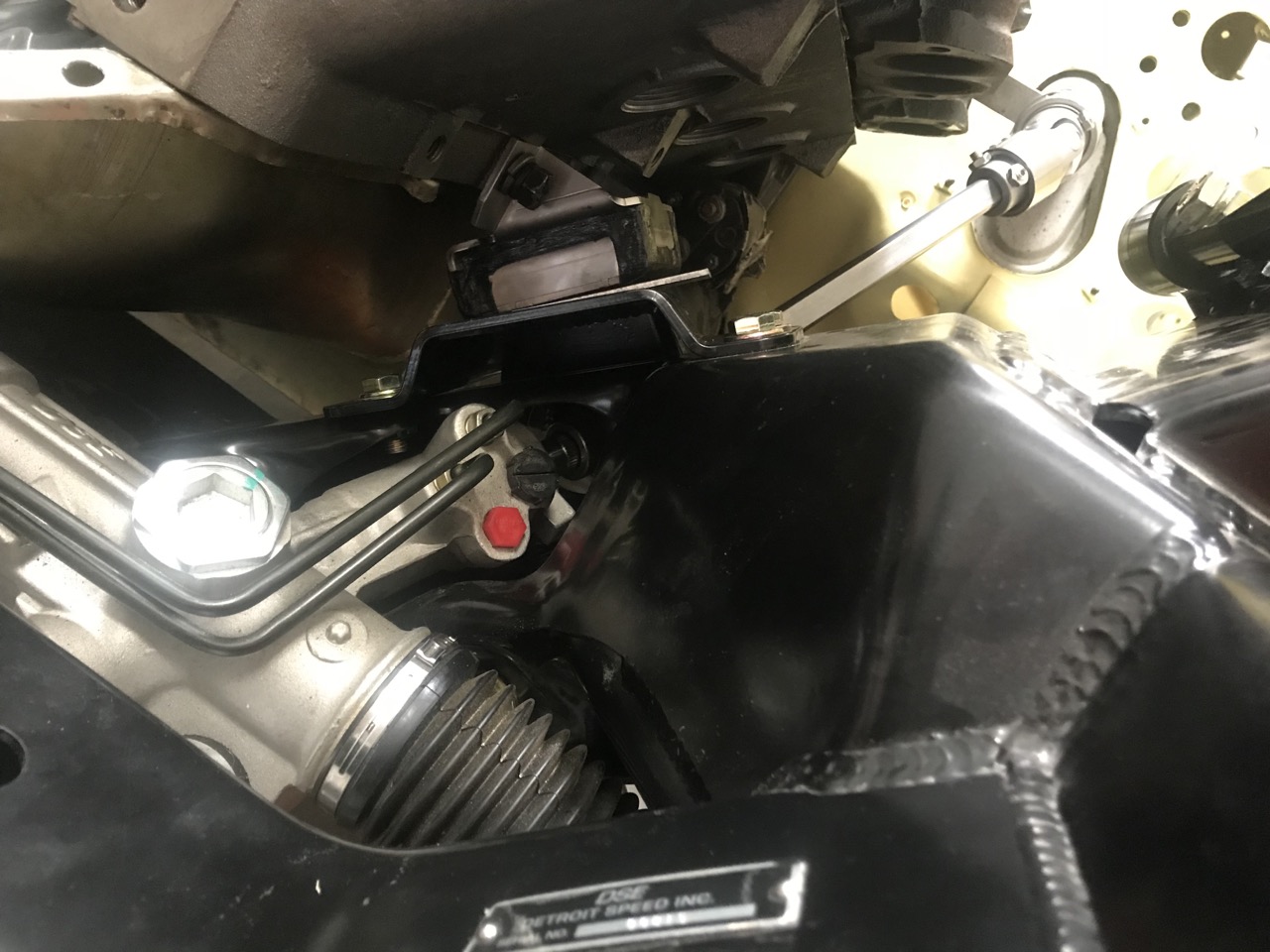

      Using a DSE subframe and Pontiac engine in my 70 Firebird. Bought the engine mount brackets from DSE and the correct motor mounts. But when I went to mock things up yesterday, I noticed that I have a good 1/4" gap on one side. I had to use a spacer to get things to line up. Anyone else have the problem? It looks like the passenger side engine mount bracket is about 1/4" flatter than the driver side...don't know if that's by design or if I have defective bracket.

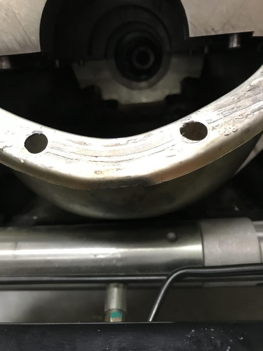

      I bought and installed the poly mounts from Butler, and unfortunately, I'm still having the same issue. Actually, I ran into another problem. I installed the oil pan (Canton) and it hits the steering rack. I added .19" spacers on both sides, and the oil pan clears by a sheet of paper (before I snugged everything up). I'm thinking I need to go another .05 or so on each side, so maybe .25" spacers on both sides will do it. I shouldn't have to do this...I'm wondering if there's an issue with the DSE Pontiac engine mount brackets. The one on the passenger side is about 2/3 the height of the one on the driver side.

      Here are some pics. Notice how the passenger side bracket is shorter than the driver's side. It seems to me that if they were the same height I wouldn't have to use spacers and it would be enough to raise the oil pan off the rack. Can TerryD or anyone else confirm that the brackets are different heights?
