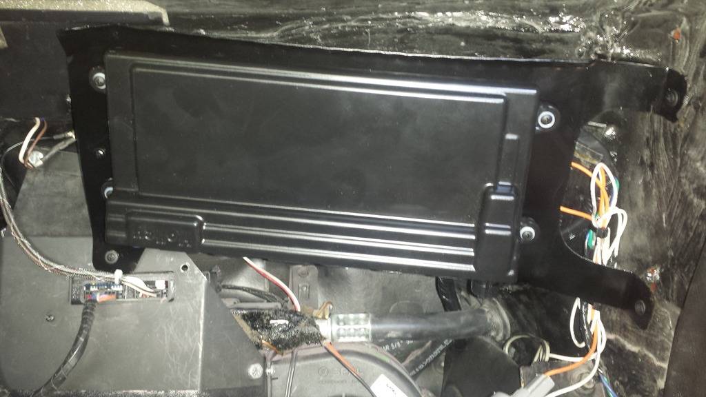

      slowly making some progress, I made a bracket out of 16 ga steel and installed it in my dash area and mounted the ECU to that. I already have the wiring done inside the car and have the connector harness running to the motor. Been waiting for a LS6 intake I ordered to get here so that the hold up now.
      Cleaned up the wiring to the VHX module while i had the dash off too. Still a rats nest, but it's a little cleaner now lol
