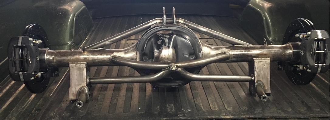

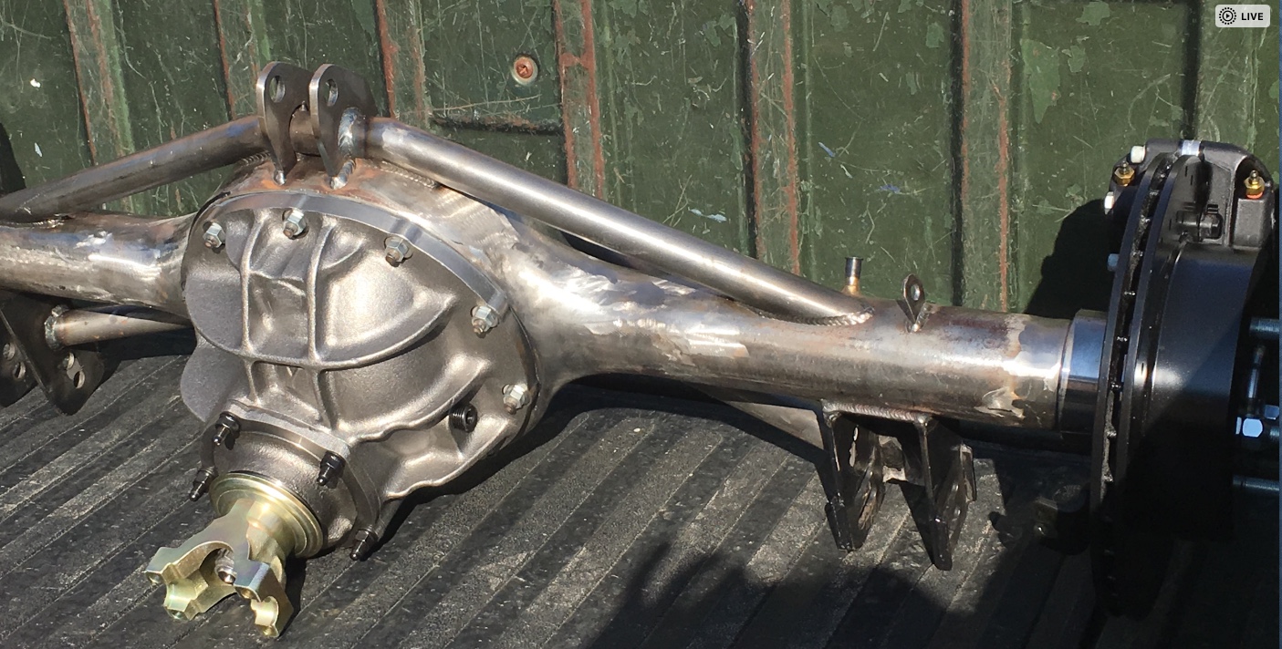

      The rear-end is assembled - thank you Mike! Below is the build if ur interested:
      - Yukon Zip Locker YDGF9-31-SM, clutch pack, street posi
      - Nodular Iron Case, HD, Center Section YPDOF9-2-306
      - Daytona support bearing kit YK F9HDC-SP-C
      - Yukon 3.70 Ring Pinion YG F9-370
      - Forged Pinion Yoke 3150, 28 Spline YY F900662
      - Moser Axles, 31 Spline, 27/24 lengths, 47 in end-to-end
      - Big Ford Bearings and Torino Housing ends
      - Willwood 12" Rotors and 4 Piston Brakes 140-2114-BD
      Looking at transmissions - favoring the Tremec TKO.
      Name:  rear end 2.jpeg
Size:  182.0 KBName:  Rear end 1.jpeg
      Best Regards, Jeffery

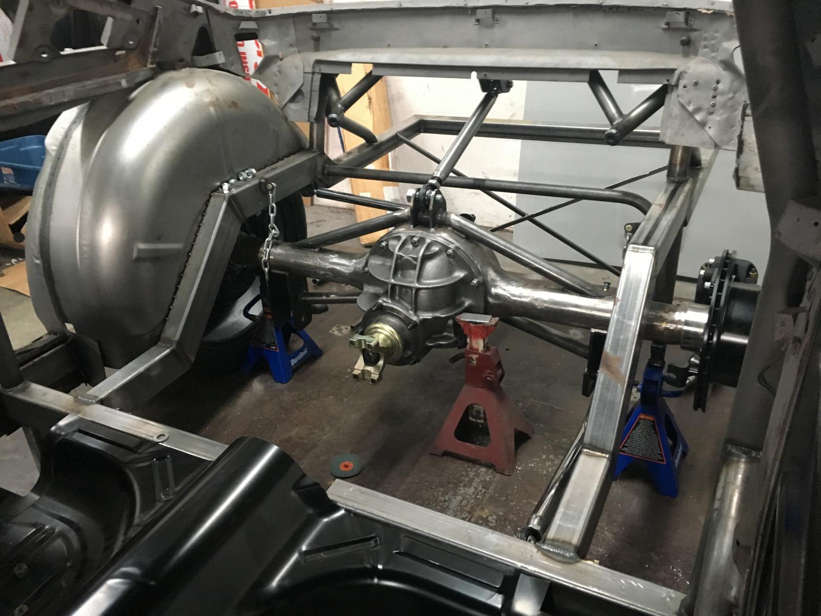

      Name:  Rear End Back.jpg
      Name:  Rear End Front.jpg
      Still setting up the reared and making ajustments to the links.

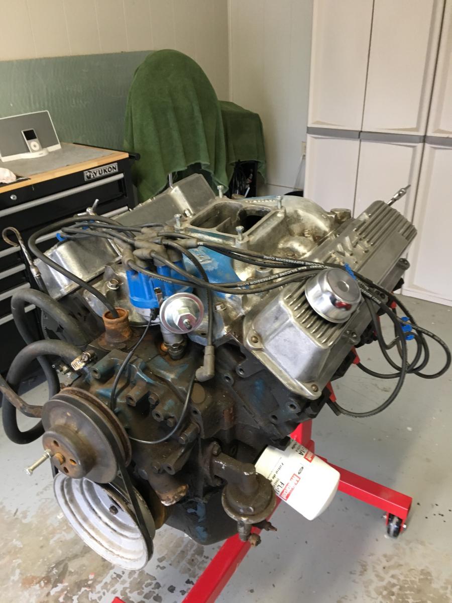

      Picked up a 351c today. DOAE-J Feb 10, 1970, 2 bolt, 2V heads, and a CS Shelby manifold.

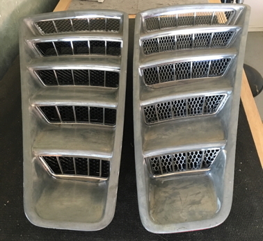

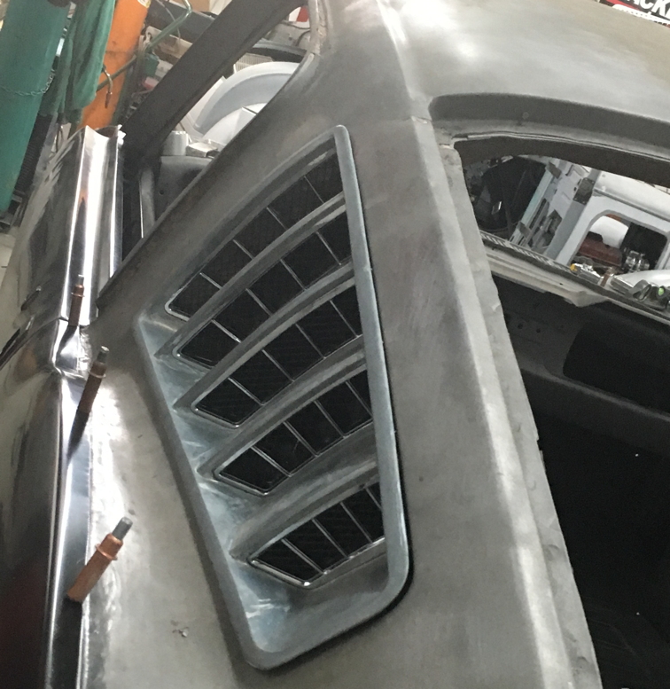

      Sail vents and body work ..
      Decided to keep the sail vents but could not help myself; changed out the aluminum vent screens with a darker screen. hope this is ok -- gives so much more contrast. Used a metal gutter guard found at the local hardware store.
      Name:  Sail Vent View.jpg

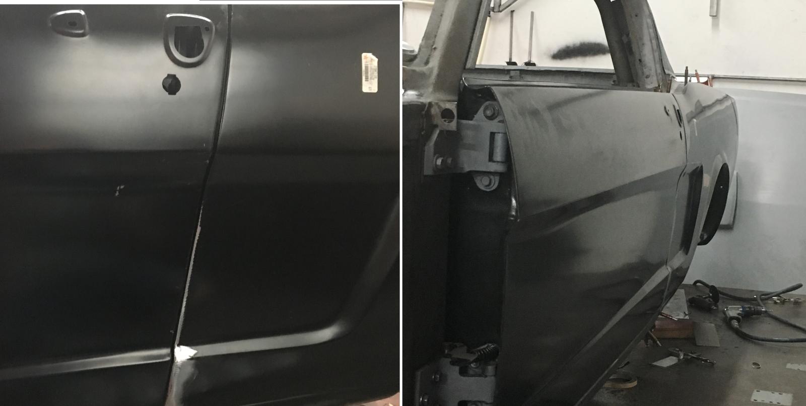

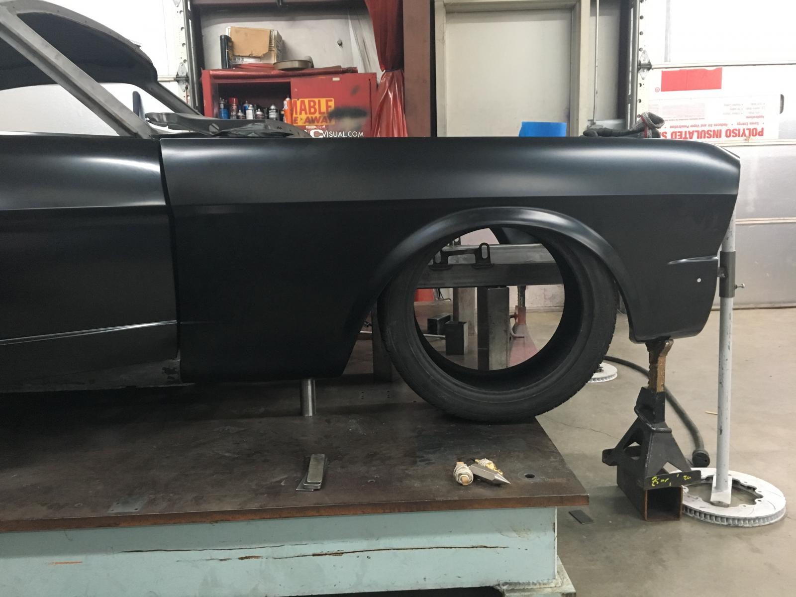

      The body panels & doors are tight. Really look good beyond my expectations.
      Name:  Body full view.jpg
      Name:  Body side view.jpg

      What's the plan for the 351? I'm curious about your front end .
    15. #35
      Dec 2015
      32
      Thanks for the replies!!
      I wanted a vintage motor so a 351c seems appropriate. Still researching but thinking a mild stroker kit, proper oiling system updates, Milodon rear sump, modern heads, and using the Shelby intake with a carb.

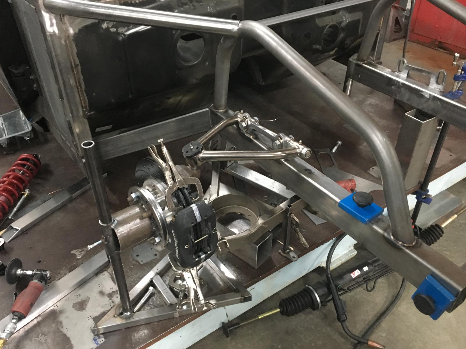

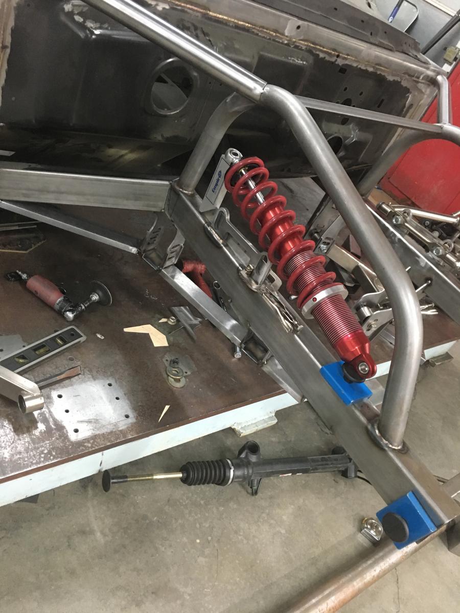

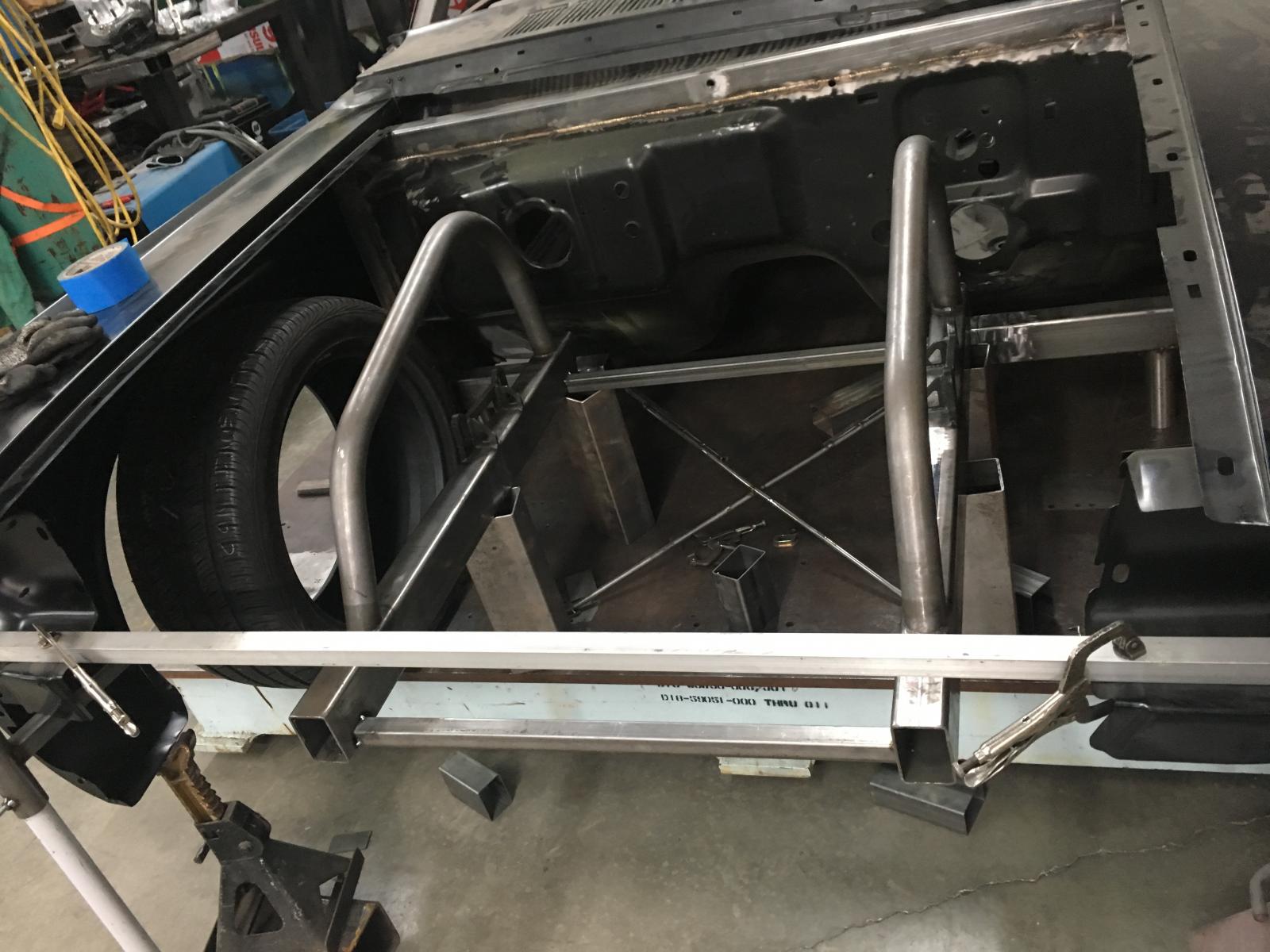

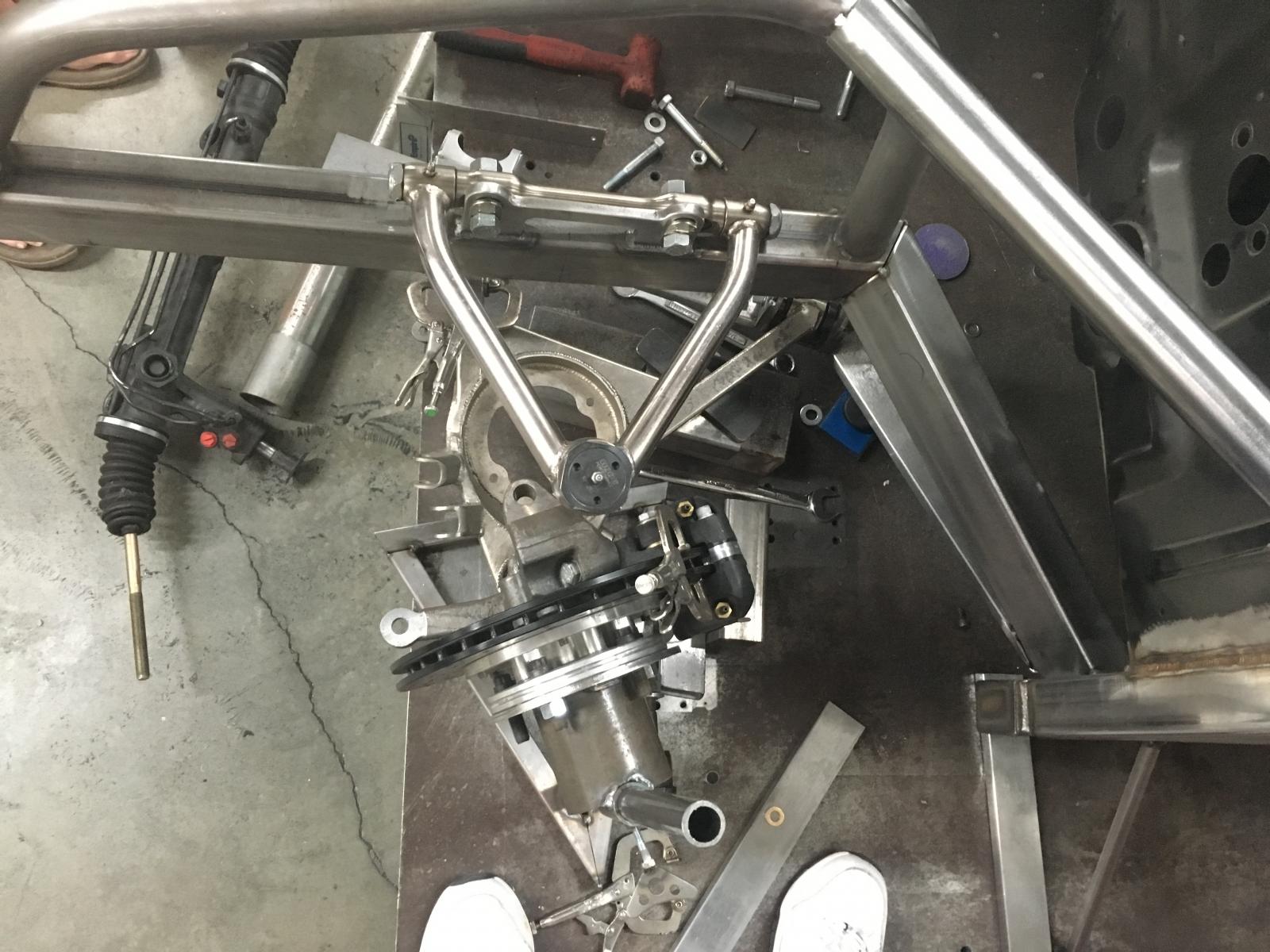

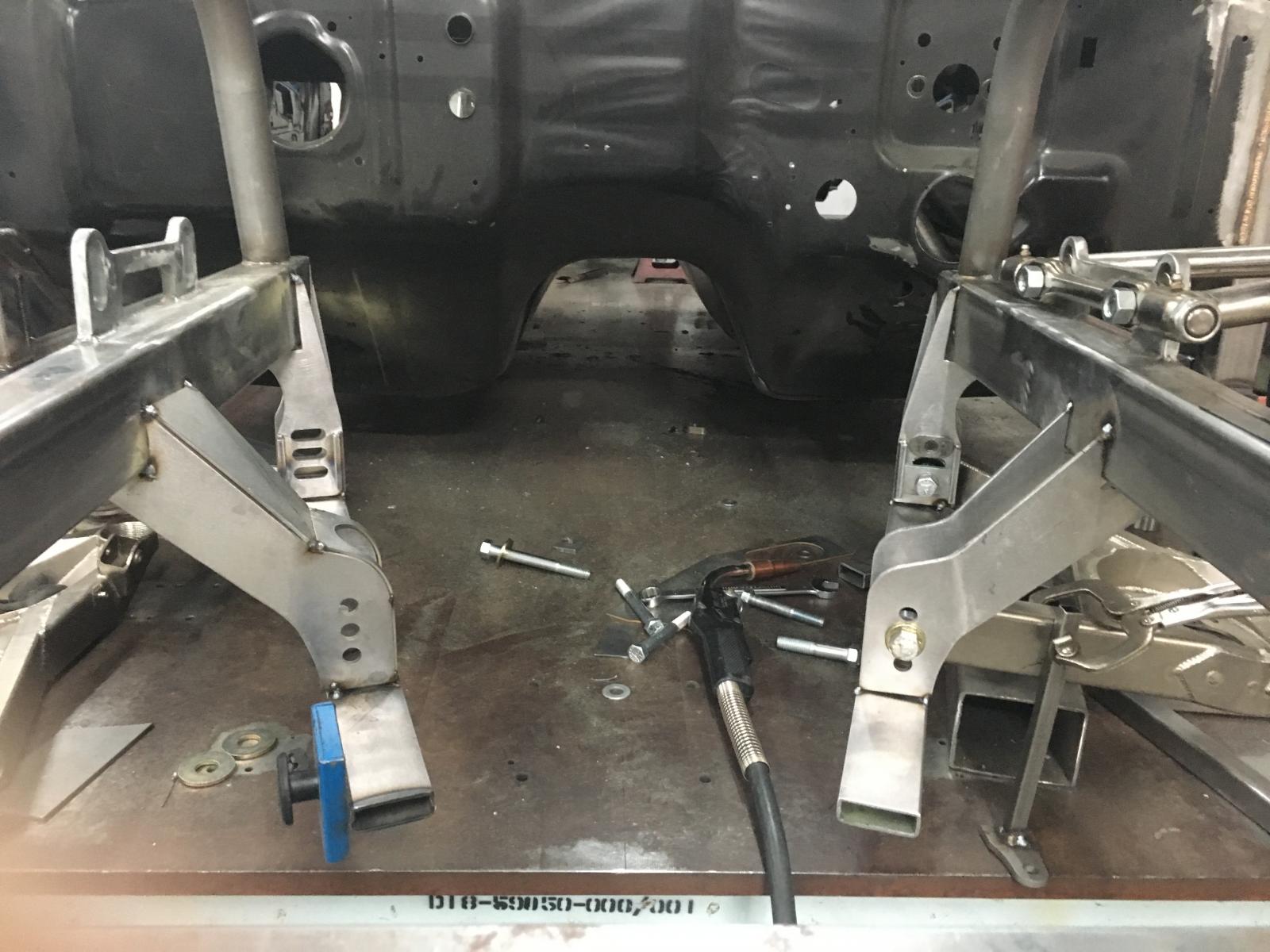

      Starting the Front End
      The control arm supports are tacked in place just incase some adjustments are needed for the steering rack and sway bar. We will be using a rear sump oil pan.​​
      Name:  Front End 5.jpg
      Working engine mounts now to set the motor block and transition then resolve any issues. At some point finish the welds and fabricate new control arms.
      Name:  Front End 1.jpg
      Name:  Front End 6 L.jpg
      Below is kind of the initial coil over placement idea for the cantilever suspension.
      Name:  Front AEnd 7.jpg
      There are more pics on the project web site if ur interested.

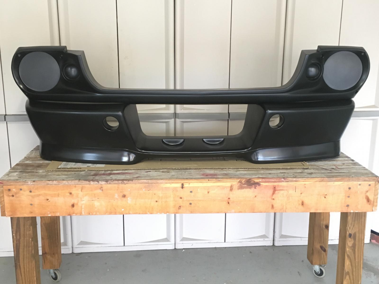

      Parts have arrived!

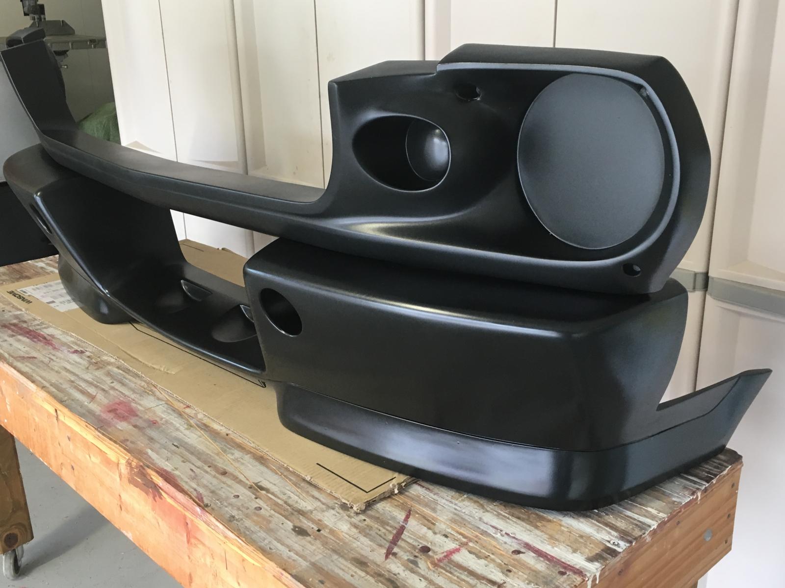

      Finally made a decision on the front nose section, lower valance, and purchased the transmission.
      Just had to have the Eleanor style and the product line from Maier Racing is an outstanding addition to the build. Will need to save up and buy the other parts later.

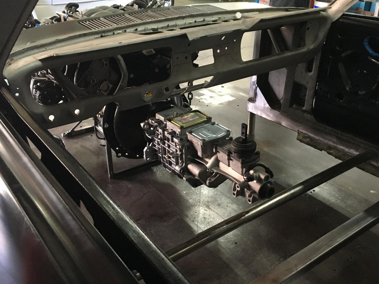

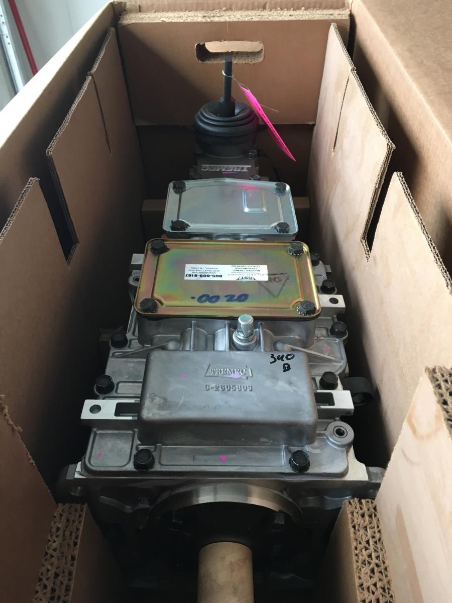

      Now have a sweet Tremec TKO600 5 Spd from Silver Sport Transmissions - SST with the Stage II Performance Enhancement Upgrade and picked up a Quick Time SFI Bell housing.

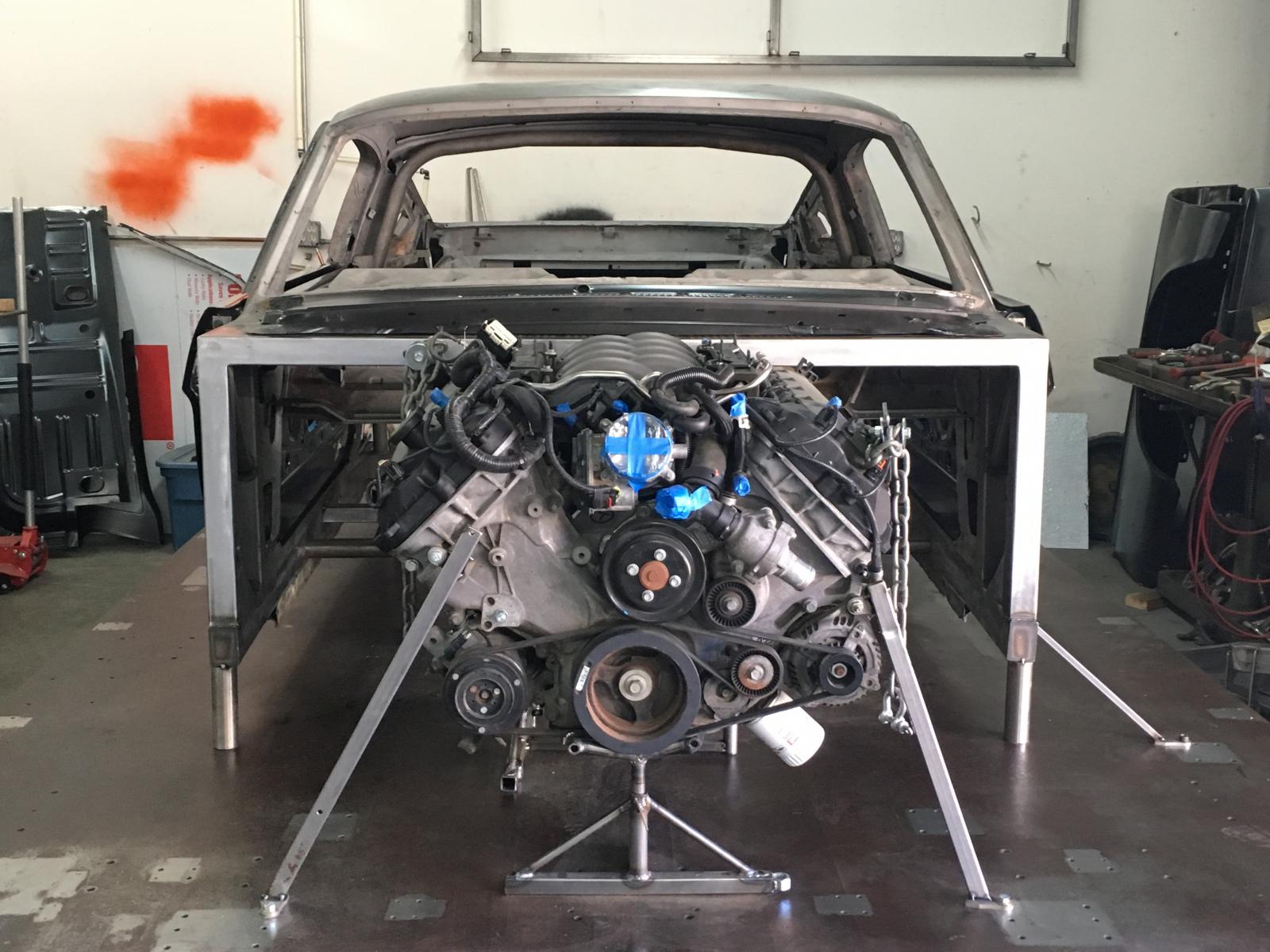

      Going Coyote ...
      We had a set back and trying to recover. Sadly discovered multiple cracks in the 351 Cleveland block I bought - water jacket areas mostly.
      So we are going Coyote. Picked up a 2013 5.0L Coyote w/ 52K miles pulled from a Mustang GT. William at (Wade MotorSports) helped us out.
      Name:  Coyote pallet 2.jpg
      The Coyote engine is enormous compared to the Cleveland. This has caused rework - bascally had to remove the entire front clip, firewall, and the floor pan to fit this engine. Now we can determine the right position and height to place the motor and build around it. First time dealing with a Coyote, so we'll see how this goes.
      Name:  !Trans inside view.jpg

      wow, it really does look bigger, I never realized the size difference. By 'nascar country' I assume you mean Mooresville?
