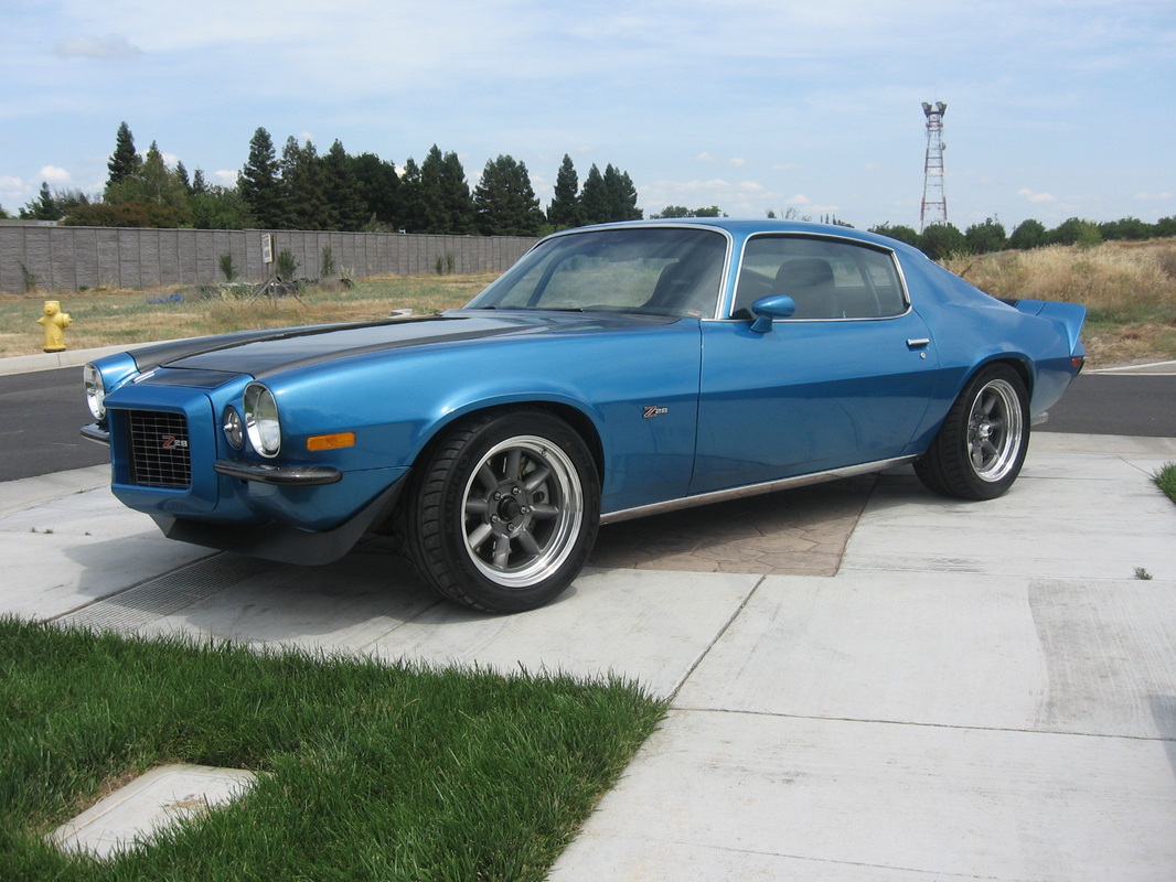

      I can't find original pics, but here is the car in progress.

      Full Body Shots
      The car as it is right now.

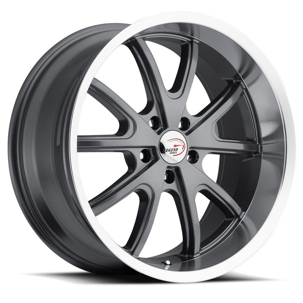

      For wheels, PTFB Dave advised me to go with Vision 143 wheels in size 18x9.5, 0 offset, 5.25 bs. He said I may need 1/4" spacers. At $140/ wheel, the Vision 143 is hard to beat. It is also very difficult to find any other style wheels in 18x9.5 with the right offset and bolt pattern. There are similar wheels offered by other companies, but they cost slightly more and have a lower load rating. At $560 for a set, these wheels are the obvious choice, and yet I am struggling.
      When I first brought the Camaro home and started poking around under it, I met with a number of black widows. I thought it would be a good idea to use a spider bomb to clear out the population. I never got around to it, but I did get the idea to use that for the car's nick-name. "Spider Bomb". My sister Hannah, for whom I was building the car, does not like spiders, and did not like the name. Then I thought we should call it "Black Widow", which has more positive connotations to my sister, who is a bit of a Marvel buff, so the idea stuck. More recently I was considering what wheels to get and thought it would be cool to get 8 spoke wheels to go with the arachnid theme. I then discovered minilite style wheels, which are gorgeous, and have ties to 2nd gen Camaro racing history. Since then, I've had my heart set on them.
      Team III offers them in 18", which I will need to clear the steering arm in the desired width. Those are also my favorite rendition of the wheels. Some people may think that the flat center such as Trans Am Engineering offer are better because they are more true to history. However, these types of 8 spoke wheels lend themselves better to 4 lug designs, such as old Porsche's. On a 5 bolt, the holes cut into some of the spokes a bit. On Team III's design, there is separation of the bolt pattern and the spokes by a rim around the center of the wheel. (CWW's also have this feature, but the spokes are straight rather than curved, making them slightly less graceful. More importantly, they are only offered in 17" sizes).This also helps with the porportions of the wheel in larger sizes. Have you ever noticed how Torque Thrust style 5 spoke or 6 spoke wheels in larger sizes look gaudy, like chunky jewelry? The spokes get really wide. The visual bulk is off-putting. In contrast, Team III's LT3 spokes appear agile and sporty. They are not only smaller due to the fact that there are more of them, but they also start further out from center and have less distance to go as they widen out, so they don't get nearly as wide.
      Now, back to the Vision 143's. Here is a wheel that has ten spokes that are thin, which helps give the wheel a sporty look, while still being vintage-looking. Moreover, a ten spoke pattern lends itself more naturally to the 5 bolt pattern. Every-other spoke gets a lug. Nice. Except it isn't. The wheels are an eye sore. Every time I looked at them I tried to appreciate the virtues of the design, but something seemed a bit off. Then I realized what's wrong with them. They can't make up their mind what they are. Are they a split 5 spoke, or an evenly spaced 10 spoke? Nope. Neither. You will notice that the spacing is different between every-other spoke. It's only slight, and you almost won't notice it. But you will, and when you do, it's annoying. At such a good deal, I want to like these wheels. But, as it turns out, just because something is a classic, doesn't mean it's good. This is just my opinion, but I hope I ruin these wheels for as many people as possible. I hate them. Mostly because they were almost so good. $560 might be a good deal for wheels that function, but for me, it's $560 too much.
      This leaves me with the Team III option. They are the cheapest 8 spoke that will fit my car in 18x9.5. They are $500 a wheel. As wheels go, this isn't ridiculous. All the other options in 18" 8 spoke wheels are forged, and start at $750, or higher. It bugs me a little bit that there are NO options between $140 and $500 in the size I need, but the LT3's are my favorite wheel, and I would probably get them anyway.
      I'm getting close to making a decision on this. Thoughts, anyone?

      For comparison...
      Here is the Vision 143 Wheel:Name:  Vision 143 Wheel.jpg
