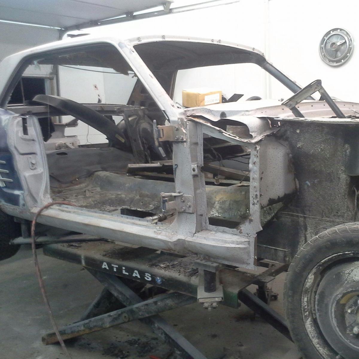

      Well this is my 66coupe build. This is where it started after the first build.

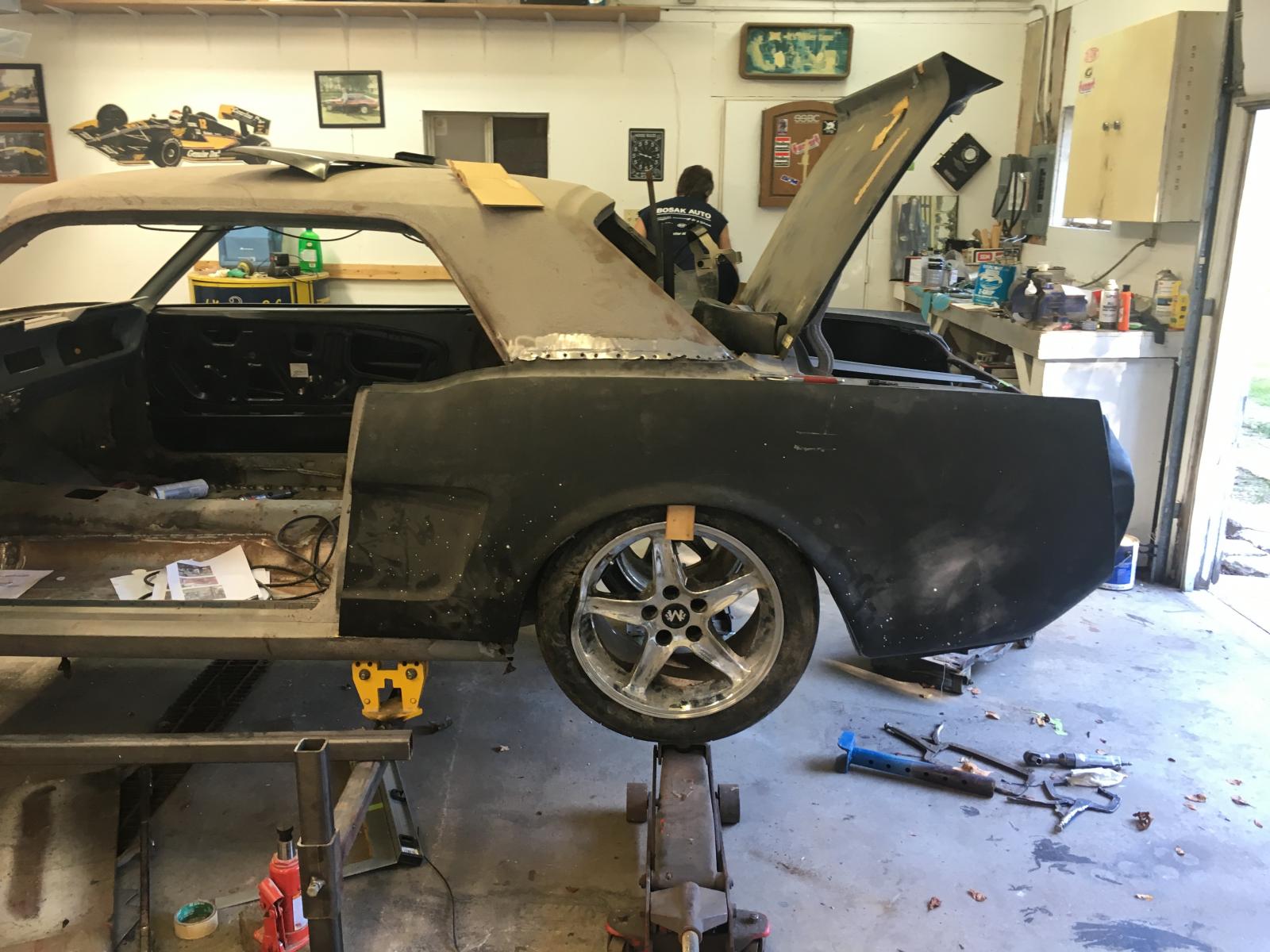

Size:  202.7 KBMini tubs done plenty room for 315 30 19s

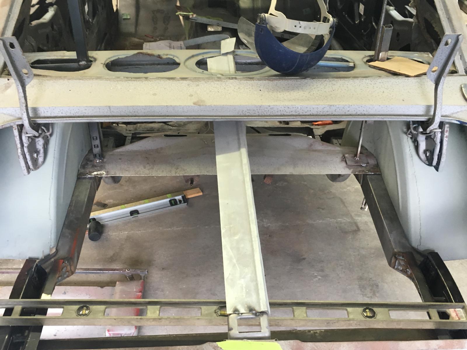

      And hears the 315 from the back w the 4 link brace. 335s would fit but u would have to be dead on w the backspacinv on the rim. It would be tight but will fit

      I did martz rear it's super nice kit. Was gonna do there front but it's more involved and the aje u can fit 9" rims in the front The mini tub is a auto works. W the dse frame insert. W the rolled lip I have 13.5 inches from frame to fender The one pic is 315 35 17 and they fit no prob they are nittos but on the 19s I'm going the proxy 888s
