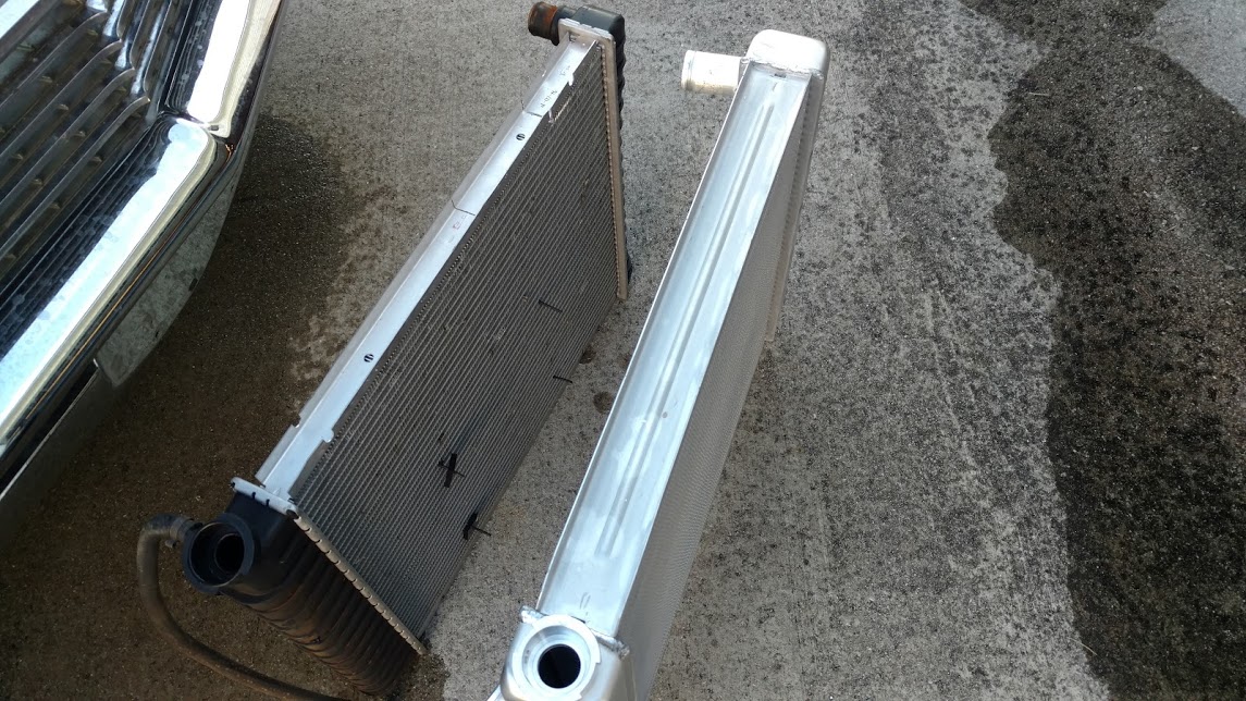

      I have hopefully solved my overheating issue. I picked up this 2 core from the local hot rod shop for $160. Pics show how much larger it is than the one I had in it. The one I took out with the plastic tanks had a leak in the trans cooler anyways.
      I also picked up a BOP TH350 for $25 off of the local craigslist. It needs to be rebuilt but $25 for a core was fair.

      Yeah, that new radiator should do the trick. That's a good buy too.

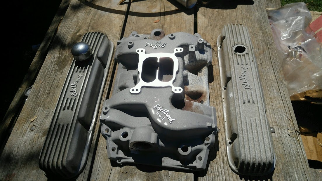

      Was at the local hot rod shop the other day and a guy brought in a Holley 600 vac secondary to trade in. He purchased it off the internet and it was the wrong one. The parts guy whom I've gotten to know better, plus we went to HS together many years ago, asked if I wanted it for $150. Upon inspection it is brand new, never been bolted up.
      Its now sitting on top of an alum intake that I picked up from another board for $100.
      I now have it all installed and the car really likes it. Its not going to win any races but it definitely runs much better. For <$300 including gaskets I have a new carb, alum intake, linkage and breather. Pics to come shortly. I may even drive it to work tomorrow.

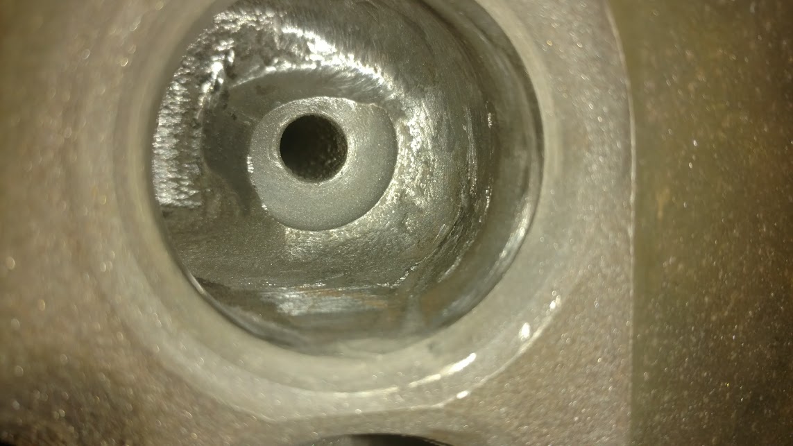

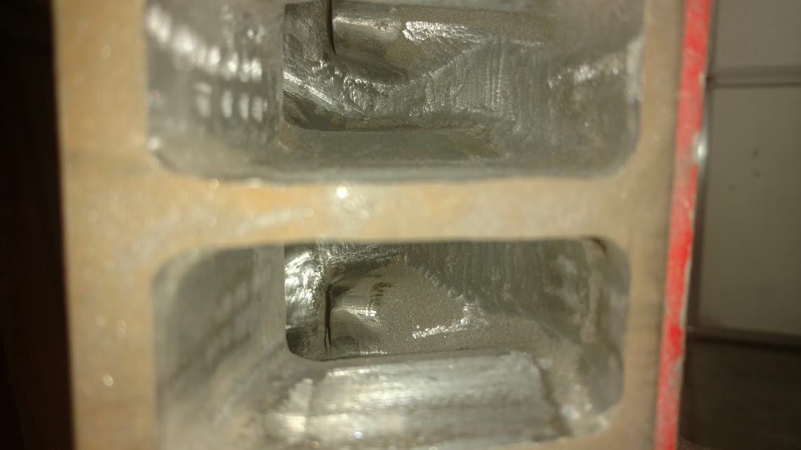

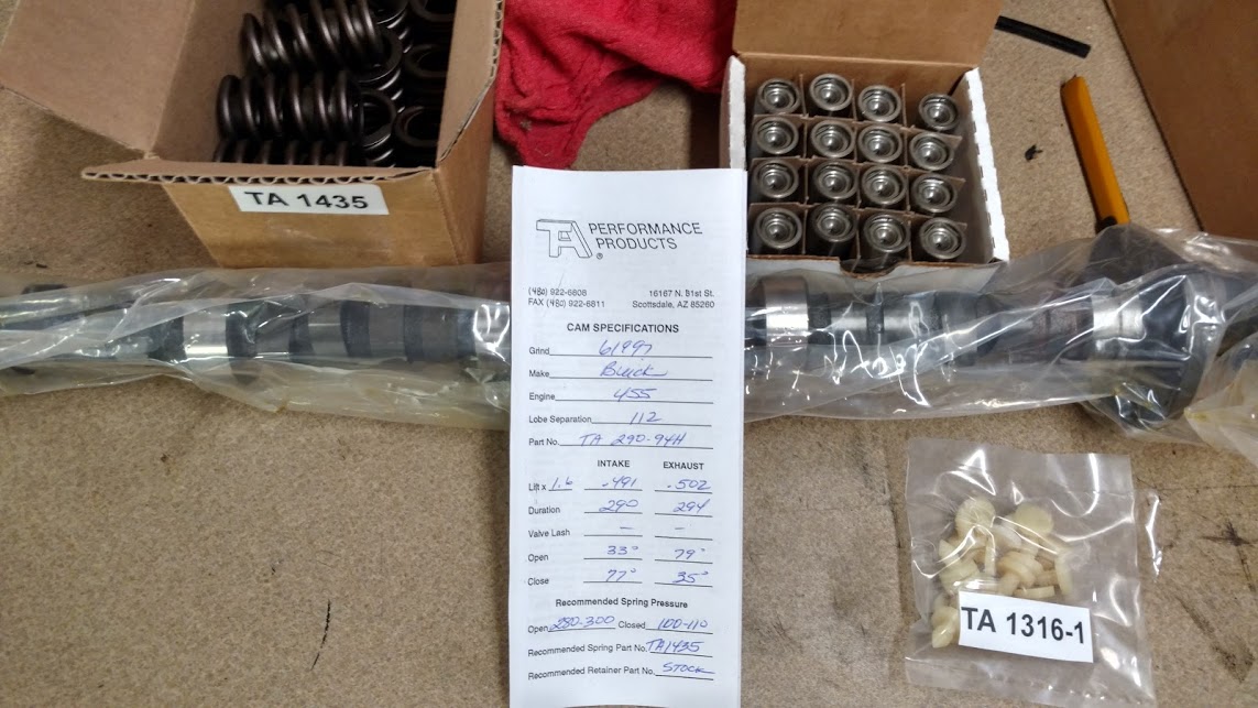

      Been doing some home porting on the big block cylinder heads. They are at the machine shop now and the cam, springs and lifters arrived from TA performance.

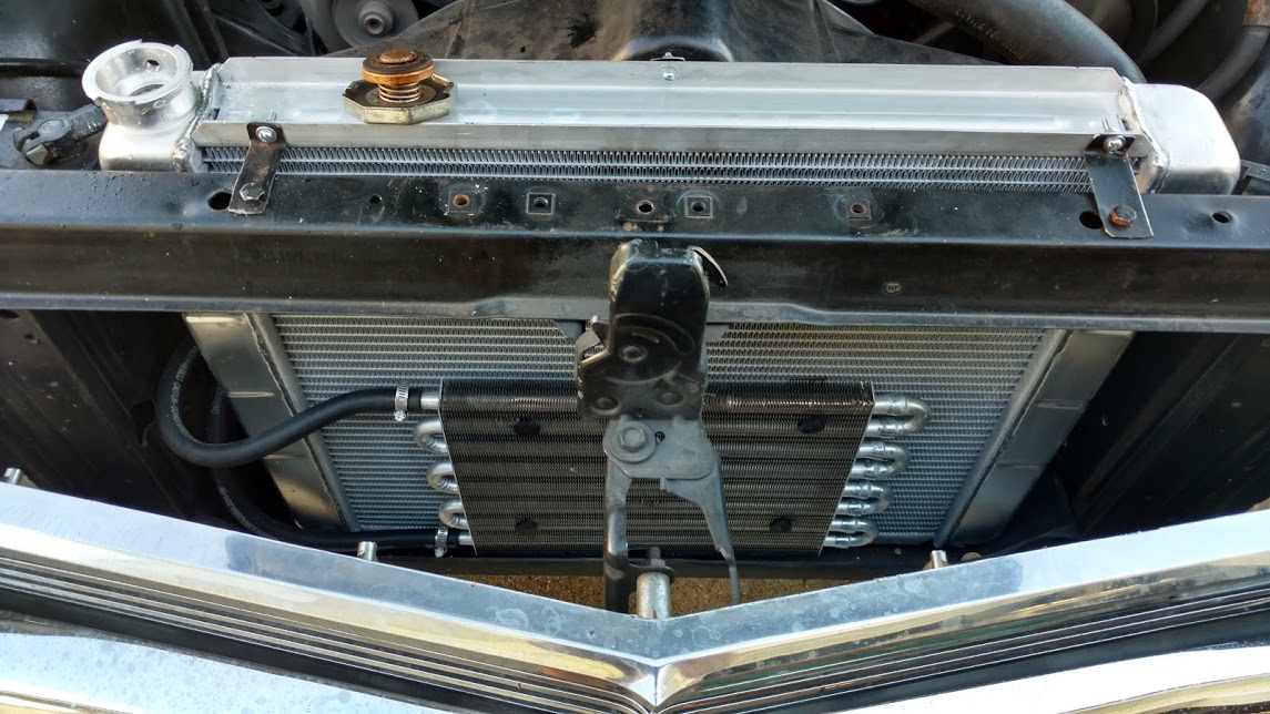

      In the last pic you can see the new PS pump and setup. The close ratio box helps drivability tremendously. The Holley 4bbl and alum intake are running great. I've driven the car to aork a couple times now (40 miles each way). The 2 speed has got to go however.
