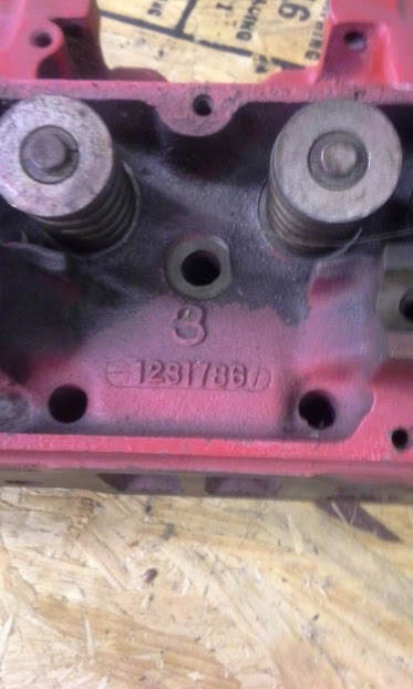

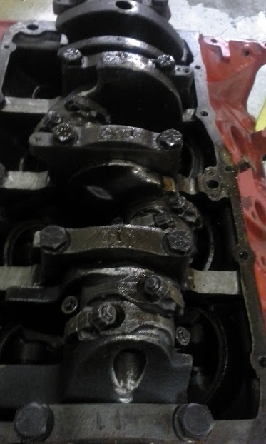

      I said it was going to be a slow build but I did pick up what I hope to be the new power plant.
      I scored a Big Block Buick 455 from a local guy. Its been sitting on his garage floor for the last 15 years. it was supposedly rebuilt when he got it. It appears to some work done but I haven't torn it down yet.
      Its a 70' model with the corresponding 70' heads (non stage 1) that I'll do some home porting on before installing.

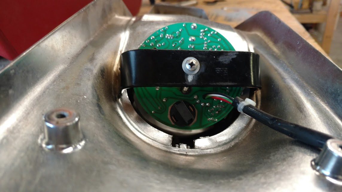

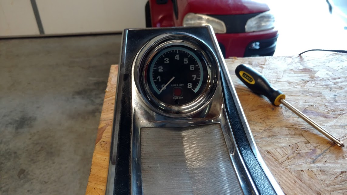

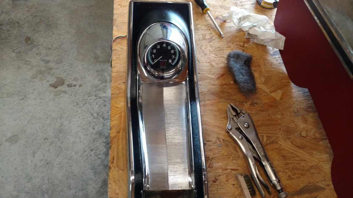

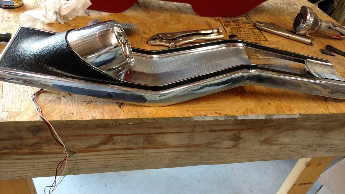

Size:  173.9 KBToday was one step forward, one step back.
      Went to have duals put on but it overheated on the way there. Turned around and drove it home after a brief cooling period and 3 liters of water. I'll get it figured out.
      I did pull the console out and install a new tachometer where the stock (non working) was. I had to disassemble the new one and do a lot of trimming and test fitting but got it to fit. I fastened the assembly to the housing and then made a bracket to hold the entire housing tight to the console.
      While I had it out I used a soft copper wire brush, steel wool, neverdull and elbow grease to clean it. Now I have a working tach w/shift light in a 50 year old console that looks like new money.
      Not complete without pics so...

      I had not cleaned it yet in the 2nd picture so it looks a bit dirty still but y'all get the idea.
      Thanks guys!
