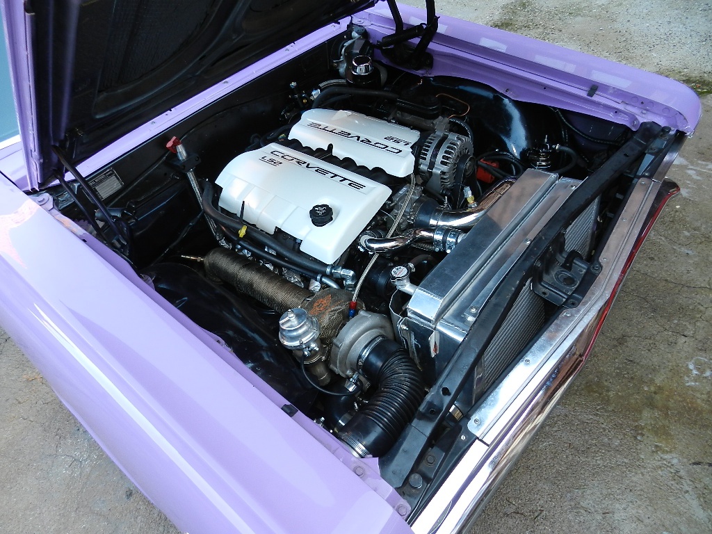

      Here are 2 pictures, the first onein 2WD, the last one at the track. I love the sleeper look of the car. Nobody takes care of me until the launch !!

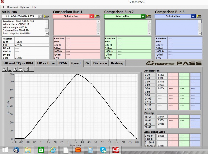

      My best 0-62 mph now is 2.39sec at 32PSI boost in full street trim on 17" wheels, lauching in second gear smoking all 4 of them. I definitely need better tyres

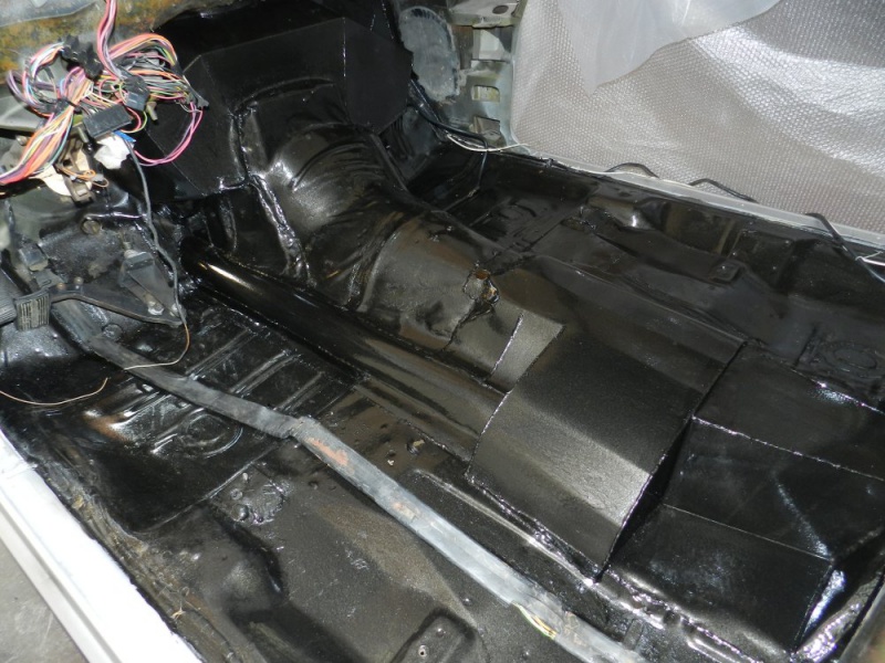

      The floor pan

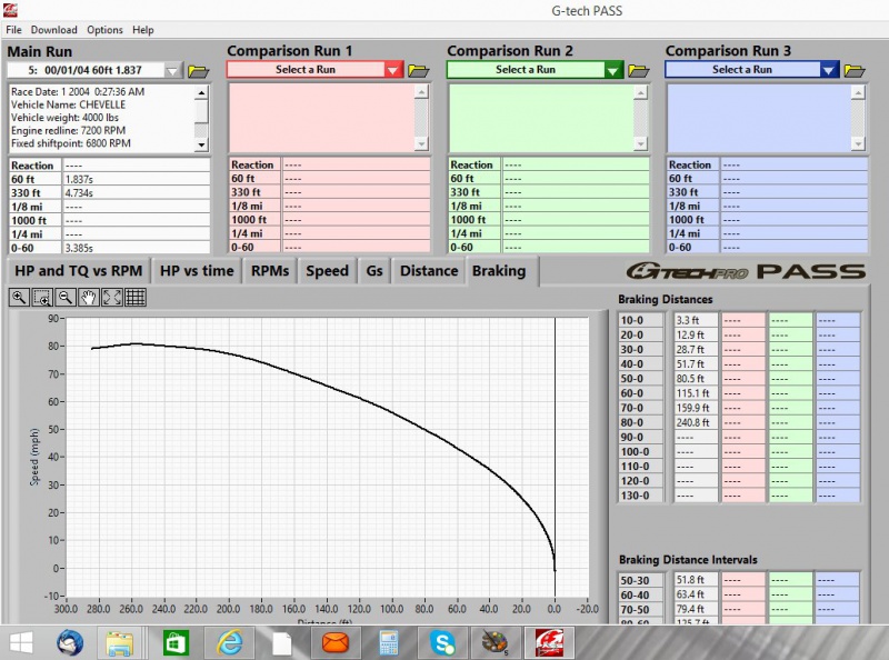

      I perform the 60 to 0 mph braking in 115 ft (according to G-Tec results) with four low cost 11" vented rotors.
      Tyres limit the braking power, but this is not the main concern. A need better endurance for track or mountain roads.
      Here are the passing times on a medium country side road. Acceleration increases with speed

      60 to 0 mph in 115 feet ? I think it's already great numbers...
      I read somewhere Veyron does it arond 100 feet...
      Depends your budget, maybe Baer, Wilwwood or Corvette C4/C5...
      Maybe go 18" wheels , you'll probably have better choices in tires & more clearance for big brakes.

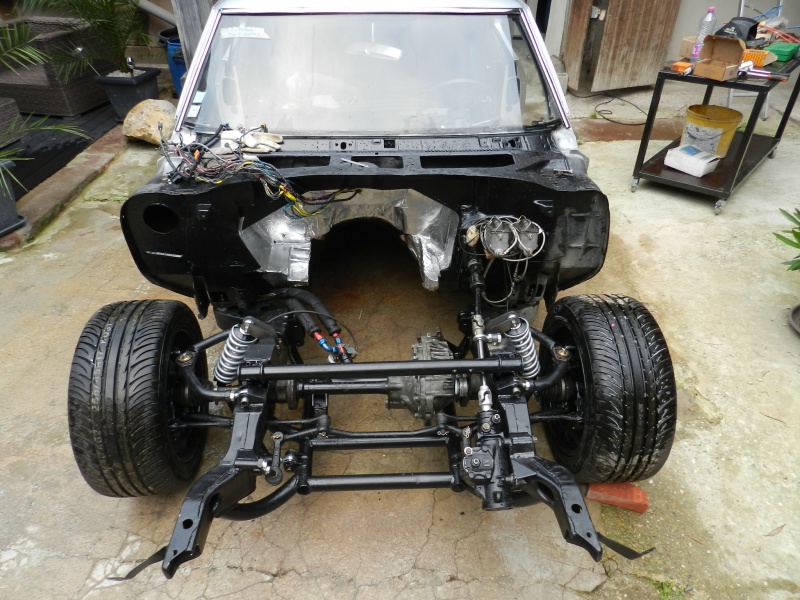

      Here are my last upgrades. 19x10 ET 25 Apex PS7 Wheels. Brakes are BMW M5 E61with 374mm front and 370mm rear.
      Tyres are Kumho Le Sport 285/35/19
      Handling seems to be very very good. I will perform some braking and lateral acceleration tests to confirm this feeling.
      QA1 in the front with 650lbs springs
      QA1 in the rear with 400 lbs springs
      Stiff front sway bare, none in the rear.
