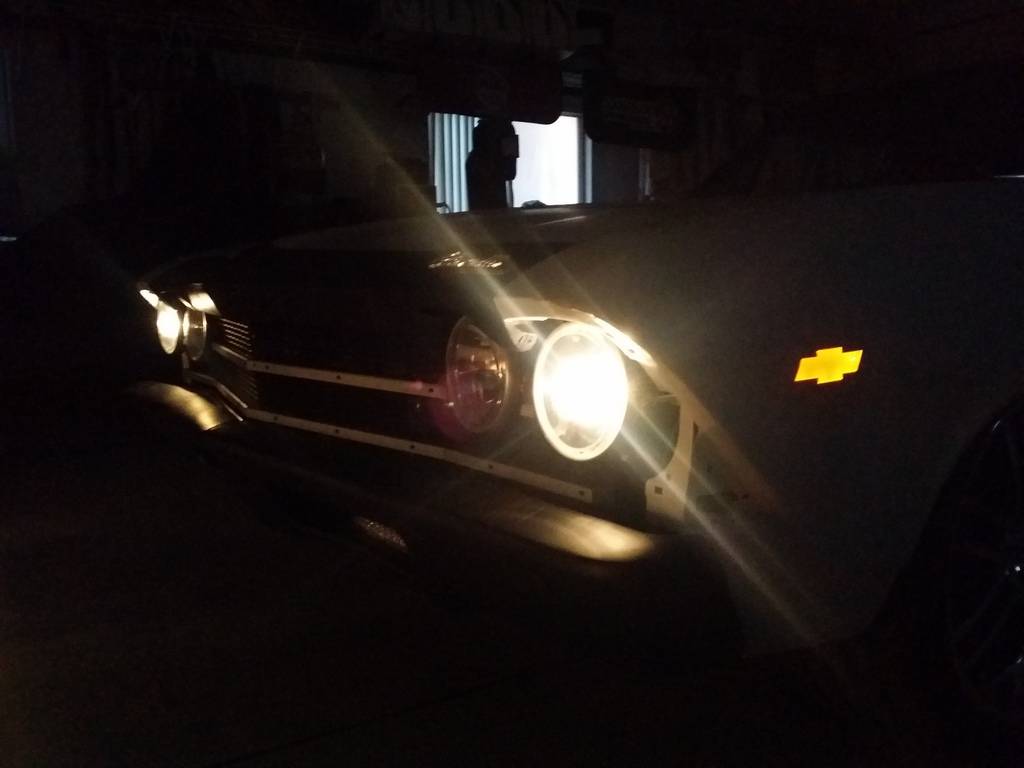

      Two pictures from 2006 when I installed the lights. First is the park light option, if you look closely you can tell the light source is coming from the bottom of the headlight. This is for situations like a parking lot at night where you don't necessarily need the headlights to see, just so others can see you. And you don't blind other drivers or pedestrians in the parking lot.

      This second picture is with the brights on... not that this tells you anything really.

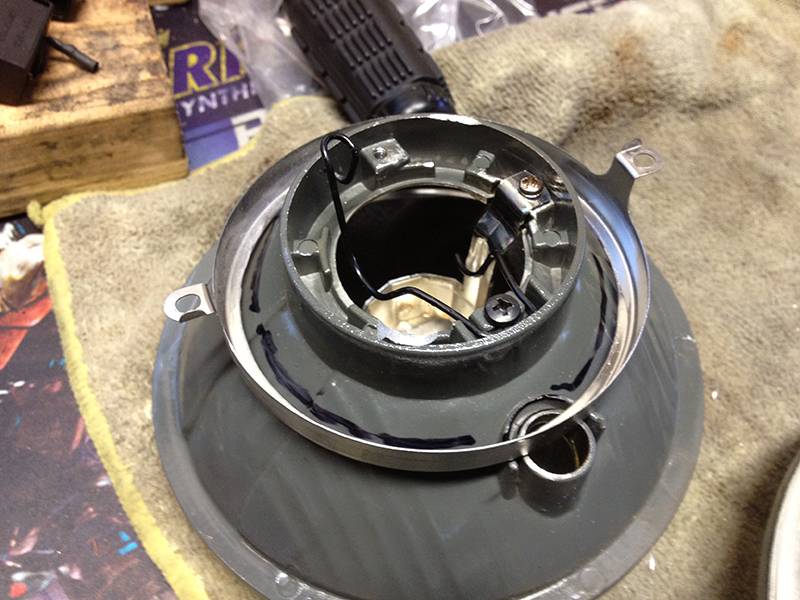

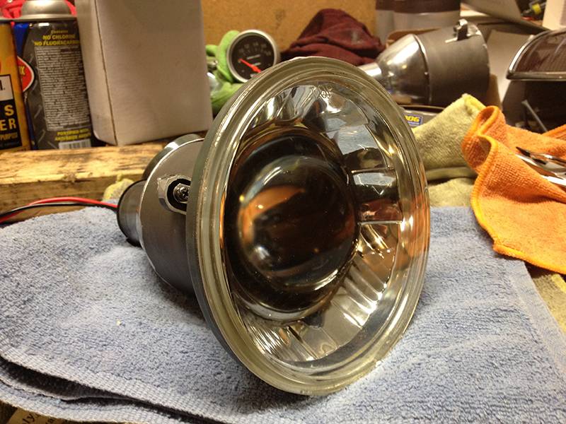

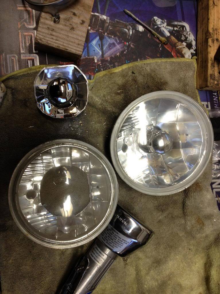

      For my Jag I used aftermarket H4 lamps, cut the back off, and epoxied in projectors from a Lexus.
      Full write up here (scroll down).
      Here's a couple pics mocking them up; the finish product turned out nice, the only drawback was using the clunky older projectors but they were cheap. In hindsight I may have just used some E30 Elipsoid projectors, but I like the look of these a little better. I have since upgraded the projectors to Acura units that look (and work) better than the monster in these pics.
