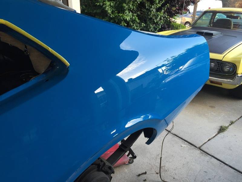

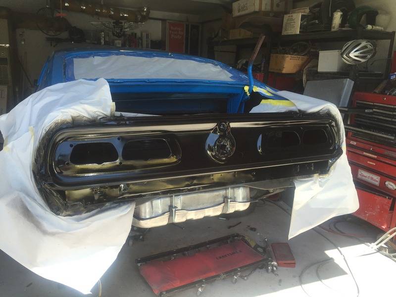

      A little cut and buff with meguiars 105, then 205 after being dry sanded with 1500, 2000, 3000 novax abrasives
      - - - Updated - - -
      Tail panel painted satin black
      5,560
      Wow looking Sweet! The whole car looks great. I like the way the trunk came out.

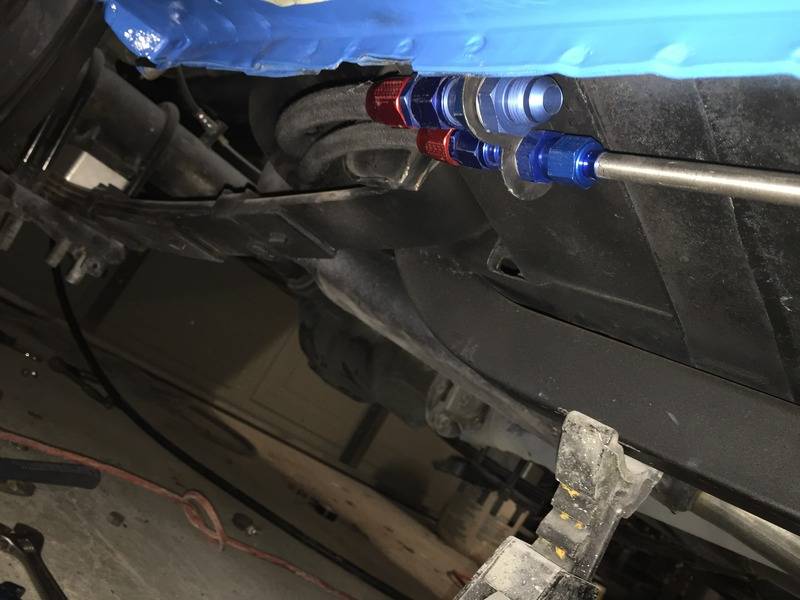

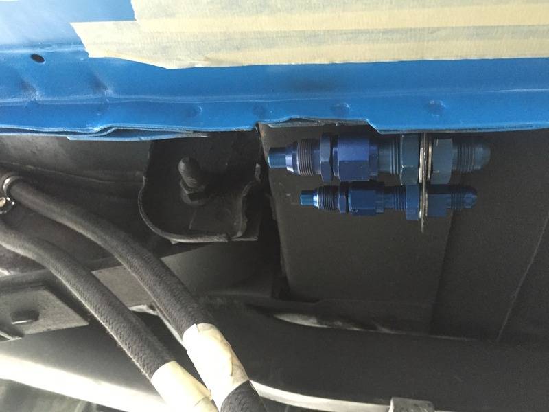

      Ordered the remainding AN fittings and hose to finish up my fuel system. I forgot how expensive it was. I went aeroquip startlite and black aeroquip fittings in the engine compartment and the classic red/blue underneath the body.
      Made a little bracket from 2 body washers to hold my bulkheads.
      The startlite stuff is so easy to work with. No more chewed up fingers from the stainless crap.

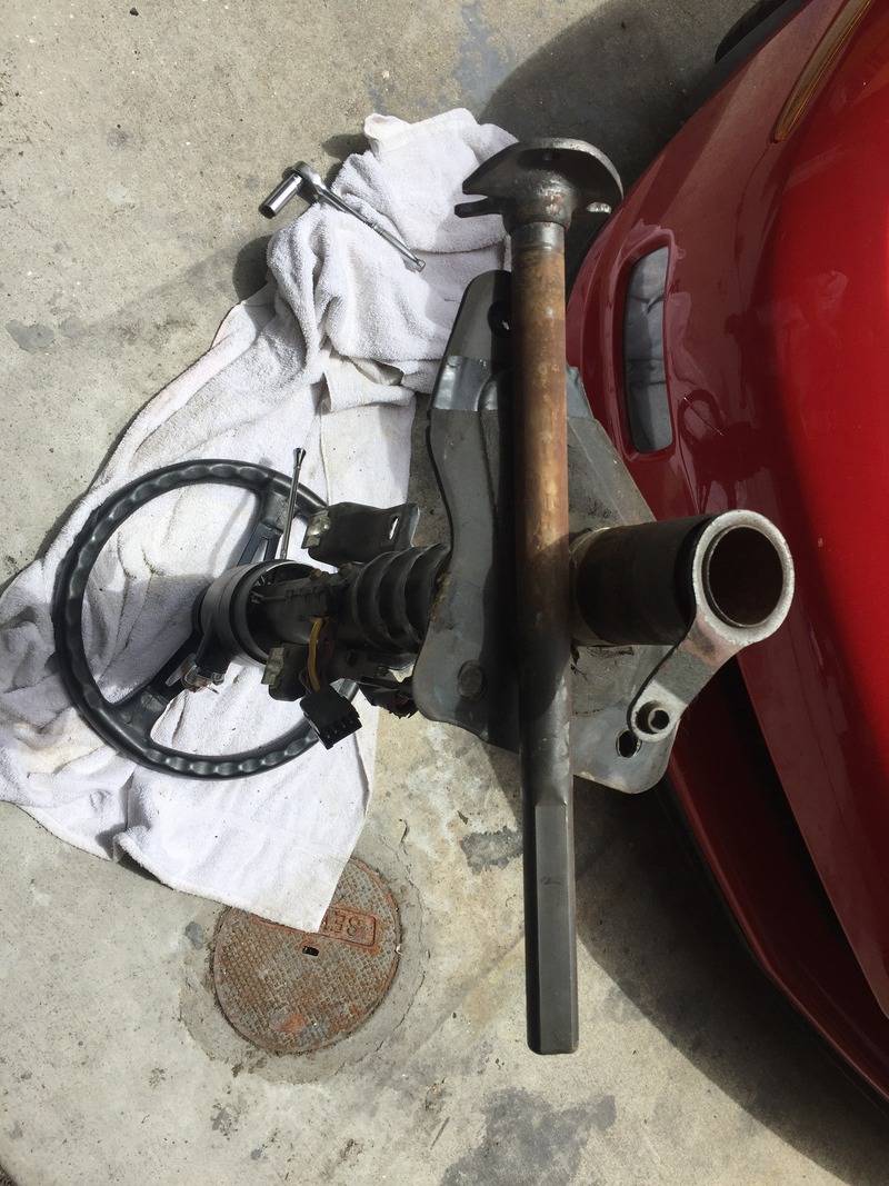

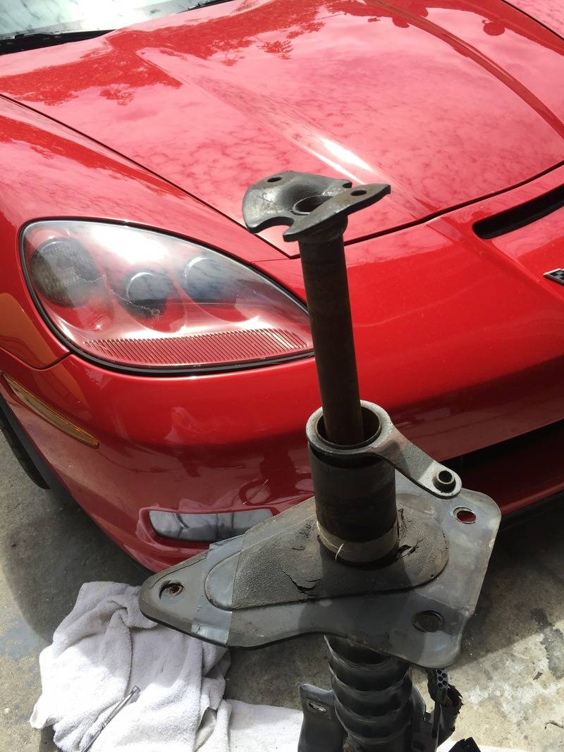

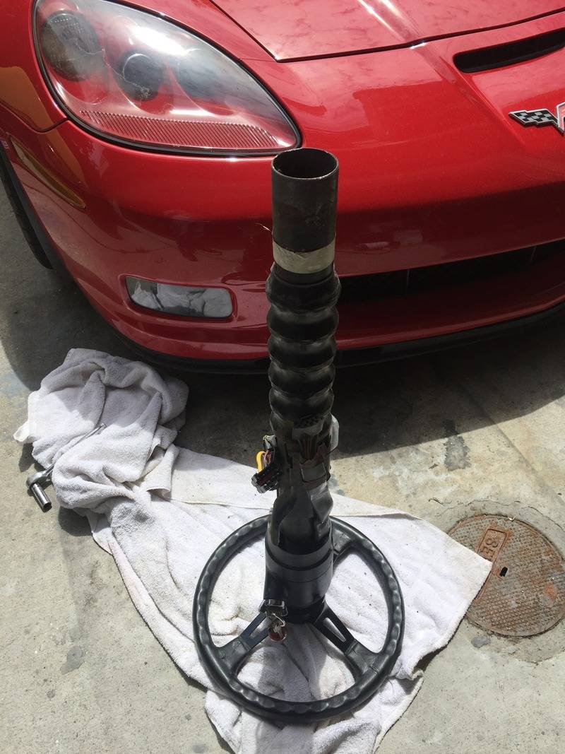

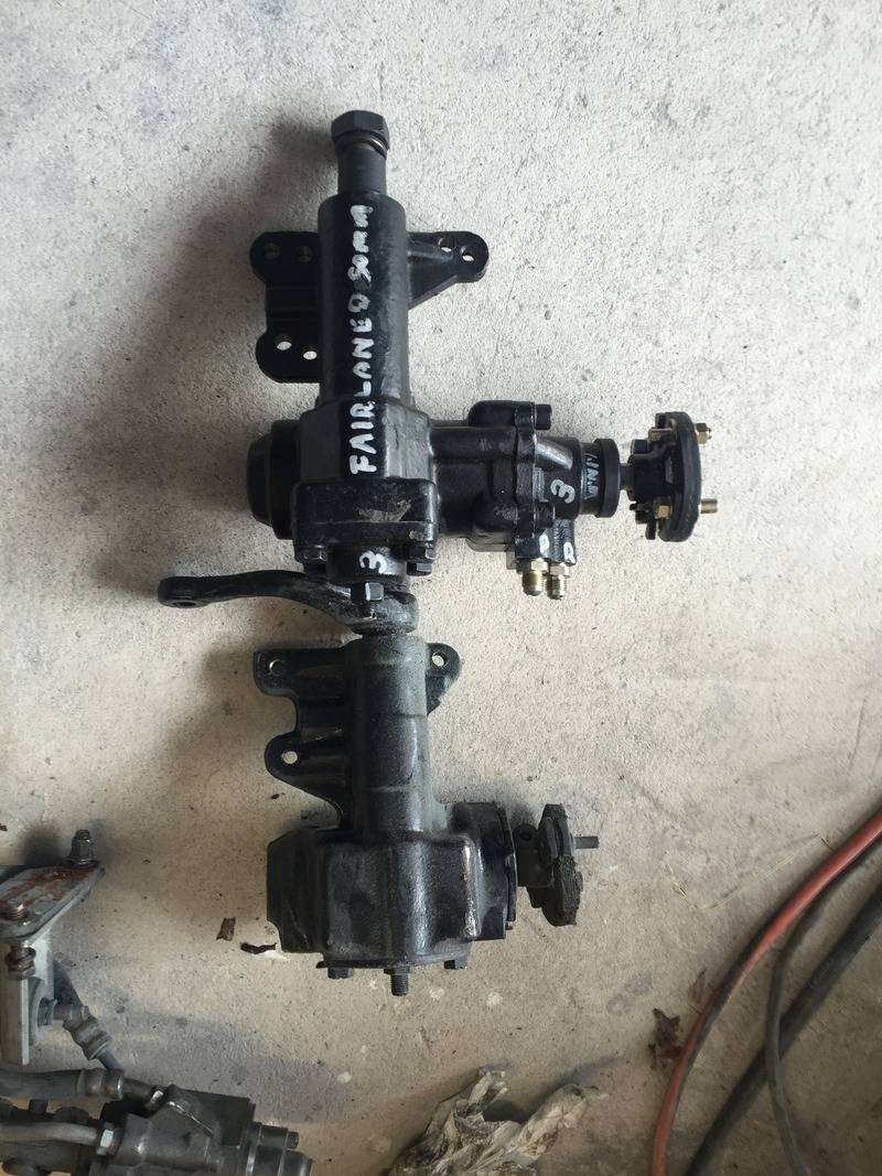

      The new box is a couple inches longer to the column than the old one.
      The column was disassembled and an inch was taken out of the outer tube.
      Everything was put back together and re-installed.

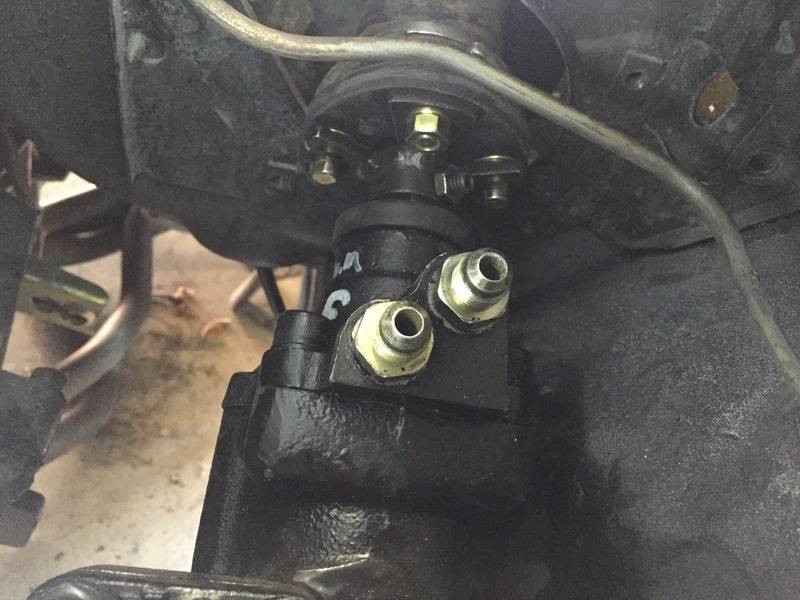

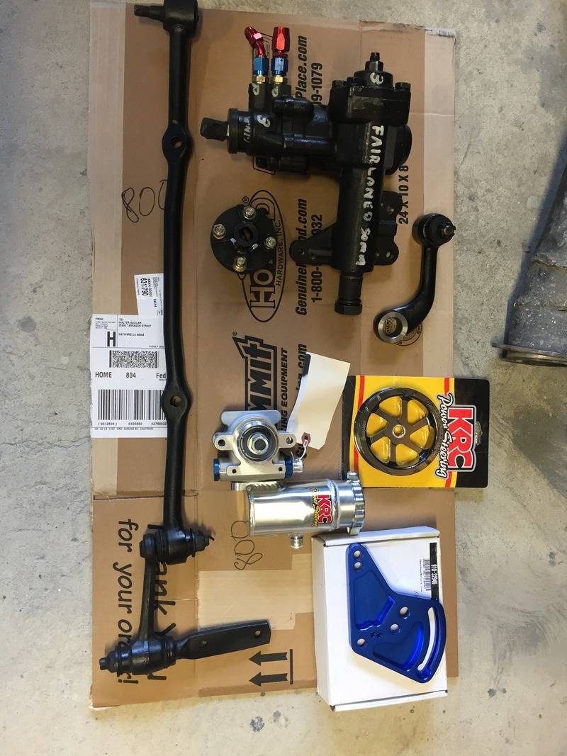

      Finished up my fuel system and moved on to the steering, since the headers had to come off for the o2 sensor I figured now would be a good time to change the box. ABS integral steering box and KRC aluminum pump.
