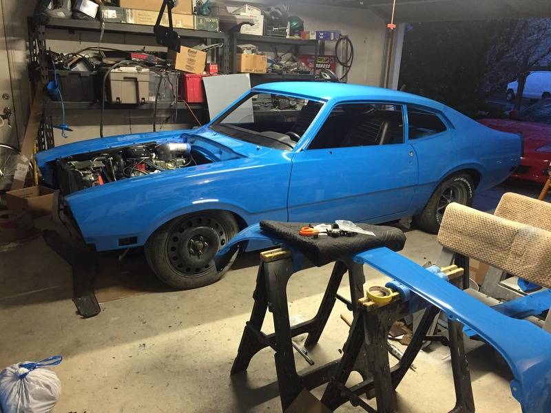

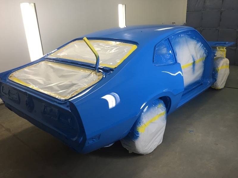

      A little grabber blue in bc/cc with SPI clear. Fenders, doors and hood still need to be shot.

      Quote Originally Posted by 7d1 Comet View Post
      Looks great. You can never go wrong with Grabber Blue I say. The hood scoop and trunk will look sano...

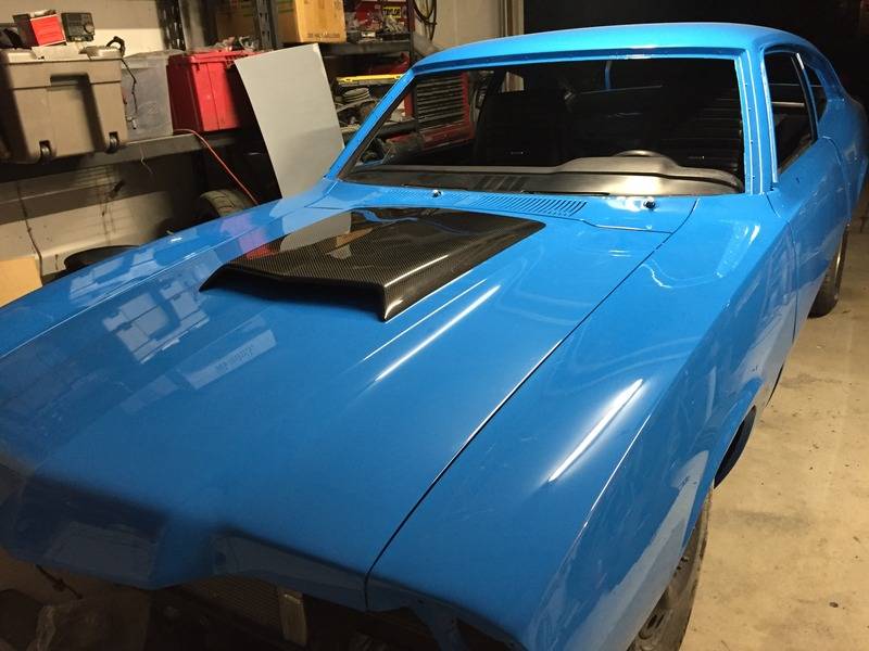

      After letting the paint cure for 3 weeks panels started making their way on.
      My DD in the background, 08 Z06

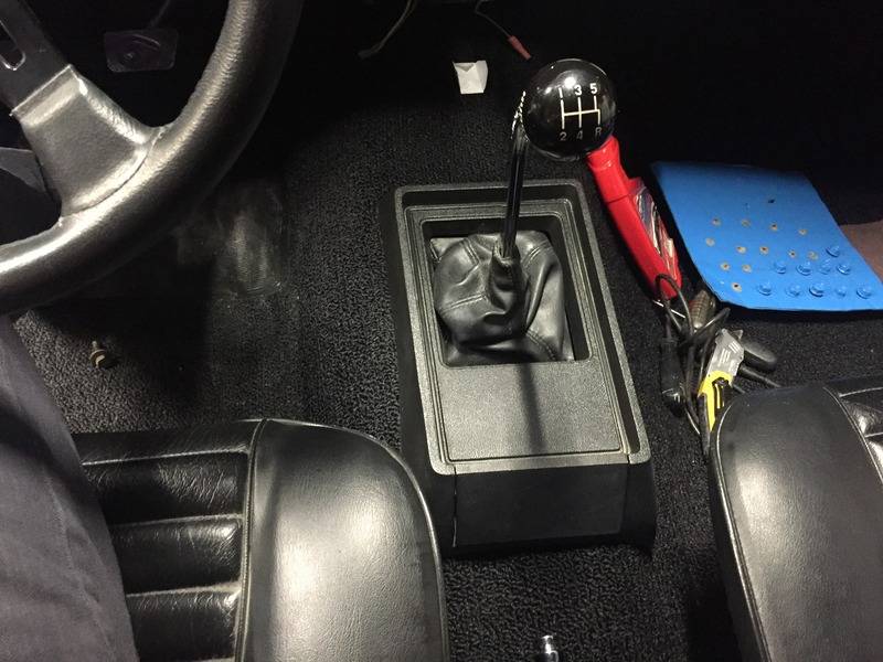

      Using an early 70's mustang mini console.

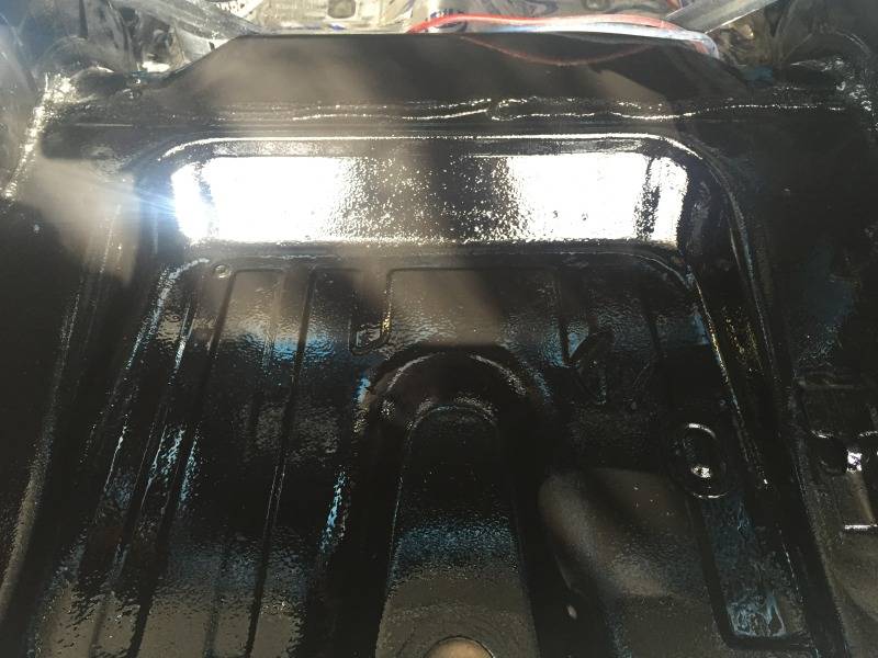

      Herculiner rolled on and sprayed with black and gray spatter paint on top. Make sure you use a coat of clear on top of the spatter paint or it will easily blister with a little water. It was done before the base was shot.

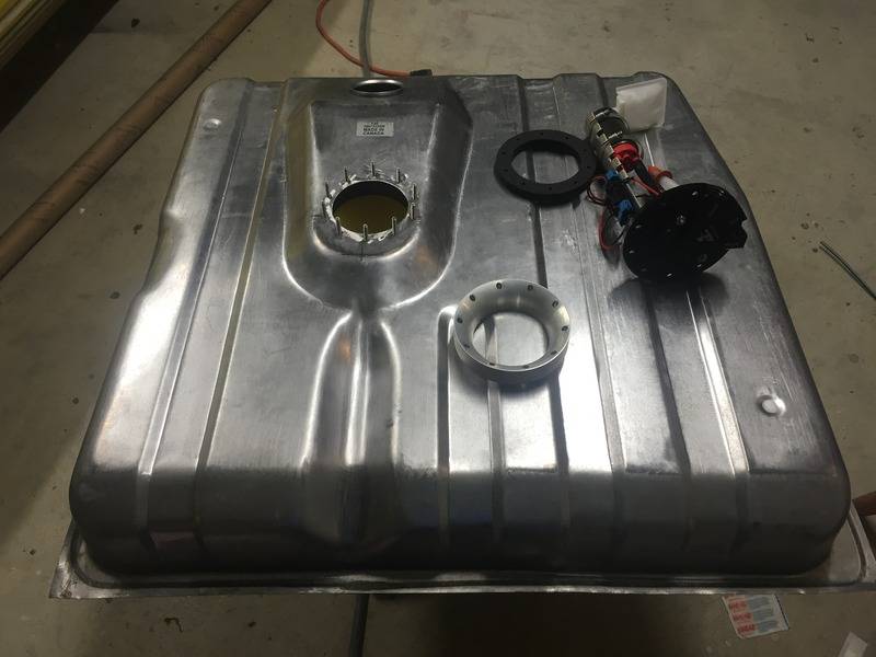

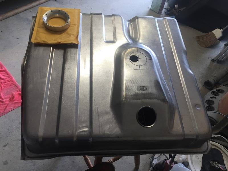

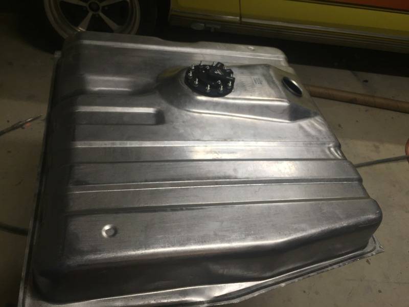

      Ordered a Fitech EFI and setup my new tank for an aeromotive phantom 340 intank.

      Sweet! Have you put the tank in place, does the pump clear the floor? I'm ordering my FI Tech hopefully next week.

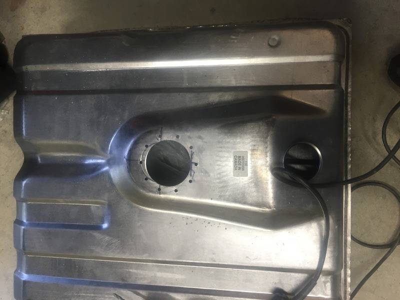

      Hey Dave I haven't installed the tank yet but it looks very close. I'm thinking of getting some flat stock and welding them to the tank as spacers to give me a little extra room so the lines don't get pinched. I won't run the tank until my Fitech setup comes in at the end of the month.
      Thanks! I guess you could always modify the trunk floor, but it would suck now that you painted it.

      Quote Originally Posted by Dave B View Post
      Trunk is staying put unless mini tubs make their way on. I test fit the tank and didn't get any rubbing. It still looks like a really tight fit. I was going to weld 1/2 inch tabs to add a little extra space but I found some dried out inner fender rubber weather strip and cut it in half then glued it to the tank. Looks better than it sounds. With the 76 tank all you need is longer carriage bolts and it bolts up just fine.

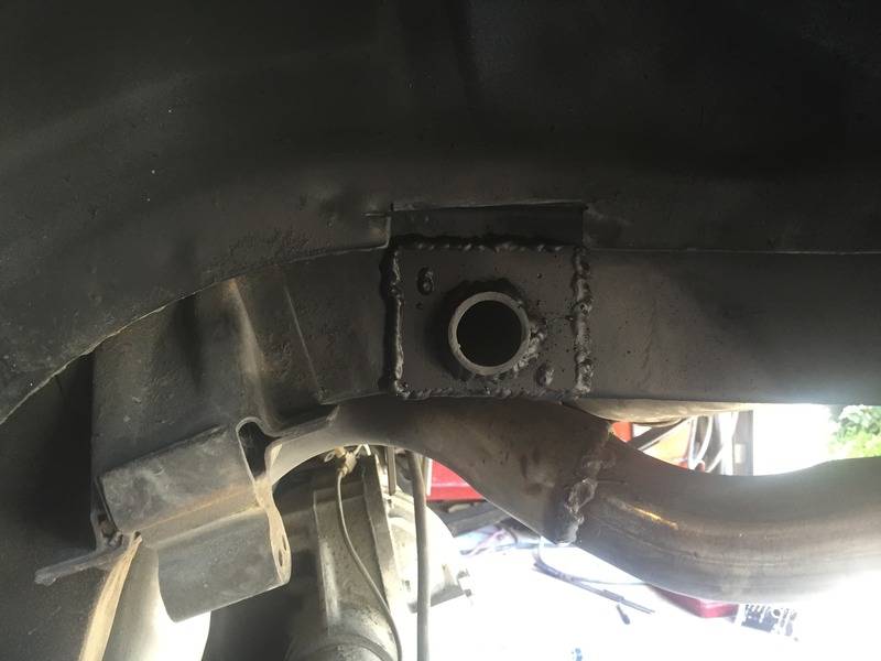

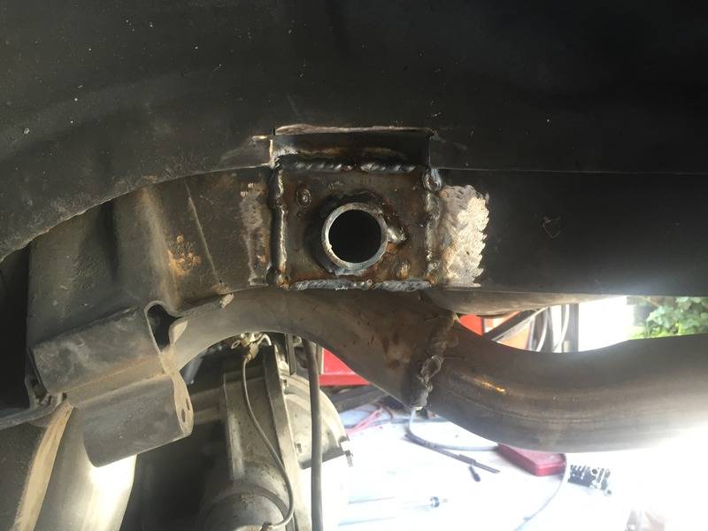

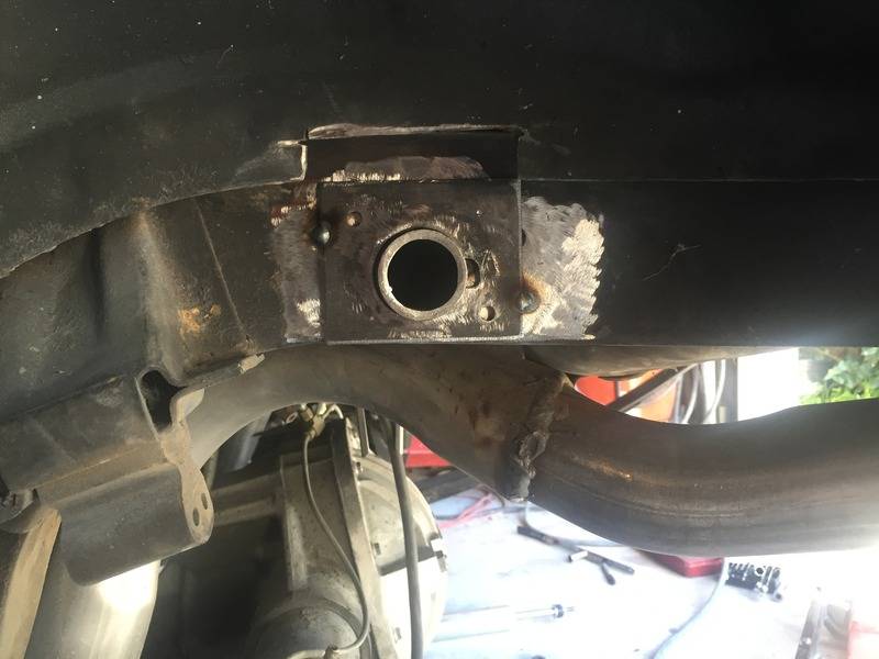

      Burned a little metal and setup my shock mounts. Not the prettiest welds but should hold up to any abuse.

      Looking good! I wish I was that far along with mine.
