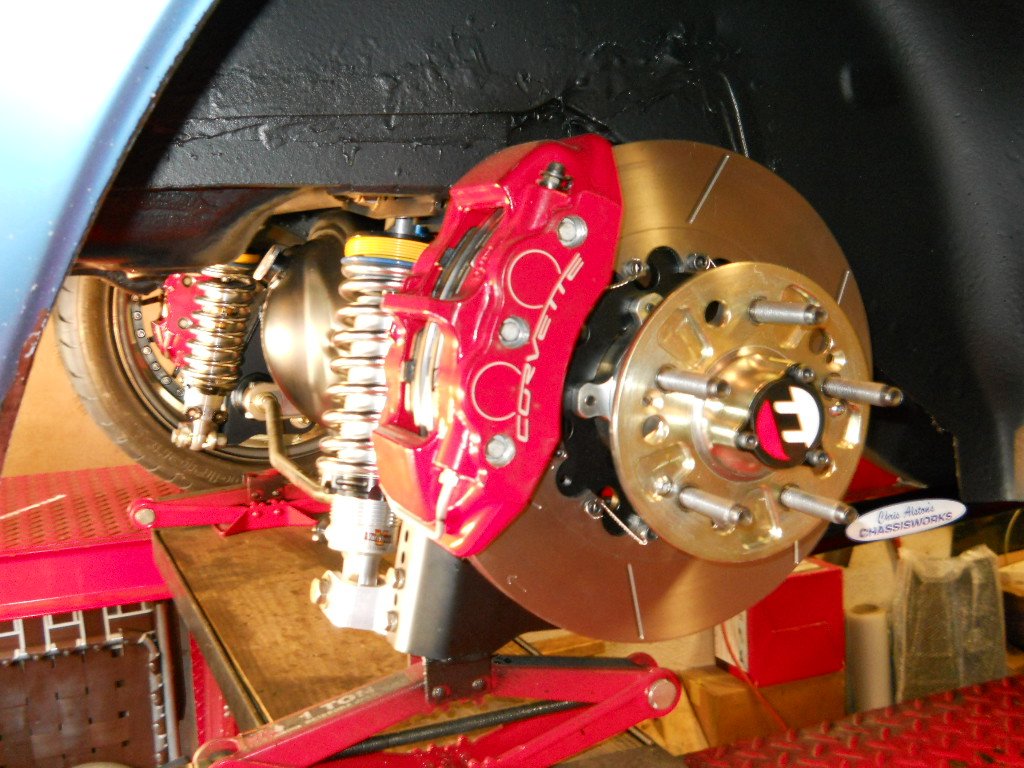

      You can go as little as 3" or so. The caliper mounts either front or rear, so not really an issue with wheel well. If your using a separate e-brake caliper, then you'll have an issue. Here is how mine is set up. Brakes in the air for cooling and rear narrow to loose weight.

      Thanks for the pic! It looks pretty cool, but now that's making me think about another factor... the ridetech 4 link! The coilovers in the Cuda look to be inboard a bit. The ridetech lower mounts look to be a little more outboard, and not too far from the backing plate, basically inline with where the factor leaf is now. I'm not as much worried about the wheel with the Ridetech suspension, but if I go with too small of a backspace with the floater rear, I'm worried I might run into issues with the brake to coilover clearance, if I go with too narrow of a rearend. So maybe I'll have to go with a 6" backspace like I thought, instead of too deep. If I compare to the 18x9.5 (5" BS) Boss 338's I had before, that would mean my new rearend would be 1.5" (2.0" to be safe) narrower per side. Guessing I'll need to do some more investigating and try Speedway again, knowing that exact brake offset would be nice.

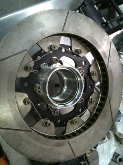

      Floater hubs are pretty much standard for brake mounting. This is how it would mount in relation to the hub:
      If you know how far back on the hub the mount is, the brake adapter to rotor plate is 5/16" thick. This distance will be how far the rotor mounts behind the hub mounts, if that makes since. That should let you calculate where the calipers will be.
      You rotor will mount to the rear of the hubs:
      BTW, if you haven't got them, my rear brakes are for sale. New, just mockup. GT 48 rotors.

      Wow, thank you for those pictures Craig, it's definitely the most I've seen of the floater hub assembly, still a new thing for me! And pretty close on my assumptions, add in the 5/16" mount plate, then my rotor would still be within 0.375" of the wheel, roughly. Now if only Speedway would answer their phones, I'd be golden! I'd imagine that they are probably at PRI this week though.
      And I haven't bought my brakes yet, those look similar to what I want to run. Those the 12.19", or 12.88"? I'm still a ways away unfortunately, I'm scrambling as it is to get my wheels, minitubs, and rearend ordered near the same time.

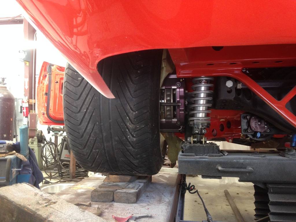

      Not sure what happened with my post above, my floater pic did not display so I went back and fixed the link, seems to be working now. I have my brakes clocked at approximately 2oclock to the rear looking from the driver side. In this position the inboard side of the calipers clear the frame rails by 7/8" per side but I have been told the C6Z06 calipers are a little wider than most. When ordering the rear end I would have the suspension brackets all welded on because they need to be in known specific locations. But I think I would prefer to leave the caliper mounts off until I had the rear end actually installed in the car so you can determine the best location for your build. Just keeps your brake mounting options open.

      Thanks for the pic Steve. It looks like the 1st gen minitub pretty much fits flush against the frame rails, from everything I've seen the 2nd gens don't seem to be the same way, it looks like there's 1.5-2.0" between the rails and the tubs, but that's only an estimate. I'll find out soon enough! No matter what, with the little caliper protrusion I have, nothing is impossible to fix, though I don't believe it to be an issue.
