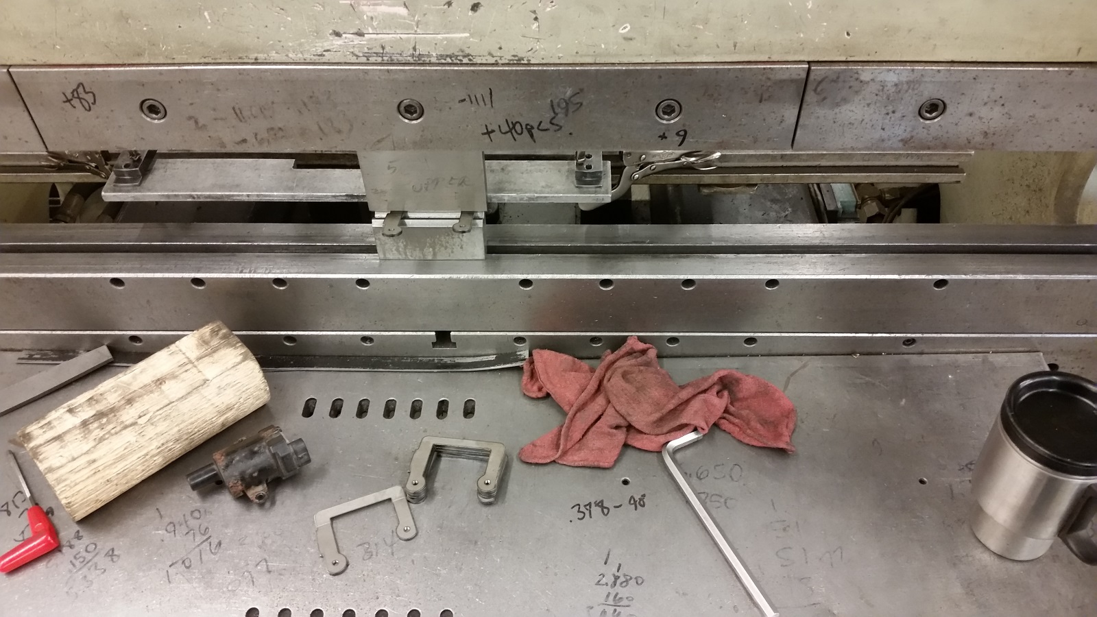

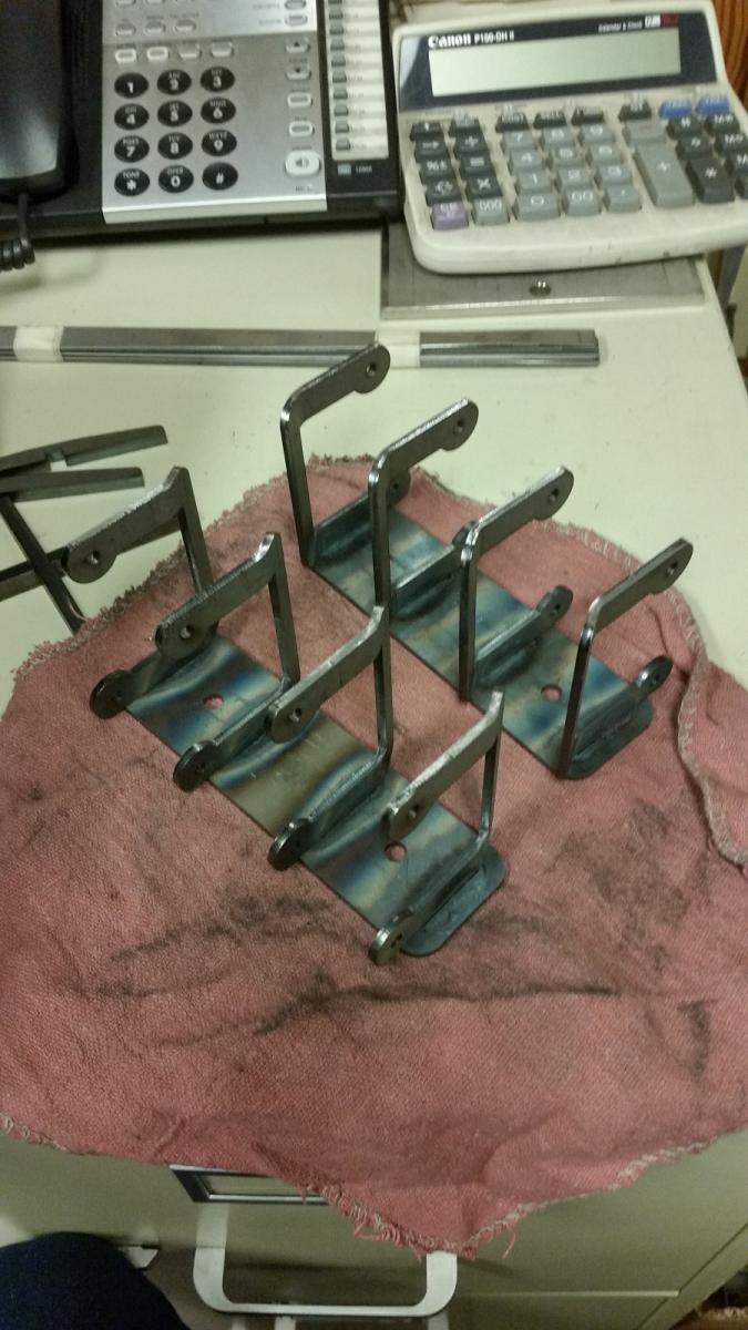

      Been working on my coil pack relocation, not too sure where I'm mounting these just yet. Probably just make some weld bungs to mount to the firewall behind the engine or down low out of sight.
