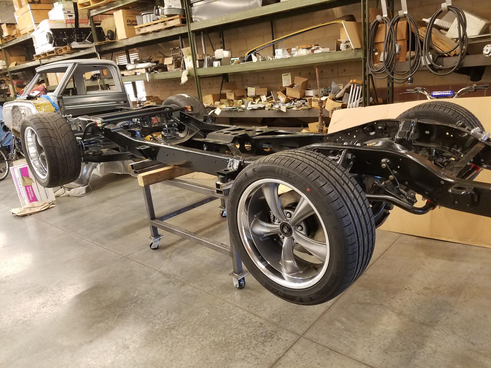

      I kind of let this die but there isn't enough traffic in the truck forum so im updating it lol. Alot of progress has been made on the truck and it has changed directions a few times.
      The big block is out and its getting a lq9 with a small cam and t56.
      I have alot more pics to upload later today.
      Nov 2015
      St. Louis
      18
      Heres some more pics.

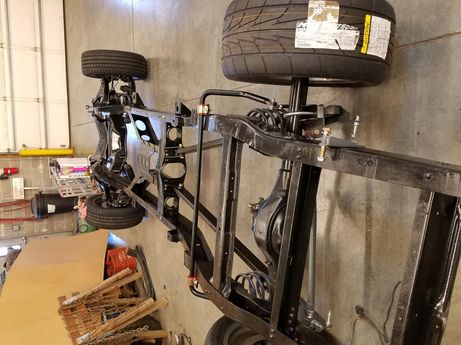

      nolimit front and rear sway bars
      nolimit rear shock relocaters
      I built a nolimit inspired center brace but I feel like it needs more maybe in the rear section.
      9 inch rear with a yukon third member, detroit tru trac dif with 3.50 gears.
      AGR steering box.
      I relocated the lower ball joints 1 inch forward and outward .250" but I failed to get any good pics of the work..
      What are some good tie rod adjusters?

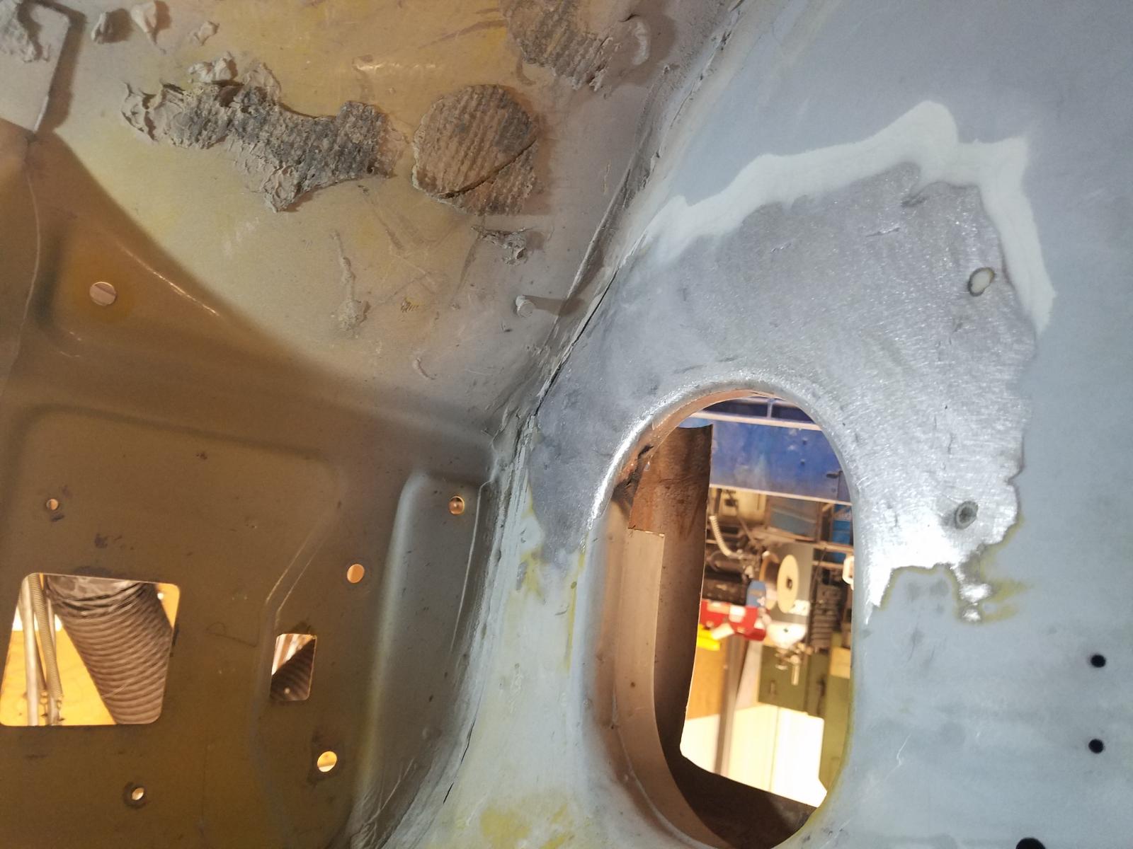

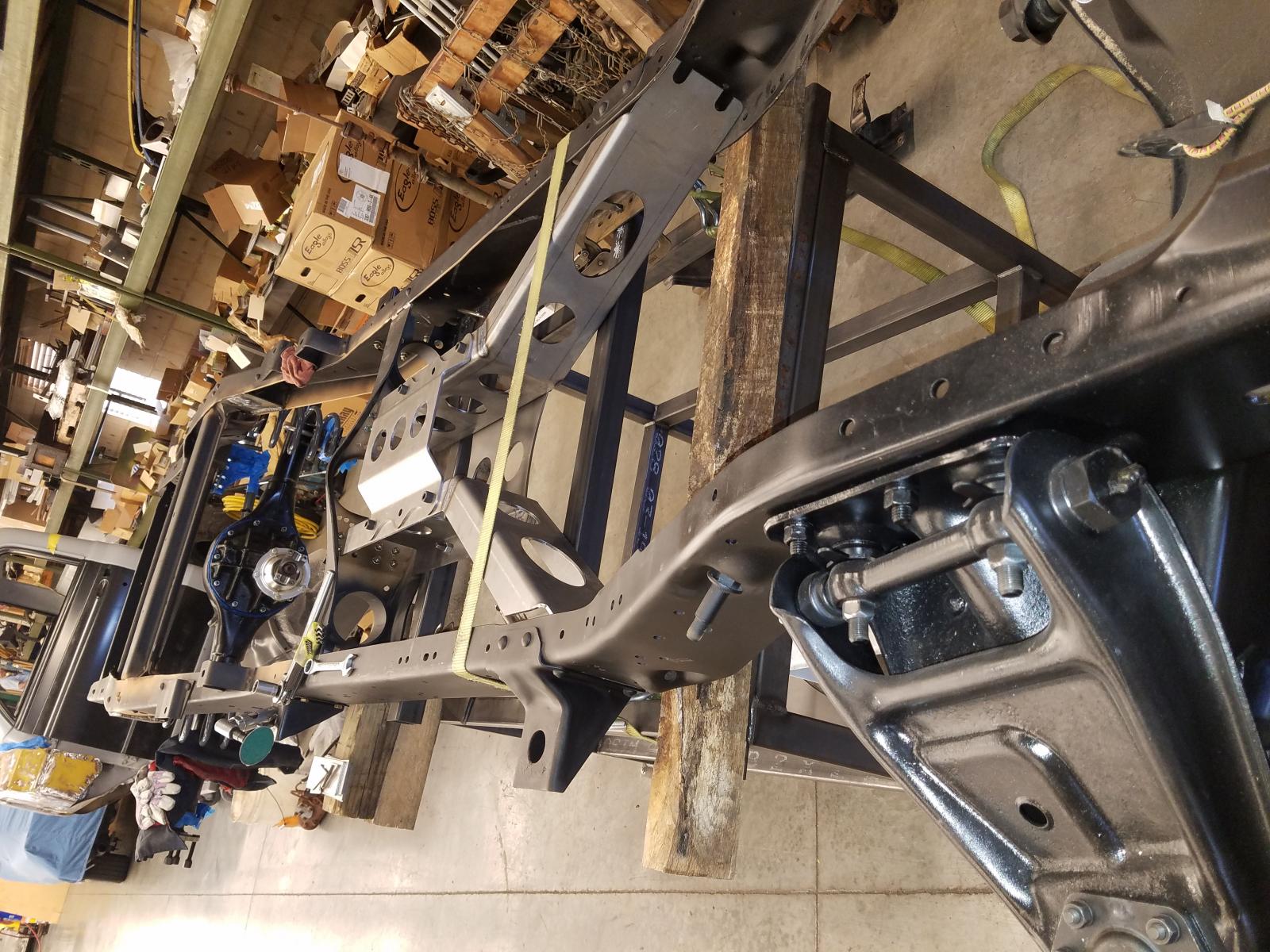

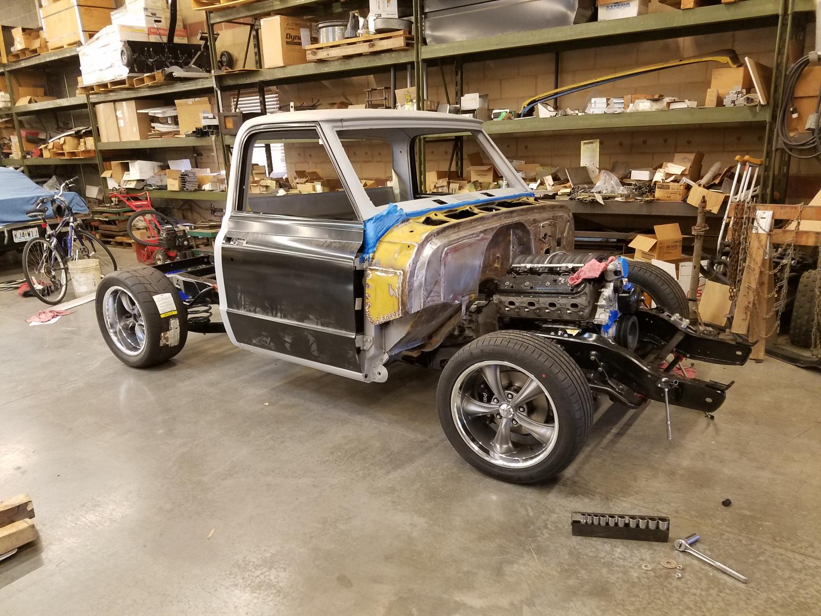

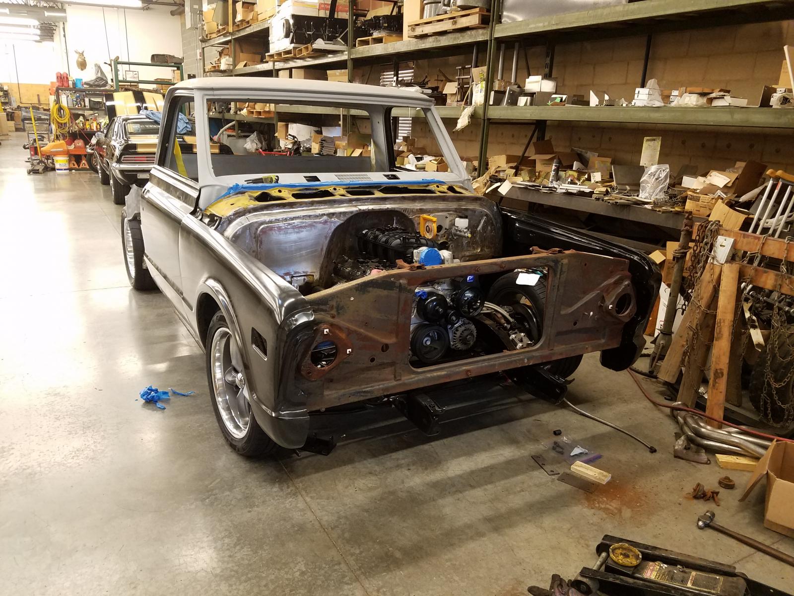

Size:  300.3 KBName:  20180713_142530.jpg
Size:  298.7 KBName:  20180713_140015.jpg
Size:  340.1 KBName:  20180711_122701.jpg
Size:  279.7 KBName:  20180803_150848.jpg
Size:  249.0 KBName:  20180810_145934.jpg
Size:  298.4 KBName:  20180810_150603.jpg
Size:  265.6 KBName:  20180810_150935.jpg

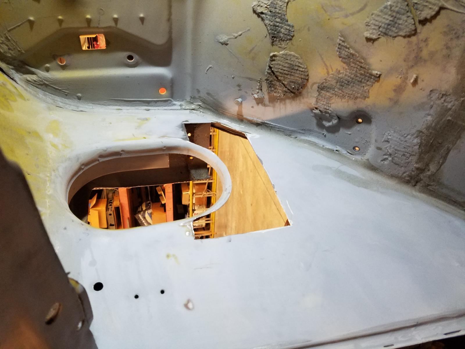

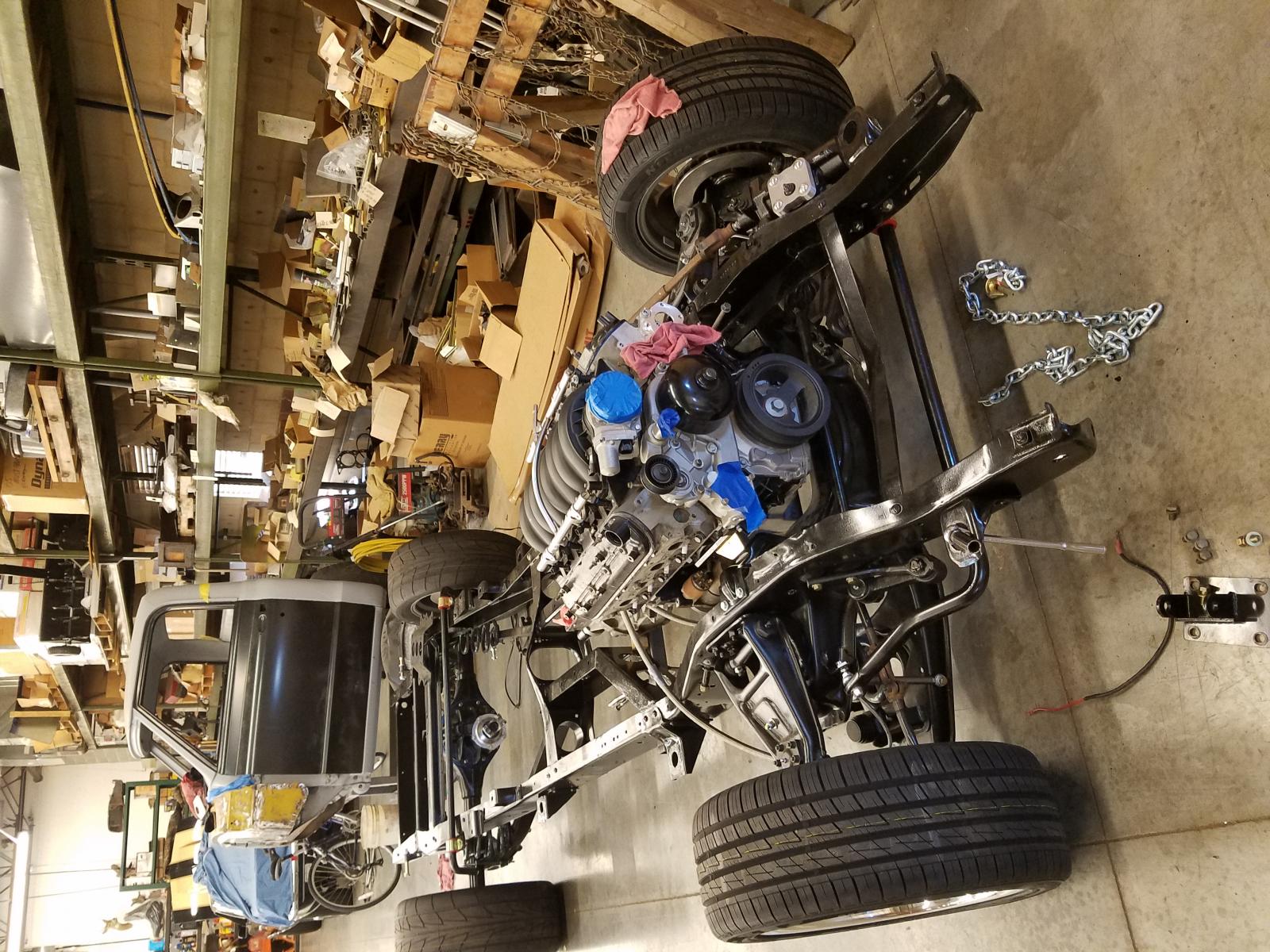

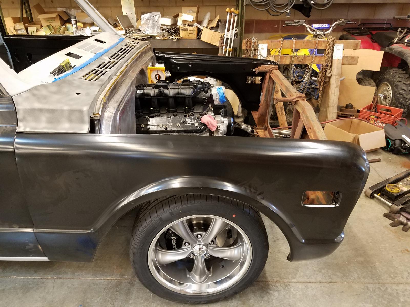

      Got the cab on, engine and trans in and starting mocking up everything. I had to fab my own engine mounts because I think I have the wrong perches for the adapter plates I bought, so I set it as far down and back as I could..Might still have some header clearance problems but they are minor. Then I decided to throw some body panels on for a glam shot just for a little motivation. Ad sorry for the rotated pics I still dont know why thats happening. And dont mind my messy shop lol

      Still sits like a 4x4 imo.. in the future I might build a drop member for it and 3 link rear suspension with coil overs.
      Aug 2010
      Los Angeles
      721
      What headers are you using? And how do they fit? Any mods to the frame?
