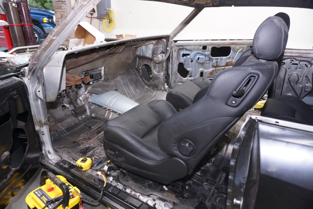

      Test Fitting the seats to find out where they need to be placed for me and the height. The front seats need to come down a bit and the rear seats need to come down a lot on the back rests. The seats (front and rear) are super comfy though, they are from a 2006 GTO.

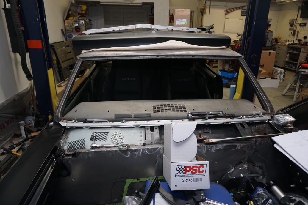

      Jeff has started finish welding the body on the chevelle and making some brackets for the firewall. Which included the cut out to make clearance for the high pressure pump on the LT4

      Here is a video of Jeff continuing on the Firewall doing some metal shrinking:

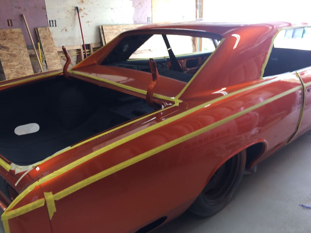

      We ended up going ahead with it, he installed the 3 inch exhaust to the tips, then covered the 3 inch pipe with a 4 inch pipe. The inside of the trunk he made the compartments you see to enclose the whole thing from the trunk area.

      Jeff continued to work on the trunk to finish the false floor. The compressors and amps will be mounted below the false floor. And obviously, the air tank is mounted half and half.
