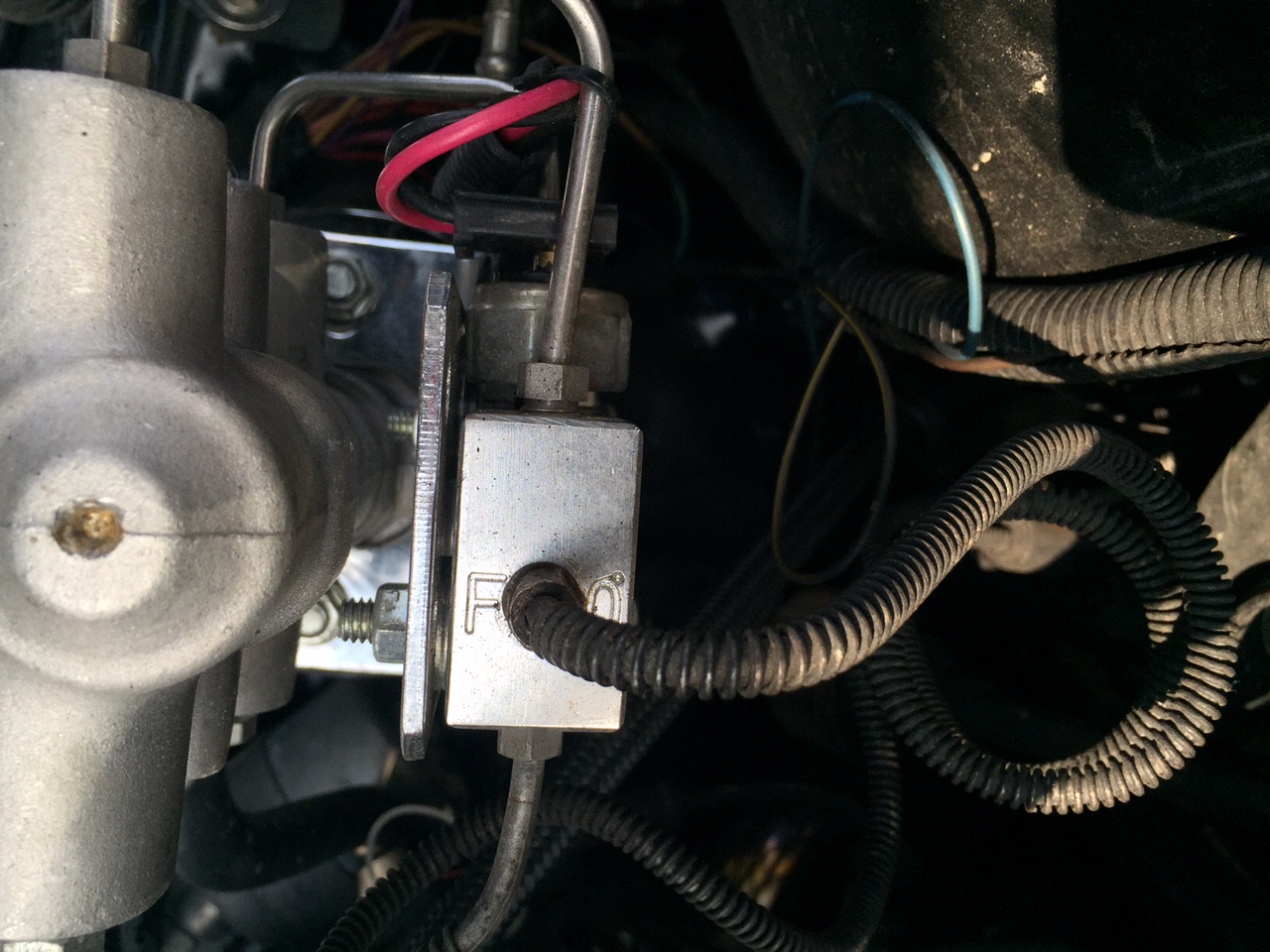

      I thought it could be a bad brake pressure bias so today I set out adjusting the proportioning valve. A few hard stops and half turns later I had gotten the fronts to lockup under very hard braking, but the rear still felt lifeless. I backed off the proportioning valve a little to give me front brakes that wouldn't lock immediately in a panic stop,
      -Erik
      How is the proportioning valve plumbed into the system? It is supposed to be in the line to the rear brakes, and as such won't affect the front braking capacity.

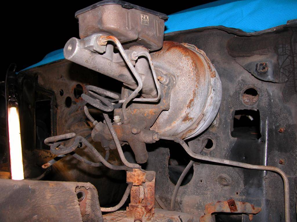

      As Bob noted above, you really need to know what components you have on the car and post it here to get the best responses to your questions.
      Several things come into play when people swap from the disc/drum to 4 wheel disc on the late 2nd gen birds.
      If it's a swap using all factory components you'd change the master cylinder, combination valve, possibly brake pedal (or modify existing), rear brake lines, and the cables for the park brake. The parking brake has to be functional and adjusted or the rear brakes will not work. Keep in mind the factory 4 wheel disc set up doesn't feel any different than the disc/drum if both are operating correctly and there's no noticeable performance difference in normal street driving
      If it's using aftermarket "upgrade" components from companies like Wilwood and Baer they need to all be matched to function properly.
      The most common aftermarket brake caliper that gets used is a copy of the GM caliper and also requires the park brake to be functional and adjusted.
      Another mistake folks make doing the swap with factory type parts is not having the plumbing correct. I've seen the lines swapped because the drum brakes use the rear reservoir of the master for the rear brakes and the 4 wheel disc master uses the front reservoir for the rear brakes.
      Stock plumbing in pics below I took of an 81 Formy I was working on with 4 wheel factory discs.

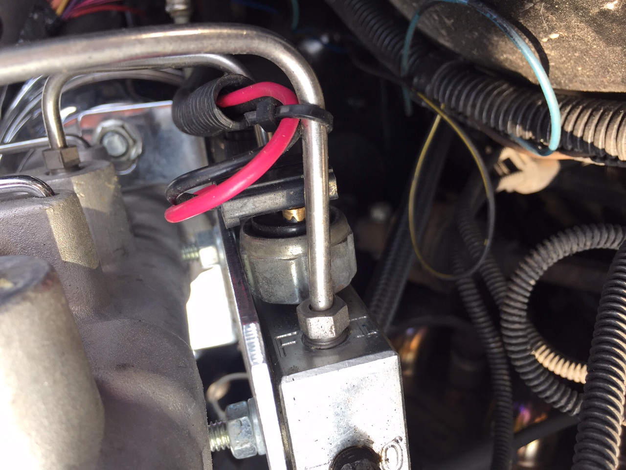

      Here are most of the pictures i have of the brakes.
      Jul 2013
      Grayslake IL
      312
      Dont know why the pictures posted sideways on the last post... Im not very good with technology but trying to give you guys as much info as possible for a solution to my problem. I'm posting up some proportioning valve photos to hopefully give you guys a little better understanding. I appreciate all you guys with vast amounts of knowledge helping everyone out on this forum! I dont know much about brakes but I am eager to learn as much as I can. Thanks again and if theres any more question or photo needs ill be happy to help any way I can.
