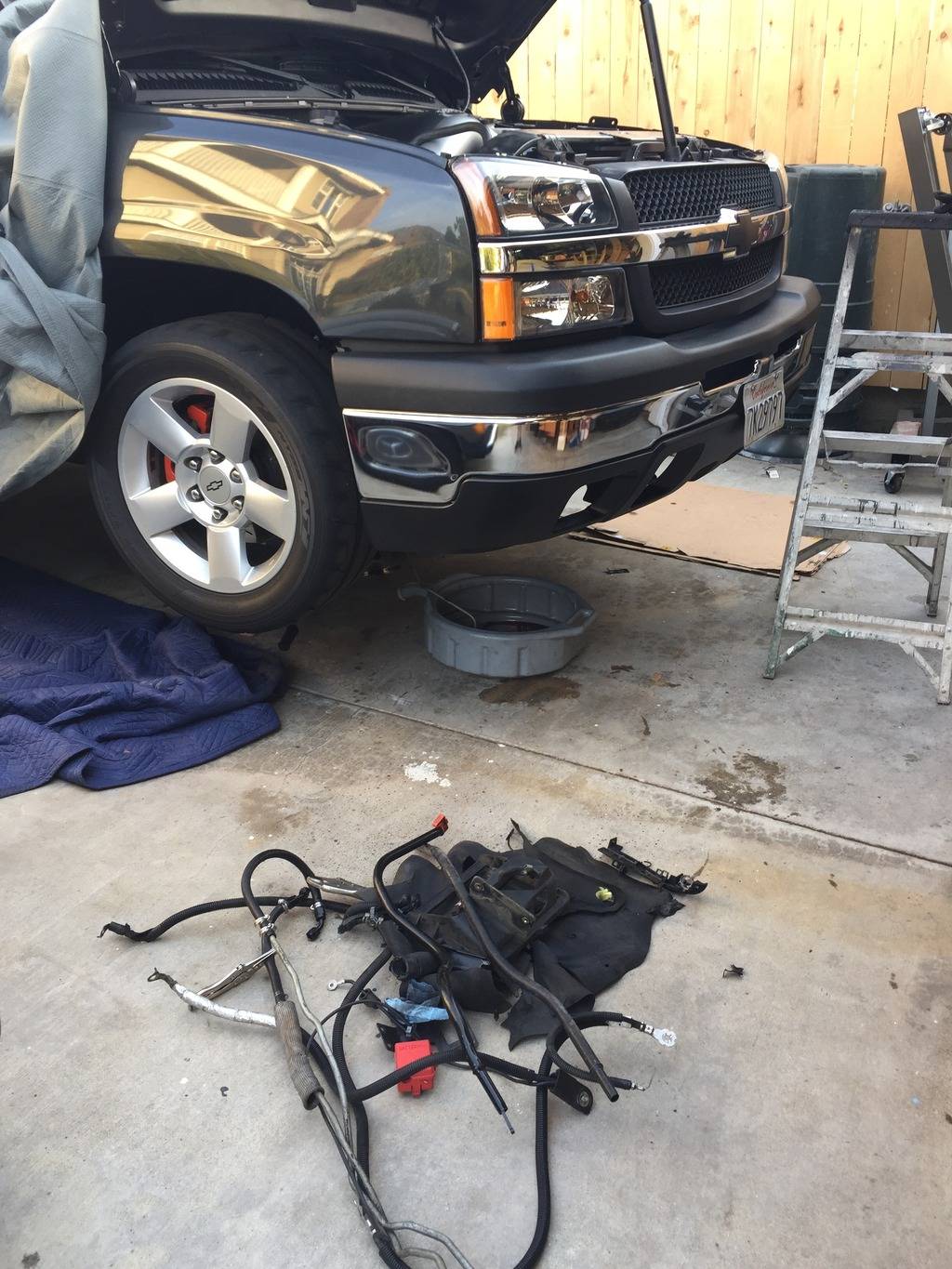

      Small update. Have a few other things in mind that I would like to get done. I'm relocating the battery to the passenger side with my new optima that I got for Christmas. (Issues with the current battery) Also moving the pcm into the old battery spot. Moving the battery will allow me to upgrade the wiring and clean it all up. The battery tray is ordered and I'm going to get the pcm bracket worked out this week. Going to start dropping the trans out so I can get the converter back to Circle D to have it re-stalled. Found a small leak on one of the transmission cooler lines so I am thinking about replacing them with AN lines while I have the transmission out. So, a lot of work left to do and never enough time to do it. We shall see how this goes.
      Here's a few pictures so far.
      New battery in it's new spot with custom 17mm socket mount
      Not sure if there is a way to use the fender brace with the battery here but if I can I will make it work.
      Old battery gone revealing the crusty battery tray. New one is also on it's way.
      Pcm sitting in it's new home. Going to cut open and re-wrap some of the harness to clean it up.
      And a general idea of where everything will live when it's all said and done.

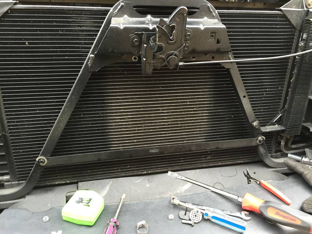

      Also flipped and trimmed the lower cross-brace on the hood latch support. Now I'll have room for both large coolers if I choose to run them.

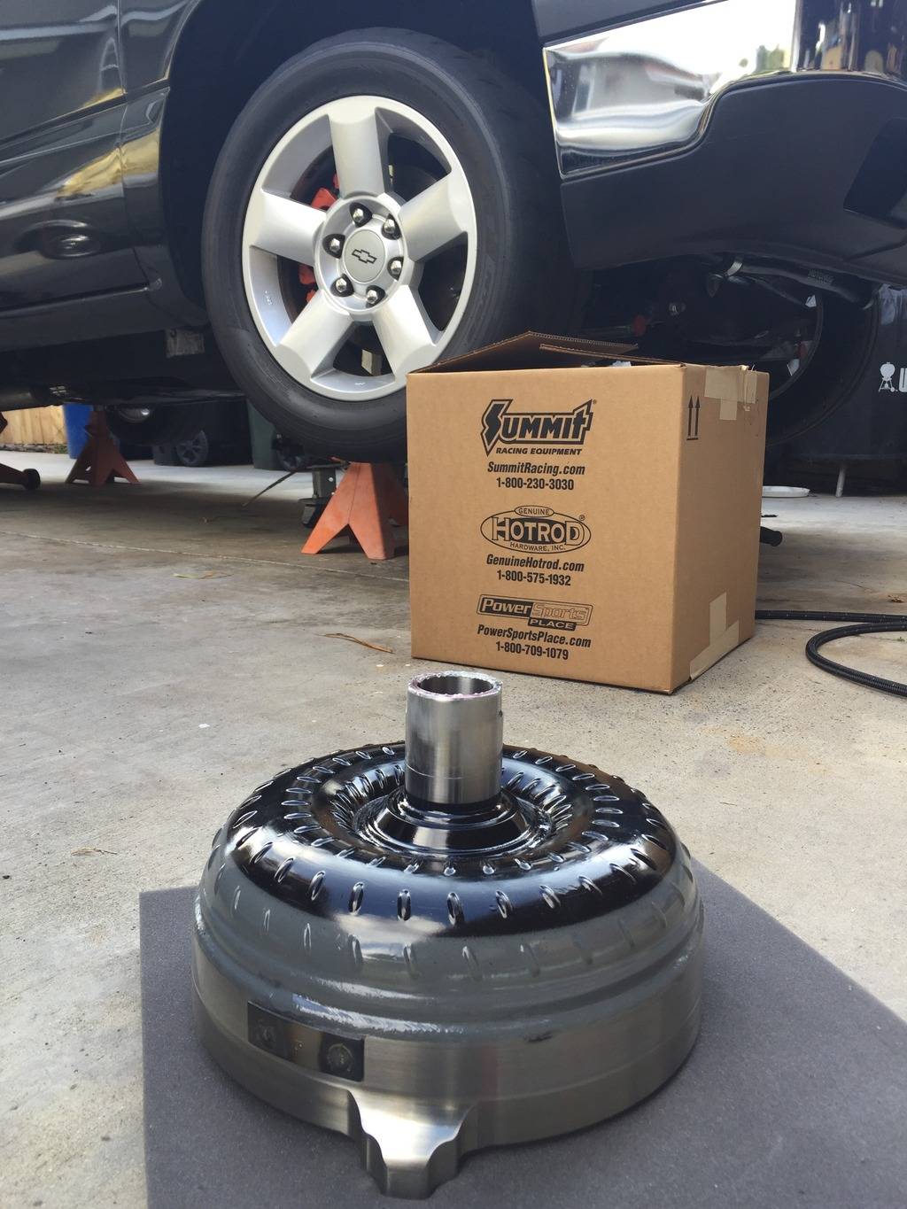

      Got my torque converter back from Circle D Specialties freshened-up and re-stalled. Excited to see how she works.
      I would have started getting it installed but of course it decided to rain... Took that opportunity to pick up a few of the last pieces I need to get the truck back together. Got some battery cables and ends. Going to try and make as much progress on the truck this weekend as I can.

      Got the torque converter installed and the transmission back in. It's now sitting on the new crossmember and I finished getting the cooler mounted and plumbed. Just need to go get another piece of 1 ga. and some 4 ga. for the alternator charge wire and finish mounting the pcm and she'll be ready to rock and roll again.
      Really like the AN fittings. Much cleaner and simpler than the factory lines. I assume they are worth about 10hp a piece. :jest:
