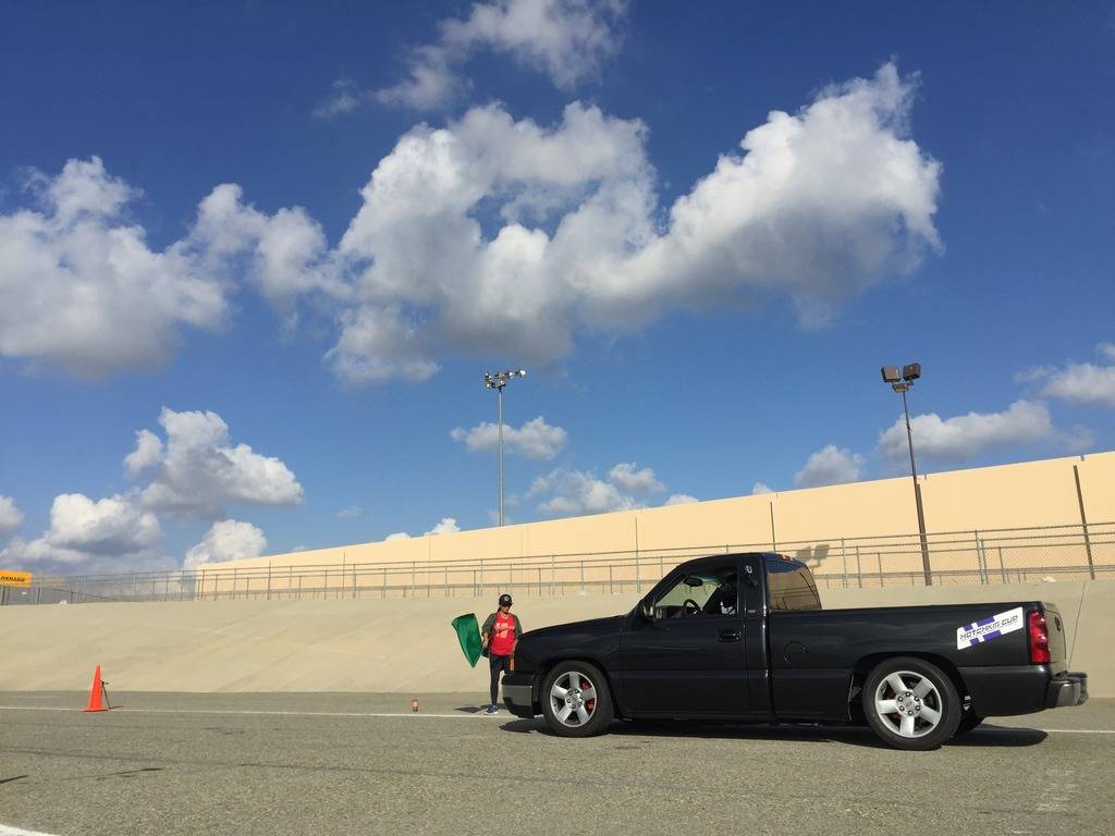

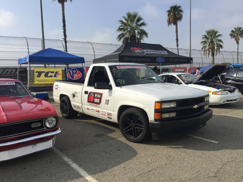

      I wasn't the only truck out there. Got to meet Frank and his 94 Chevy Truck. Brandy also got a couple pics of yours it too:

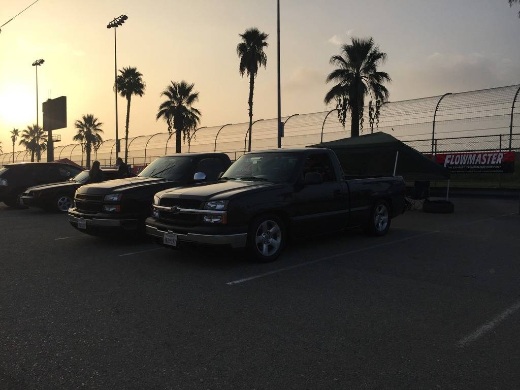

      Bright and early on Saturday morning.

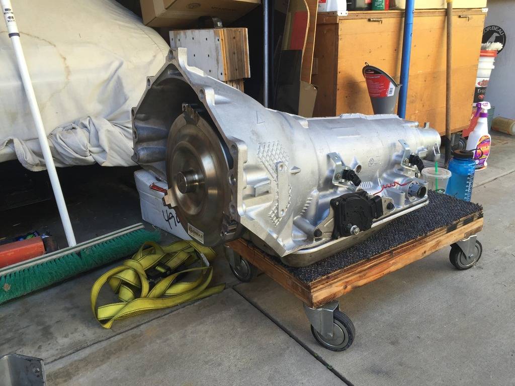

      Got the trans back Saturday morning from a friend of mine that I had go through it.
      Finished installing the trans this morning and got it back down on the ground ready for a test drive when I realized I had no reverse or 4th gear... After some scan tool and pressure gauge testing and a little internet research and I decided to swap valve bodies with the other 4L80e that I have. I am suspecting the Transgo separator plate or possibly one of the other pieces of the shift kit. Swapping it with a known good VB will just help determine the problem.
      I originally rebuilt that transmission myself and had the same issues about a year ago. But needing to get the truck finished up for some deadline, I found another unit and just dropped it in. My hope was that my buddy would find something I missed or was wrong, but he didn't see anything our of the ordinary. I was at least hoping for a pinched seal or something. But it did boost my confidence in transmission works as I was very careful when I originally rebuilt it.
      I have the truck draining now and I'm going to swap valve bodies tomorrow night.
