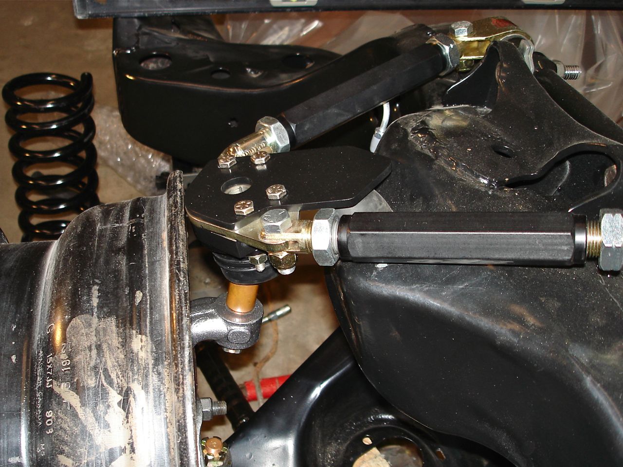

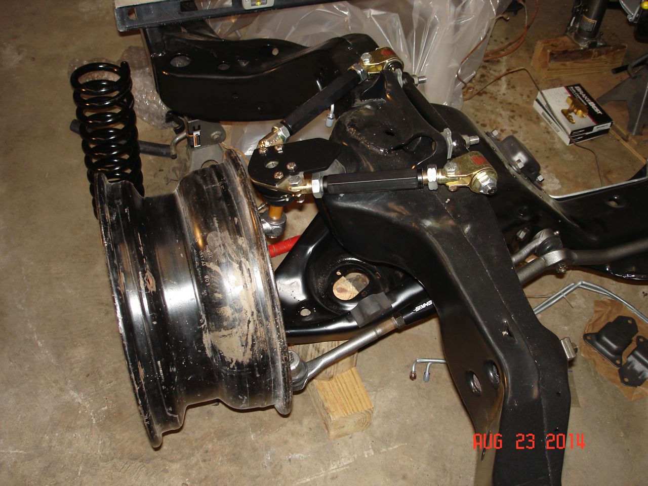

      I went with the 94320 arms with the flat BJ plates. I'm running a tall BJ with a 1/2" aluminum spacer to allow more droop in the suspension. Running the suspension (on jack stands) through it's travel shows about 3-degrees of camber gain from ride height to full compression. I don't know which bushings are in my arms, I think they may be steel. Here's a pic of my set-up.
      This is a 15" rim which doesn't have much clearance with the tall BJ. I'm now running 18" rims with plenty of room.

      I fabbed-up a 1/4" plate to serve as a bumpstop for the upper arm. Without the bumpstop the arms would hit the frame at full droop.

      Wow looks like a nice setup. Be careful of stock lowers. Mine are 46 years old and the moog lower bj fell out when I lifted my car by the lower control arm! Got me SPC lowers today :-)

      I bought my SPC94320 on fee-bay from UltrarevParts; not sure if these have steel or delrin bushings. They cost me $390 for the pair with free shipping and I had them in a week! I used my stock lower arms and spindles with Howe ball joints (bought them directly from Howe). I used a +.5" lower BJ stud and a +.9" upper BJ stud, but may change the upper to a shorter stud when I get the car at ride height. I'm concerned I may have too much camber gain for a daily driver - too much of a good thing can be bad, right. Here's a link for the upper arms.

      I hear you on the lower control arm warning, I read lots of scary stories on the web of guys breaking the lower arms and grinding to an uncontrolled stop on the roadside. My ball joints were really tight when I pressed them in and I de-burred and stress relieved the arms as a precautionary measure to keep cracks from forming. I'm also running stock Moog rubber bushings which should help cushion the ride. This will be my daily driver and I not really going for all-out cornering. Weight was another part of my decision to stay with the stock arms as the tubular arm are considerably heavier and one of my suspension goals for this project was to reduce unsprung weight to improve handling response.
