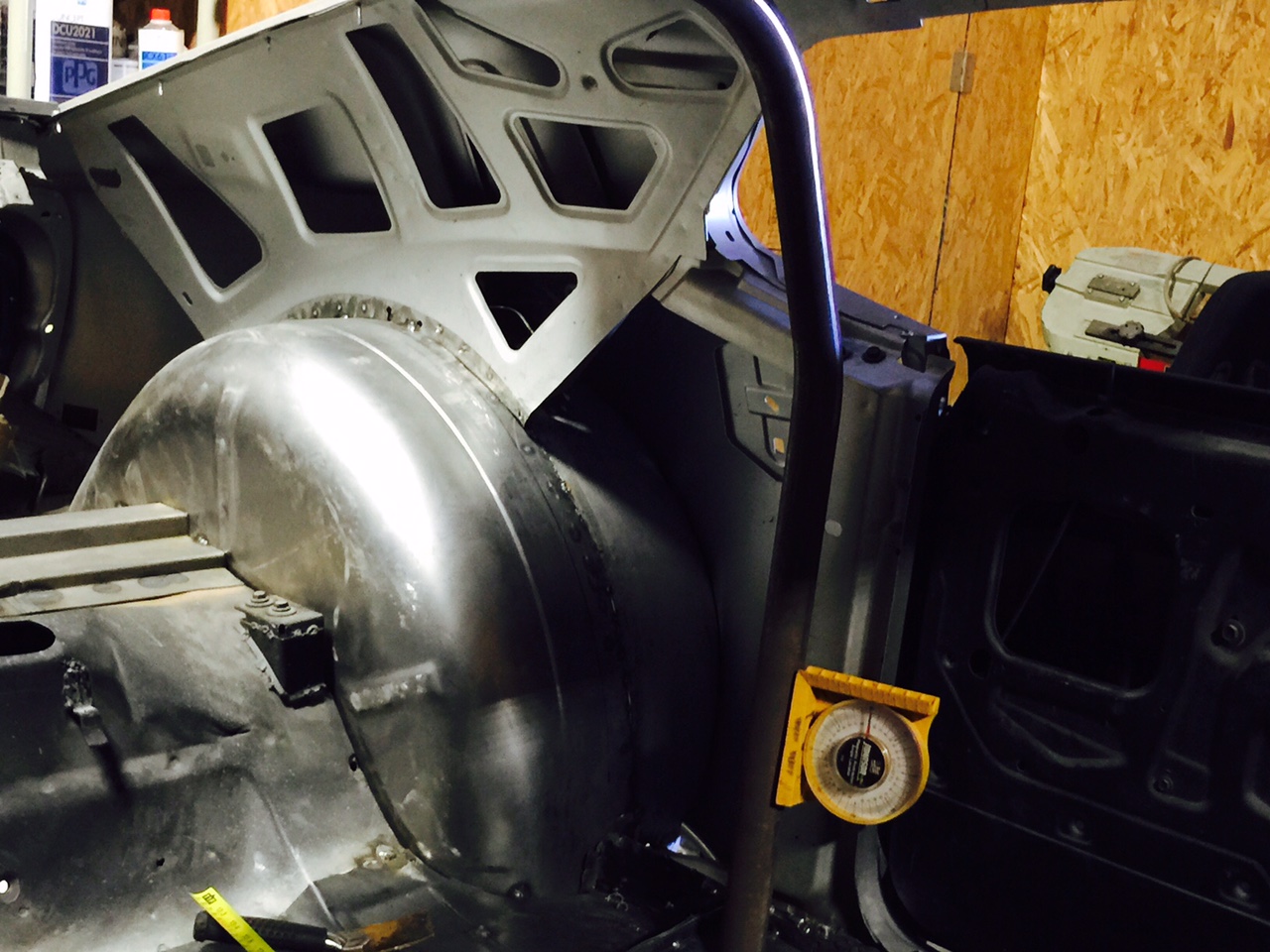

      Wheel tub, the inner half is detroit speed mini tub kit, the outer is the stock wheel housing detached, we then flattened the lip and shrunk it to match the contour of the detroit speed part. A new "L" shaped piece will be made to attach the tub to the body again
