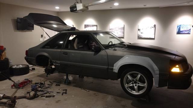

      Had to take a break from the mustang to prep our desert toys, but I'm back at it.
      I added the wider 98' axles with extended studs to the car this afternoon.
      MAN, am I tired of pulling the torque arm and smelling gear oil.
      I should have the rough version of the flares on all four corners by weeks end.

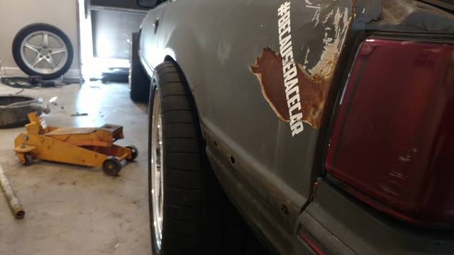

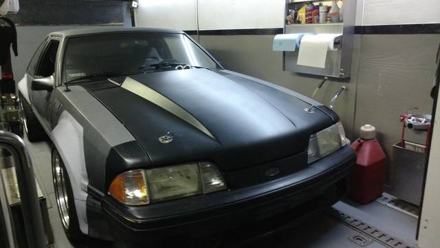

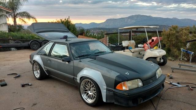

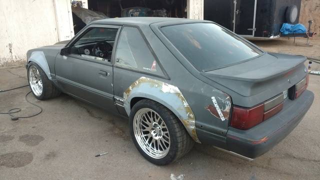

      Well, it drove to work this morning on its "new" tires. All the flares are bolted on, but none of them are finished.
      Still, I had to share.
      This is the width with the 98' mustang width axles on.
      Obviously this poor thing has been "enjoyed".
      The rear fender is the one I had to piece back together. It had been sectioned up before I got ahold of them. I plan on blending all of these into the body. The DS rear will be the most work since i'll have to at least lessen the amount of filler that was used for the last "fix"...

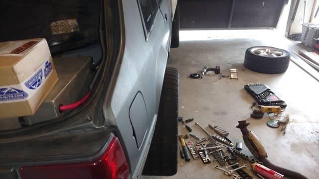

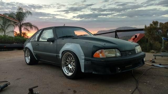

      Nothing terribly exciting. Ive spent some time fine tuning the for of the flares. Still a ways to go to say the least.
      I had some rubbing issues with the 335s in the back last race. (Weird, right?) So I did some massaging with my favorite bfh, and added a 1/4 wheel spacer. Luckily I had the foresight to add some extended studs to the axles last time it was all apart in anticipation of this... (OR! It was just a lucky ass coincidence that the last 8.8 I bought came with them... Either way...)
      Going to do some autocrossing in the morning though, so I'll get to see if I'm heading in the right direction at least.

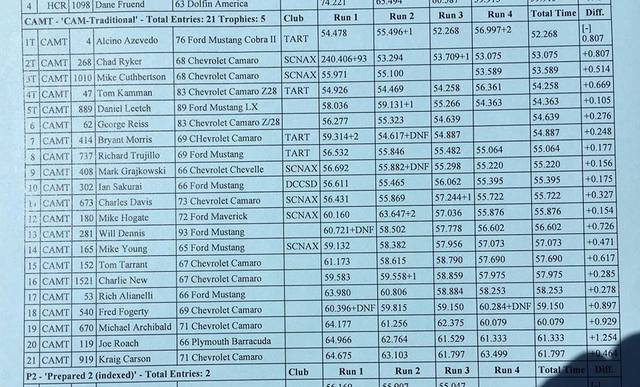

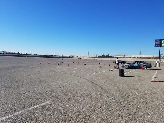

      Well I didn't win. AGAIN. "As long as you're having fun..." pffffft...

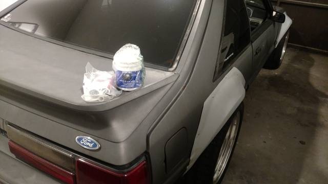

      I ended up 5th out of 21, and contrary to my ramblings above, i'm pretty damn stoaked. The car feels outstanding. Room for improvement sure... but MAN, has it come a long way since I started. So good in fact, that i'm going to go ahead and make it less ugly. I got ahold of the adhesives, fiberglass strand fillers etc that will be required to blend the flares... I don't think it will be a super fast process, but we'll see if I can't get all hopped up on Mtn. Dew and surprise myself.
      Here's my best (and final) Lap of the day:

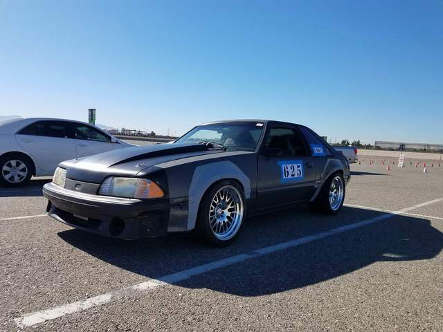

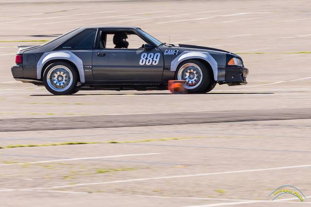

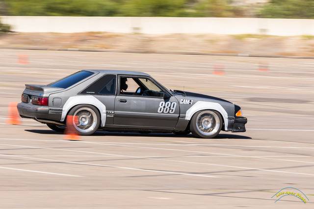

      Some cool action shots from the last autocross. (DAMN this thing needs some paint! :D )
      The CAM Challenge is coming up in a couple weeks. They require different numbers than the normal SCCA events. Luckily, my Stepmonster has access to some pretty cool sticker makin' machines. So, while the car will still be 50 shades of grey for the big national event, at least it'll have some cool racecar inspired steekers.
