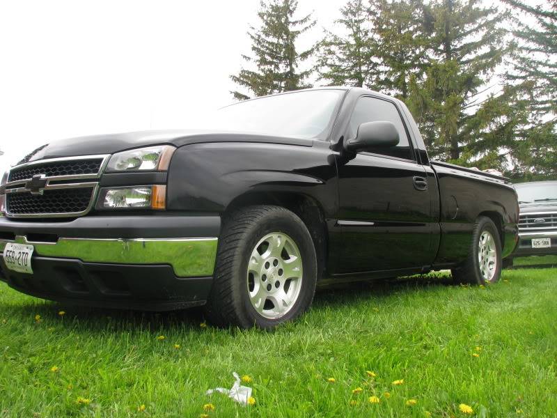

      The truck is my 2006 Silverado shorty. It's gone through quite a few changes since it rolled out of the factory on June 6, 2006 (6/6/06, kind of a cool build date).
      It started as just a bare bones point A to B work truck. It's only options were A/C, CD player, and the G80 limited slip diff. No power windows, locks or anything. And just the 4.3 V6 with the NV3500 5speed.

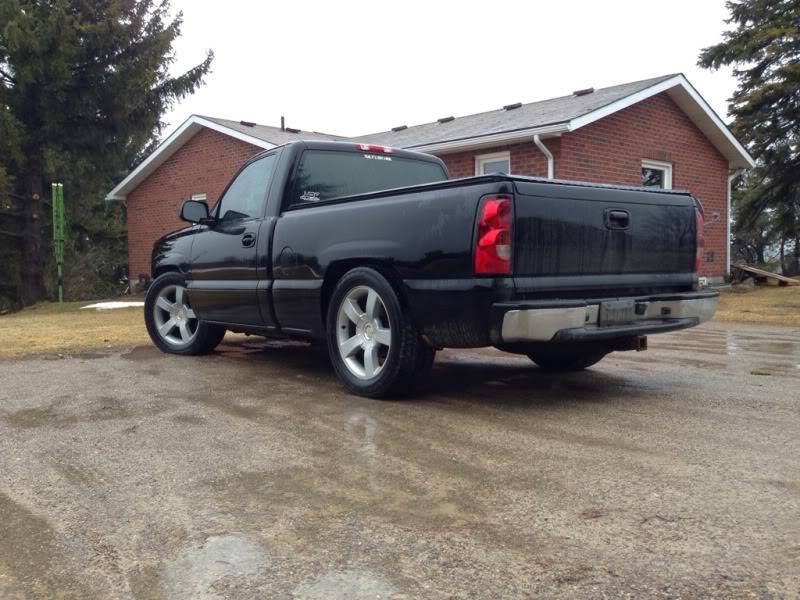

      I drove it stock for a couple years, mostly because I didn't have the cash to do anything. Then slowly it started getting it's mods. First major thing was a McGaughy's 2/4 drop with spindles up front and shackles and hangers out back. With 275/60/17's on some wheels I got from an Avalanche.

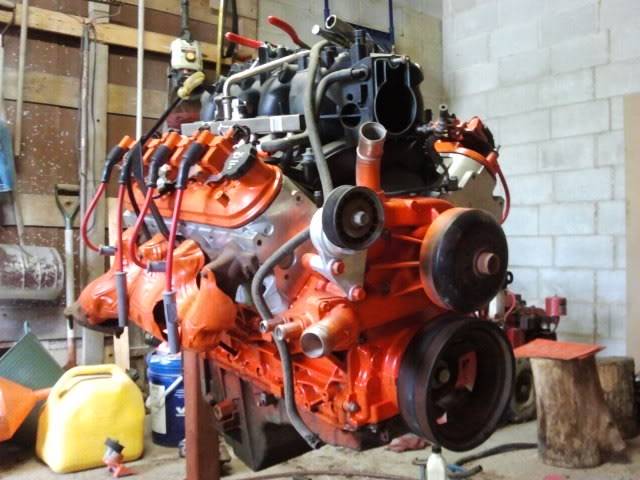

      Then it was time go faster. I sprayed the 4.3 with a 150 shot of nitrous, and it was still lame. I did this to get by and have a little fun while I was piecing everything together for the V8 swap, now on to that V8 swap. I built a 5.3, with 4.8 pistons (flat top vs. the 5.3's dished), Patriot Stage 2 LS6 heads, and a custom ground cam from EPS that spec'd out at 222/226 @ .050 .598 on a 111LSA. It has a real rowdy idle, tabletop flat torque curve and power peaks just above 6000rpm. And I kept the nitrous setup, only switched from a nozzle over to a plate. Jetted for a 200ish shot. All the tuning was handled by Casey Rance at SWG Performance out of Temple, Texas. Casey got this running with e-mails back and forth and even at 2 in the morning would pick up his phone and call me if I needed help. I then got it dialed in on the dyno by Champion Motorsports in Toronto.
      Through the 5speed final power numbers were 446/406 on motor. Never sprayed it on the dyno.

      The truck currently sits on Silverado SS 20's and 275/55's. For the time being, I just want to find a nice 275/45 and powdercoat the wheels a dark bronze colour. Long term, I'd like to find some nice light 20x10's and move up to a 295 series tire with a 28" overall diameter.

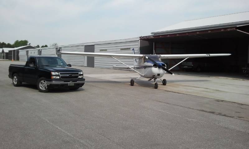

      The entire truck is going to have an airplane theme. P-51 on wheels. I'm a bush pilot by trade and have grown quite fond of covered rocker switches, and riveted aluminum, and the no-frills pure business look.
      And what's a build thread without pictures, so:
