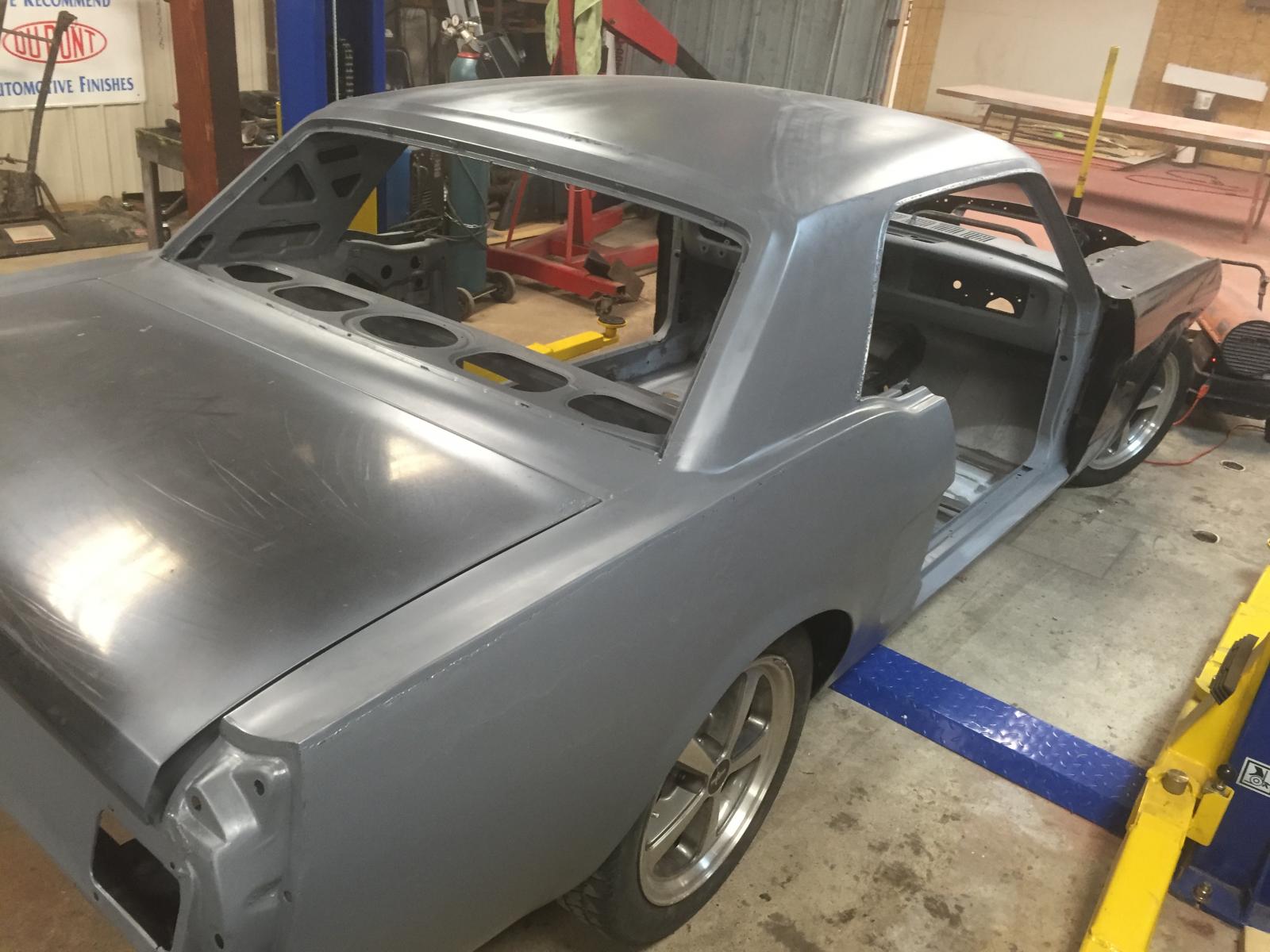

      i cut the lip of the wheel opening about an inch from the opening, then pulled it out two inches. Then i relief cut the quarter and strip, and added metal in between. After welded up, i carefully shaped the flare so it was convex around the whole opening. Then i glassed it to seal up the welds and smooth it out. Havent gotten back to those just yet but i have seen them pull the quarters out like you are doing. My dad did that to an old nova for a guy to fit 10" wheels in there. Originally i wanted to cut the quarters at the top and pull the whole shoulder out but i was afraid i would end up with alot more work than i bargained for.

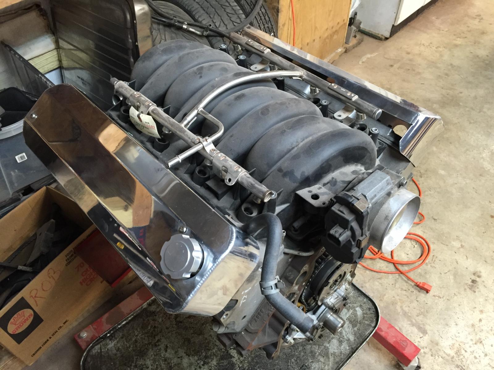

      so been awhile since ive updated here. Decided this summer that the flares had to go, cut the quarters off and welded on new skins and stretched them over the widened rear wheel houses. After that ive been collecting parts and working on other peoples projects but i have managed to install my MAST cam, springs etc., purchased a swap harness for the motor, im working on installing a six point rollbar, fitting a cable operated hood latch, getting the hydraulics for the trans pieced together and collecting all the little bits and pieces needed to fit all this together. Coming along although it doesnt look like much. I finished shaving the drip rails and welded some 1/8" rod along the radius. Heres a pic of the valve cover/covers on the motor- takes some of the LSishness away. SHould look good all sprayed color. Did spray some more epoxy coat on the car since the bare metal was starting to rust sitting around the garage. Name:  IMG_0934.jpg
