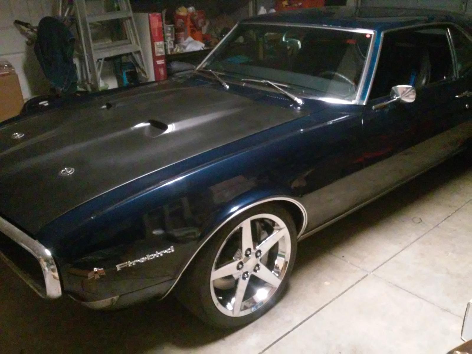

      53.6/46.4 F/R weight bias
      3488 lbs curb weight no driver
      68 Firebird (see signature).
      I've lightened the front a lot with aluminum heads and intake, fiberglass hood and TCI Engineering front subframe (with rack-n-pinion steering etc.). battery in trunk. TCI Torque-arm rear susp may have added some in the rear as well. Lighter front brakes, and Corbeau seats. Car handles pretty well for AutoX and track.
      2nd place at Good Guys FL 2015
