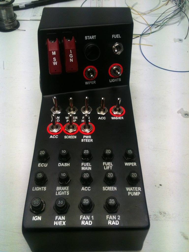

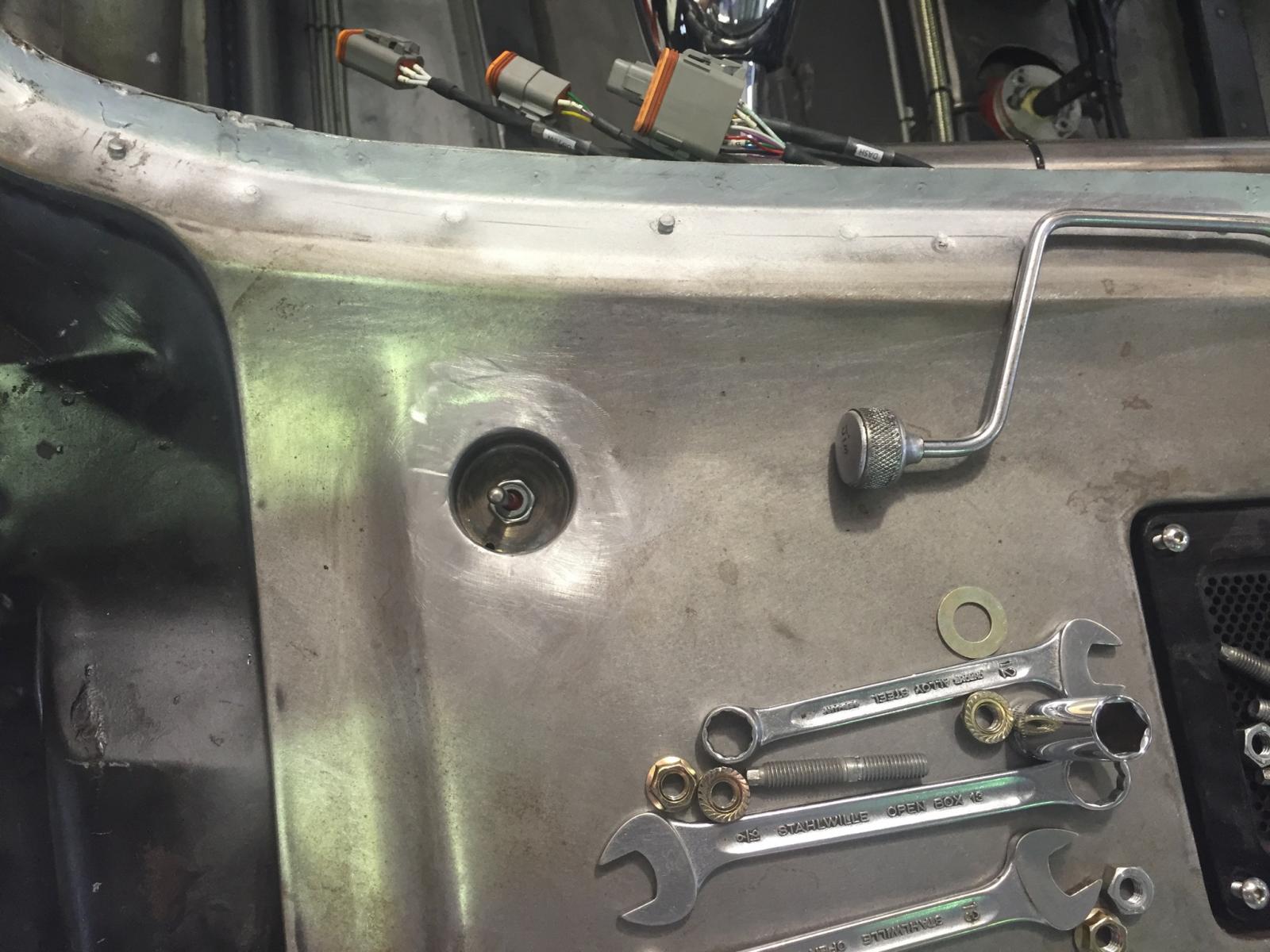

      Switch panel. It will mount on the trans tunnel behind the shifter so it is within easy reach.

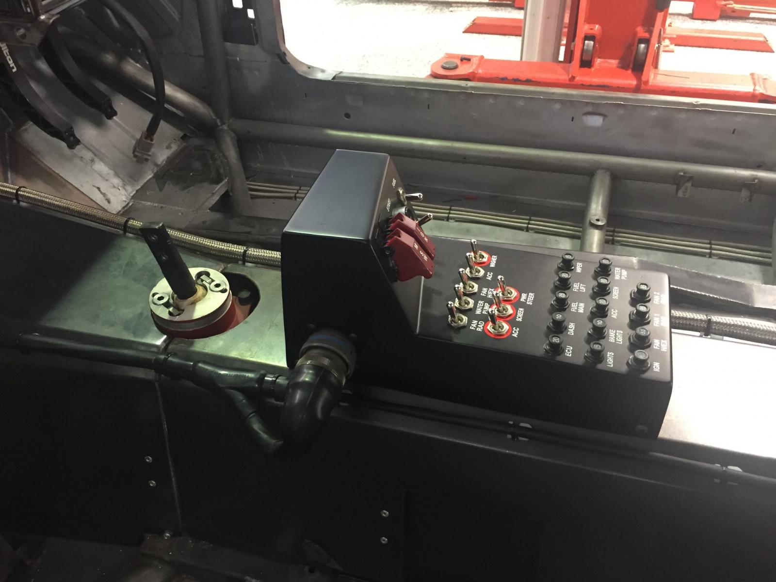

      Ok, looks like I am going backwards but in reality, getting close......

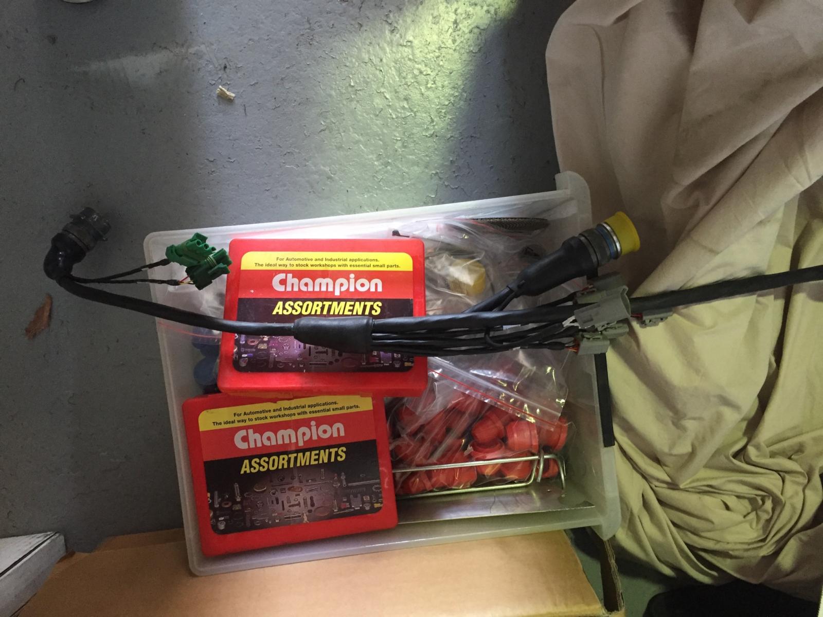

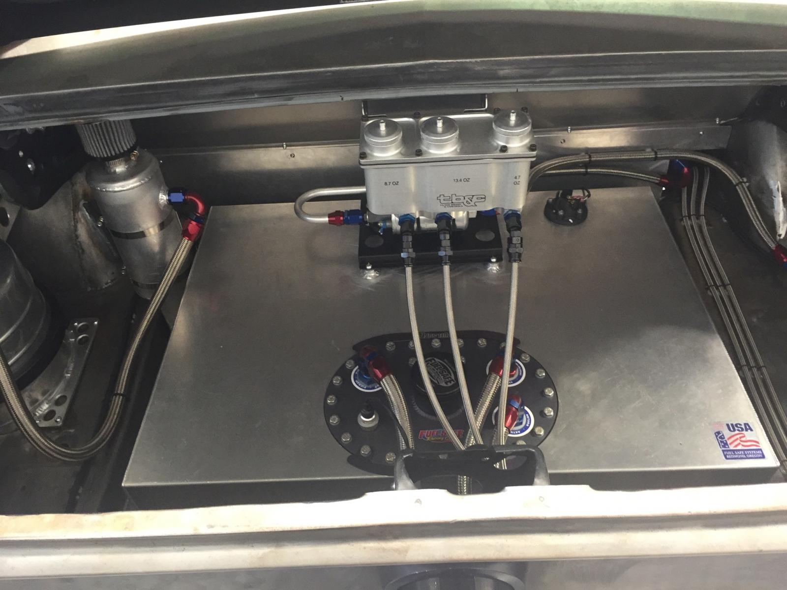

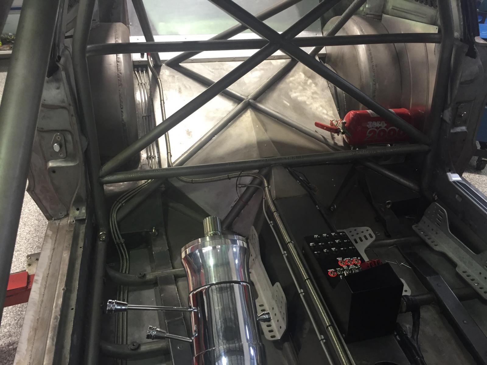

      Custom wiring harnesses done, boot is finished- fuel cell, swirl pot for fuel, 2x fuel pumps, dry sump tank and swirl pot for it as well, brake and clutch reservoirs, all lines done including fuel, oil, power steering etc
      The engine and trans can be removed as one unit, rear diff can be dropped out.
      Fire extinguisher fitted.... The list goes on.
      I really like the external kill switch and the control panel with individual circuit breakers.

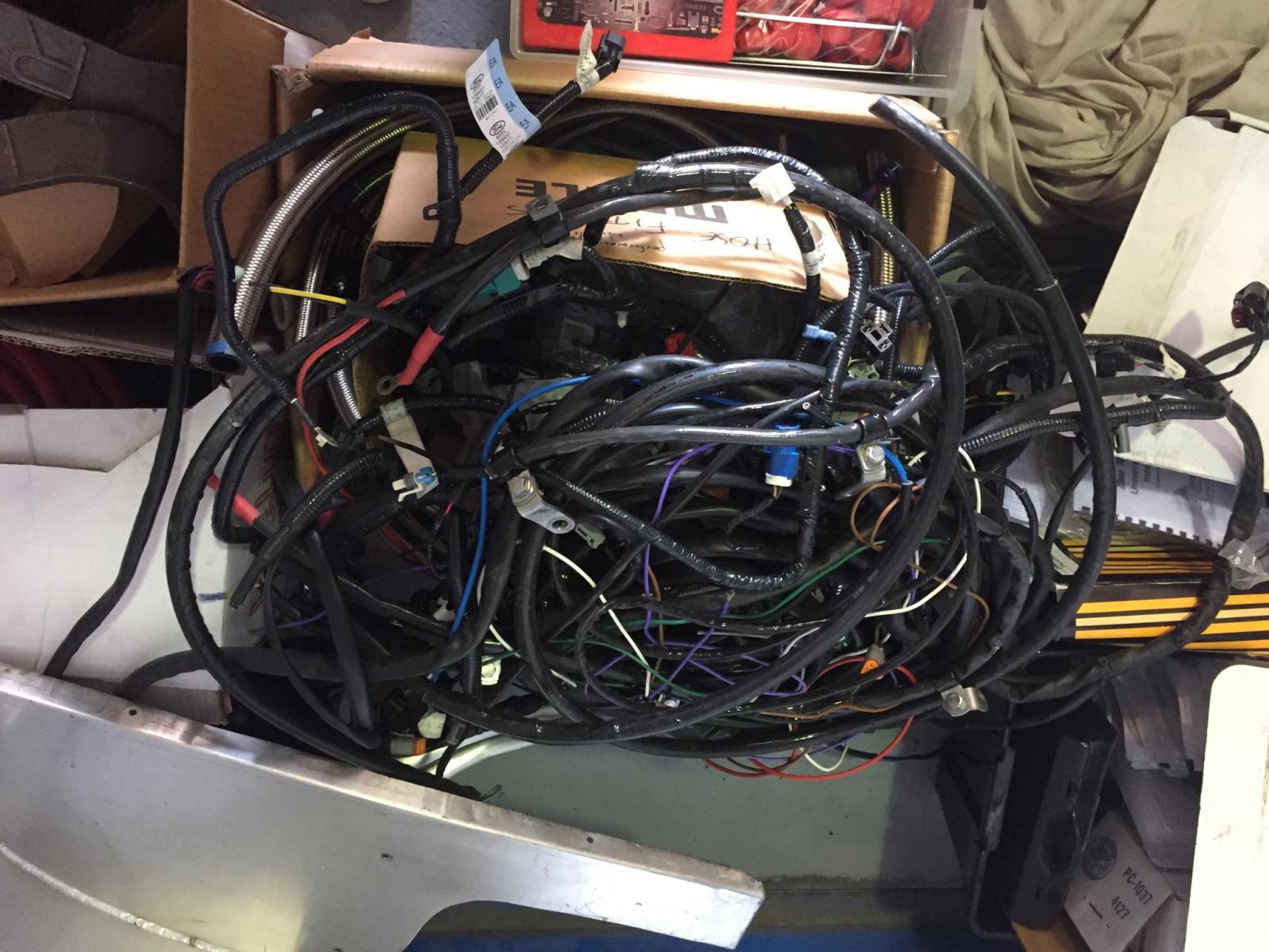

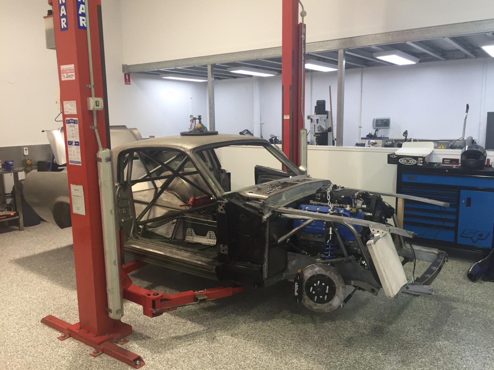

      Some updates...
      All this crap......
      1966 Plymouth Fury III

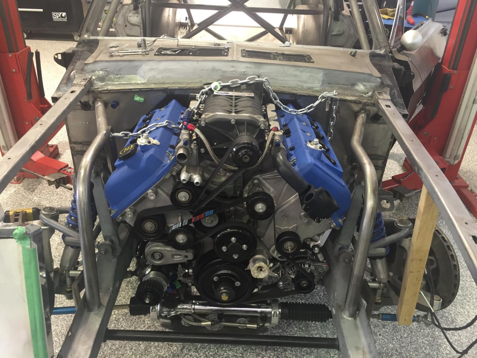

      Replaced with this.....

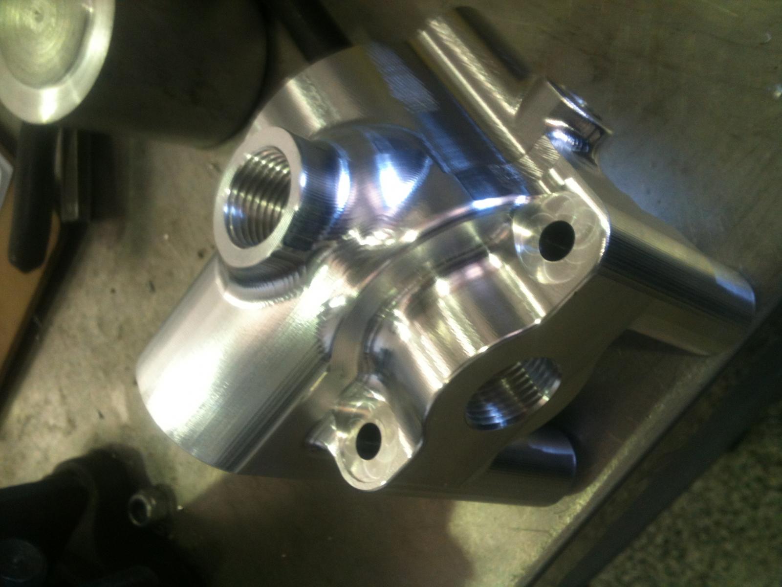

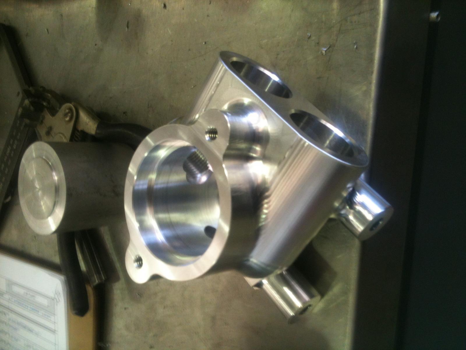

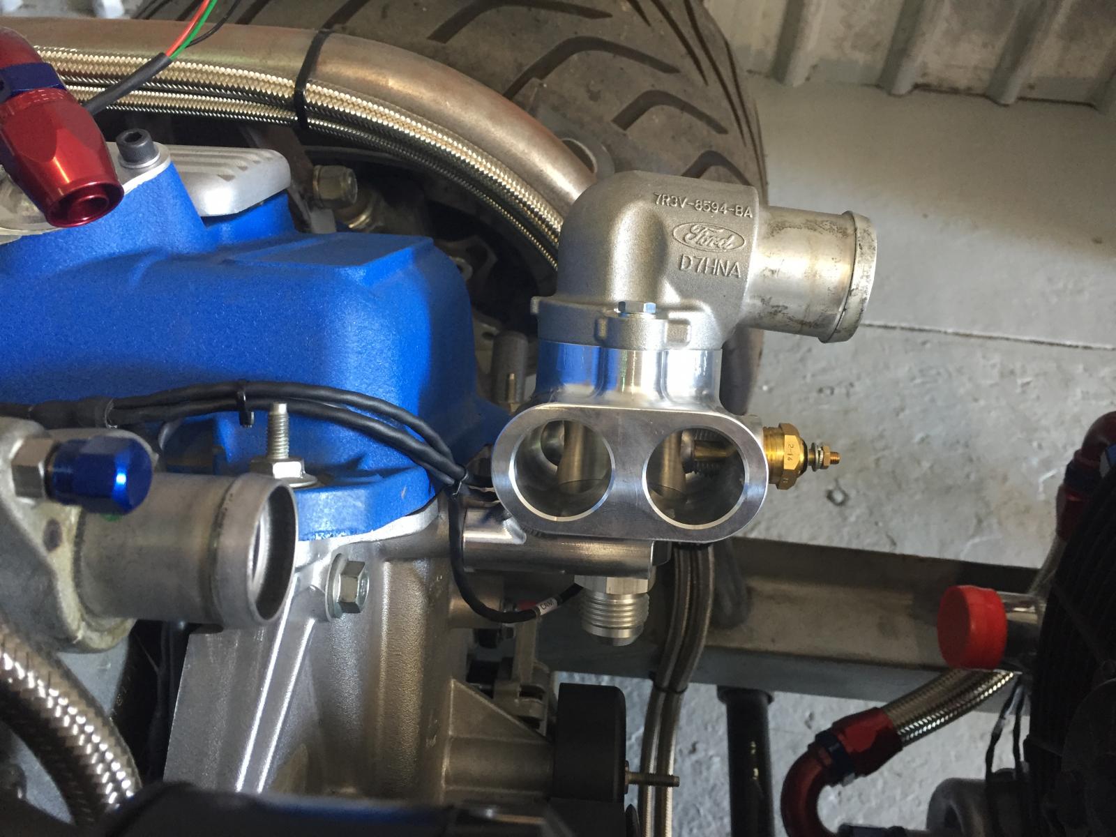

      Custom thermostat housing almost done -
      May 2011
      Brisbane, Australia
      453
      Country Flag: Australia

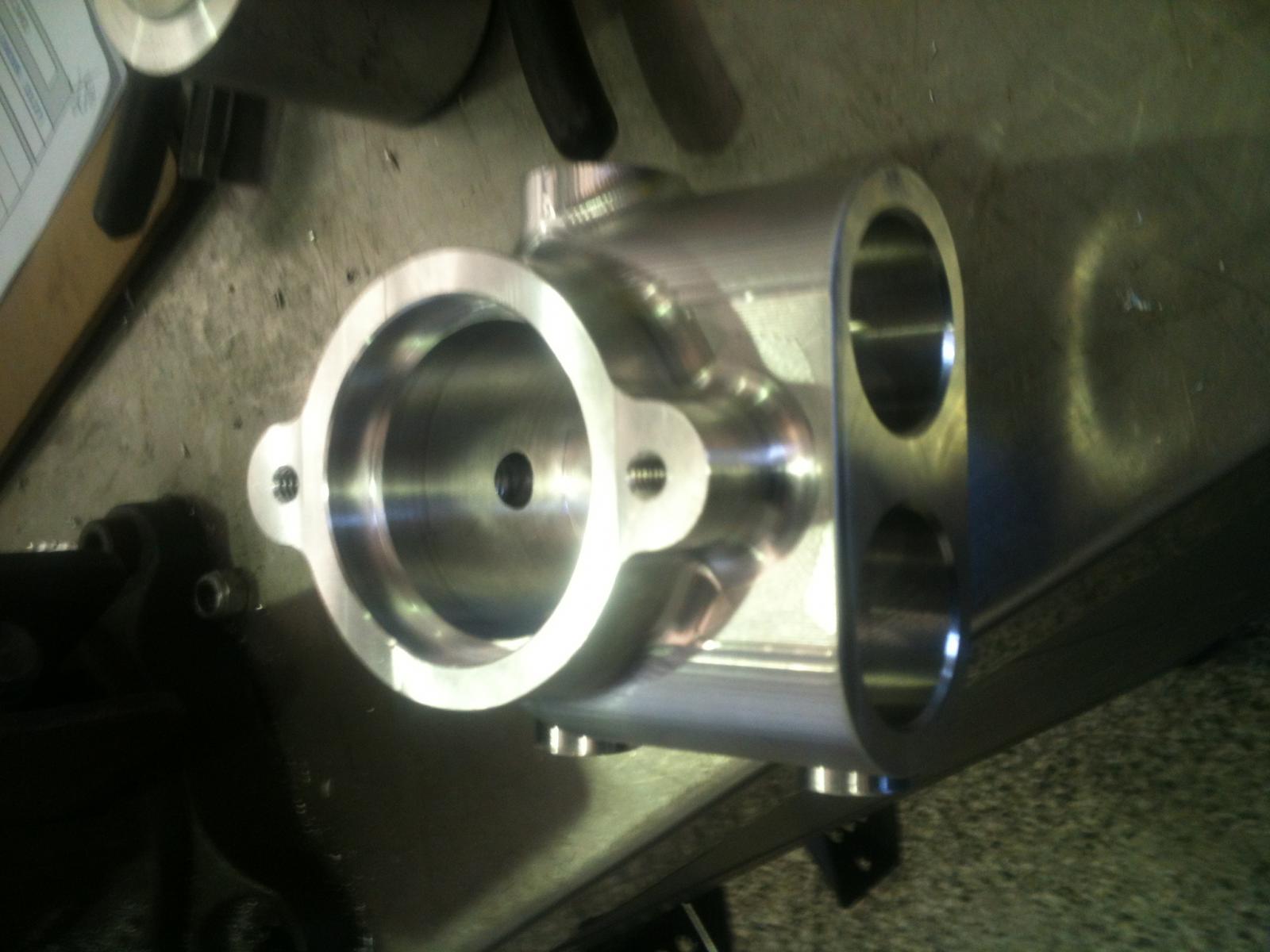

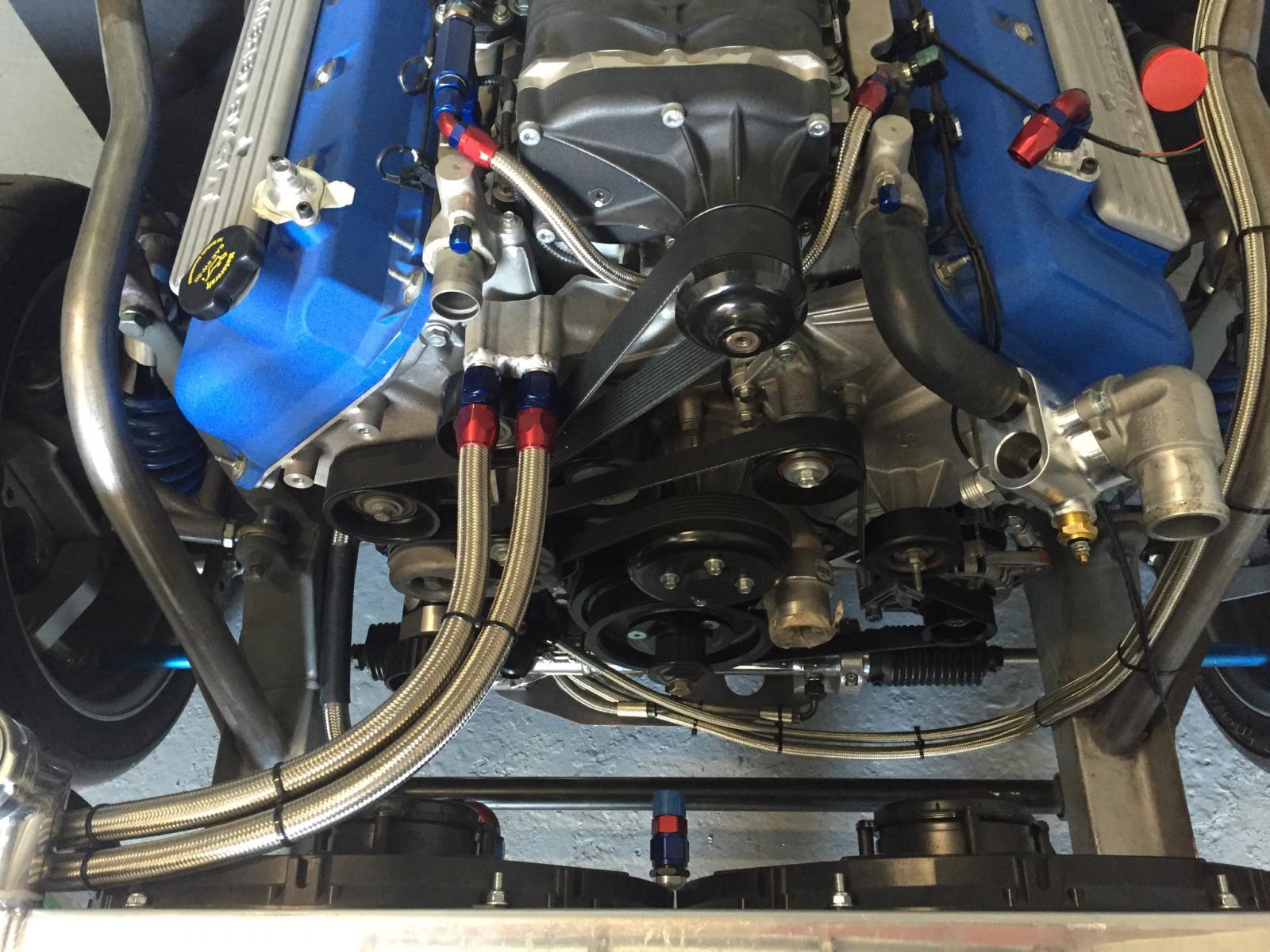

      And in place-

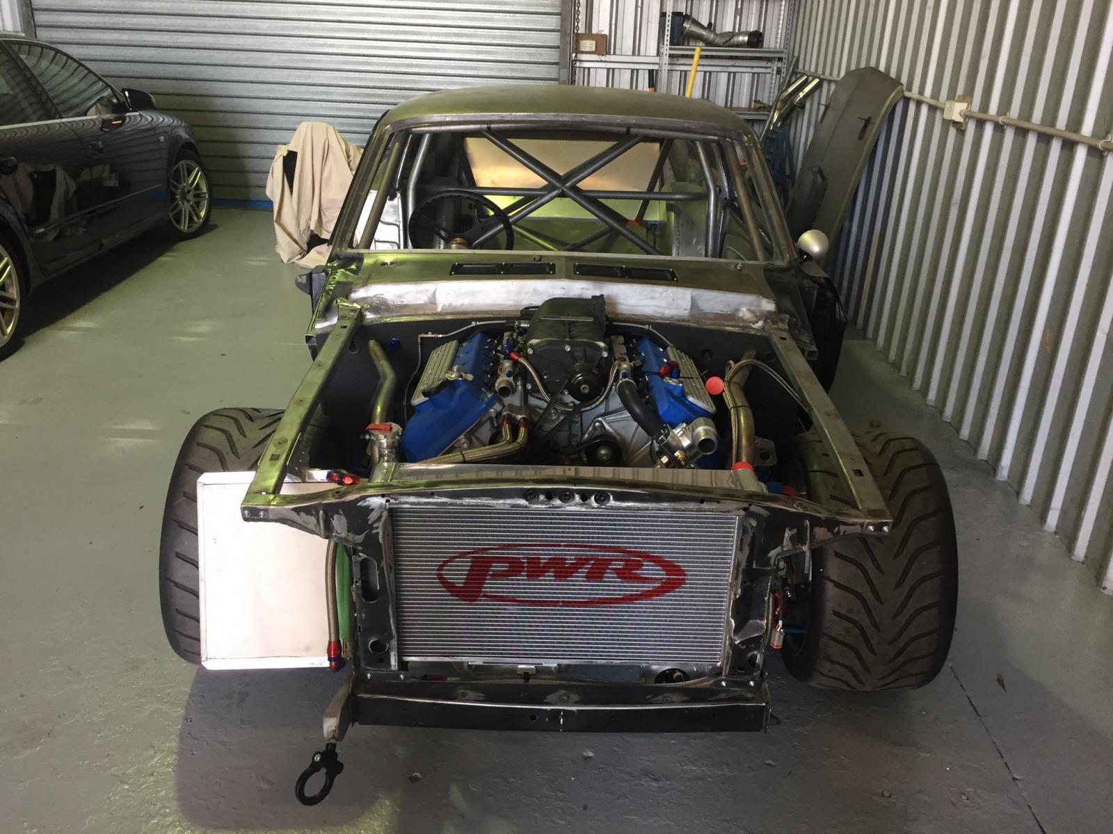

      Just waiting on the headers to come back from coating, finish the last bit of plumbing and then off to a hub dyno to fire and tune......
