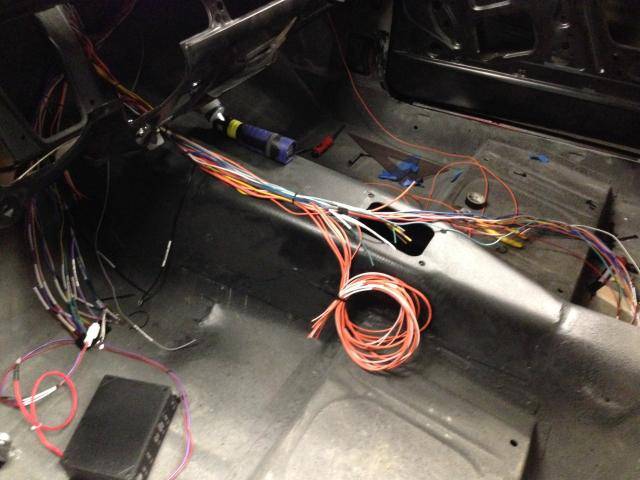

      I know these are so random but a few more pictures…

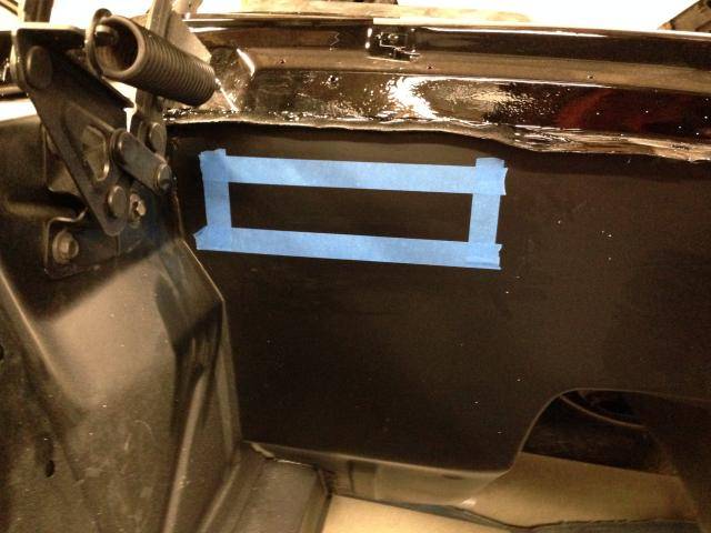

      flushed out the fire wall and move it back approx 2". This allowed for a little more room to plant the coyote.

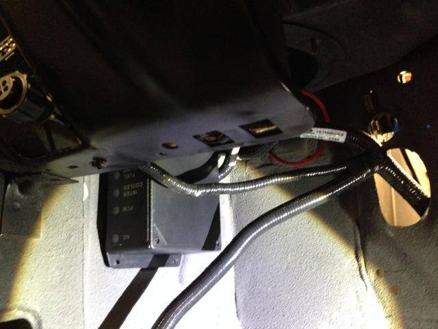

      One of the boxes for the PCM (mainly relays). Decided to put it under the driver side dash.

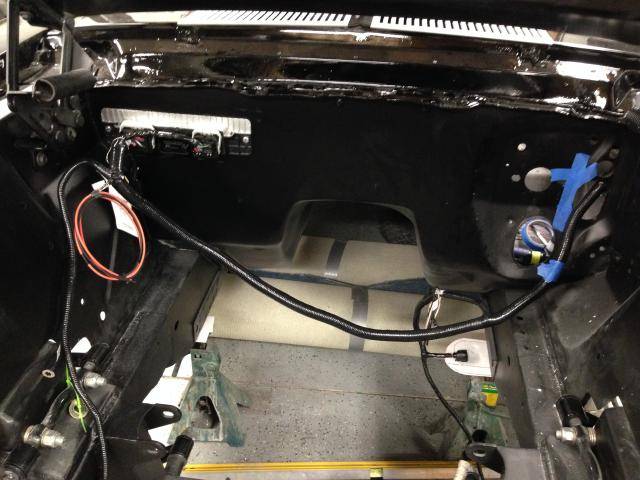

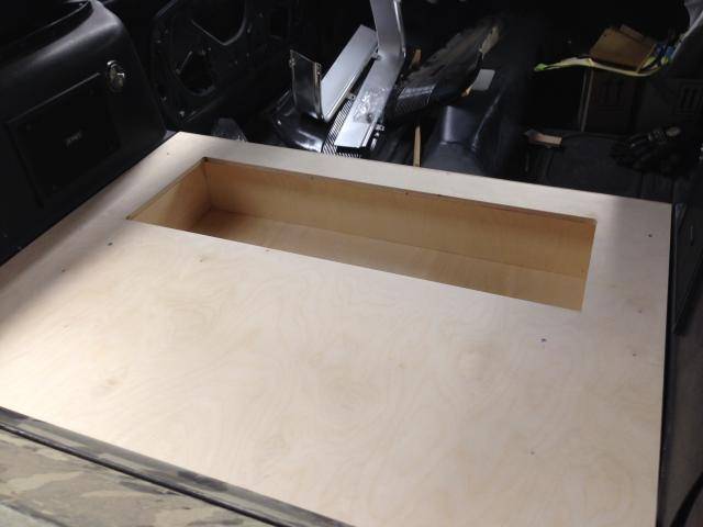

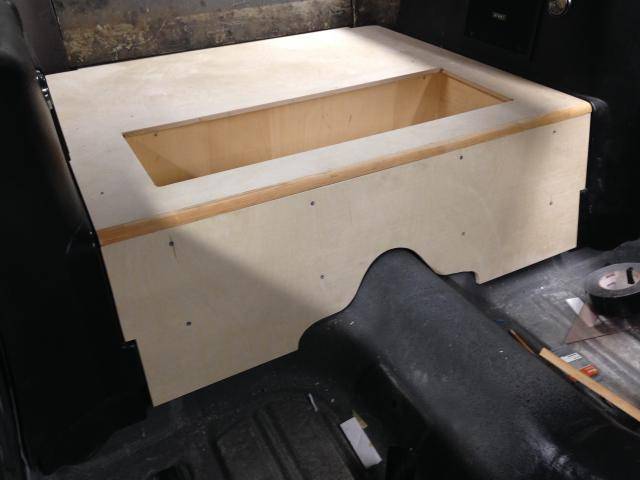

      The rear seat delete that I mentioned before.. The compartment will accommodate the amp..
      PCM location..

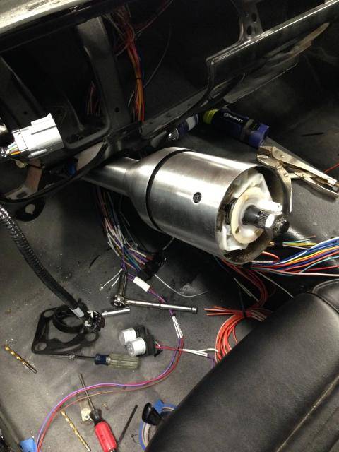

      ididit steering column

      Great looking build. Agree with the choice of wheels, definitely go with the car and that rear seat delete is clean, good idea on the hiding of the amp as most install them into the trunk, curious if you're planning on venting the box somehow as the heat would build up eventually if its fully sealed/ hinged with a door and cause poor performance/ "amp clipping".

      Nice build! Yes, definitely plan on venting the amp compartment. Still need to integrate slots in the box and I'm considering a fan to vent out as well. It's amazing how many "pieces" there are to this puzzle.

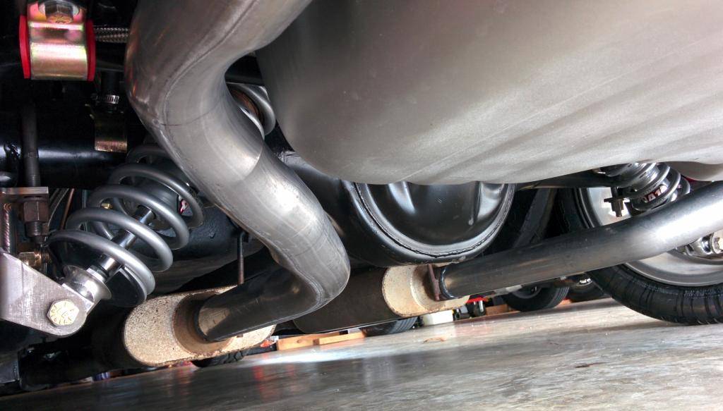

      Quote Originally Posted by chatas1 View Post

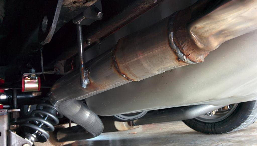

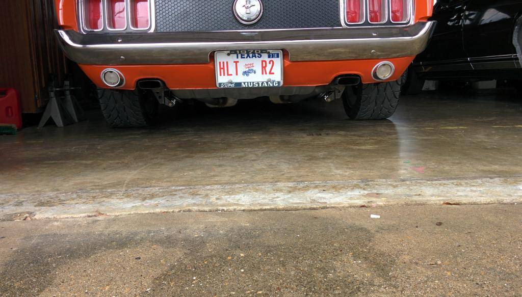

      I am using Dougs headers. They worked out very nice with the TCI front end. I think I will be doing a custom 3" exhaust. My concern is getting the exhaust over the rear axle and clearing the 4 link.

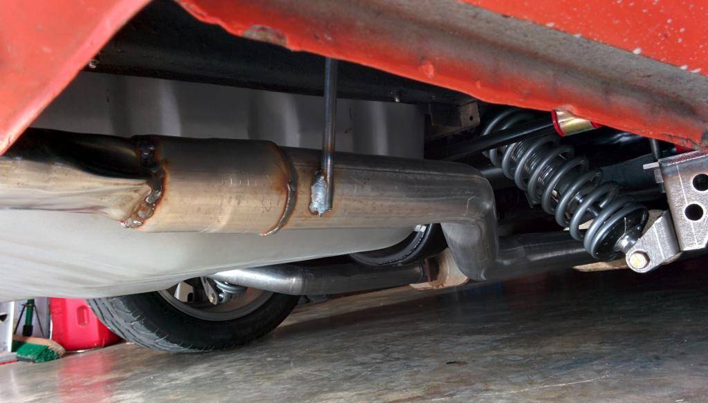

      I have the Rod and Custom 4 Link on my Mach, just wrapping everything up. I am no fabricator and couldn't find an exhaust guy that would route it over the axle. So, I went for the under axle out the rear exhaust. I must say, I like it... If I want to drop the exhaust I can unbolt it and pull it out. And car sits so low, that from behind you can't tell if it's over or under. Love your Car(s).

      Can you post a couple of pictures of your exhaust? I was looking at it last night and think I can route it over closer to the tires than the center section. It's definitely going to be a challenge...
      I'll get some for you this weekend.

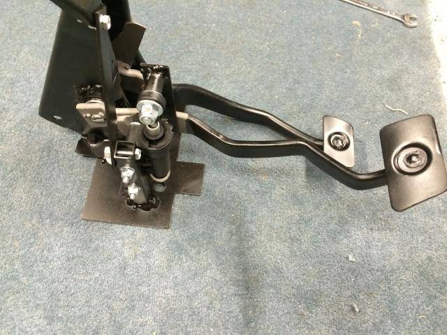

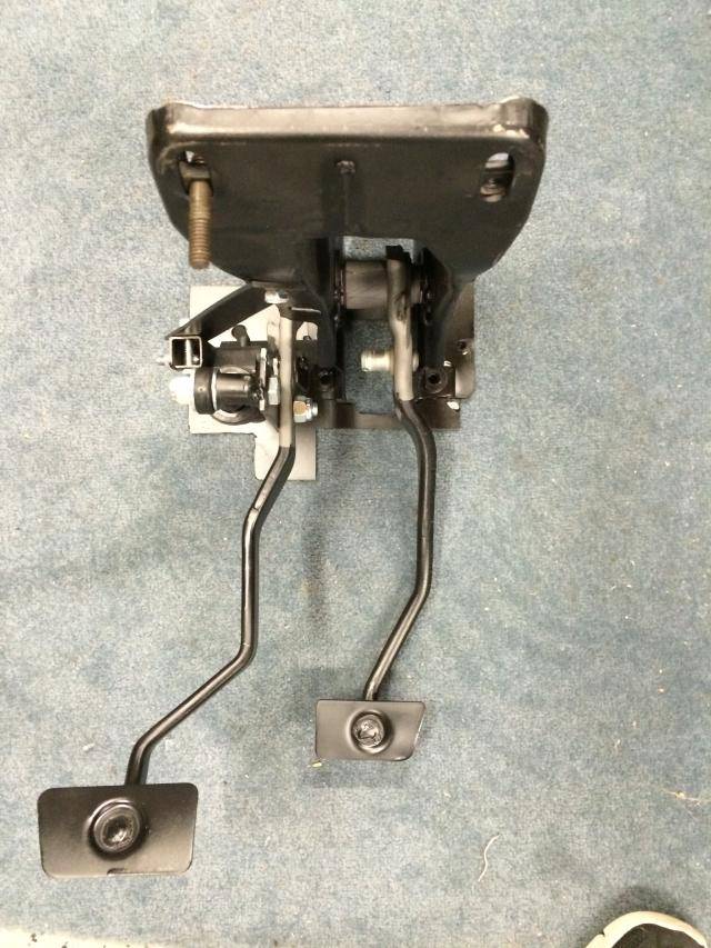

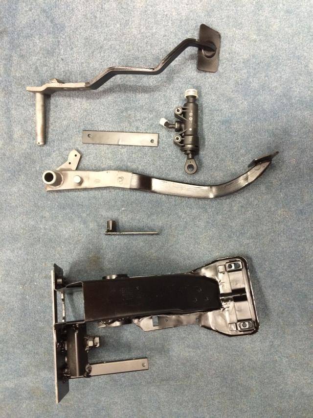

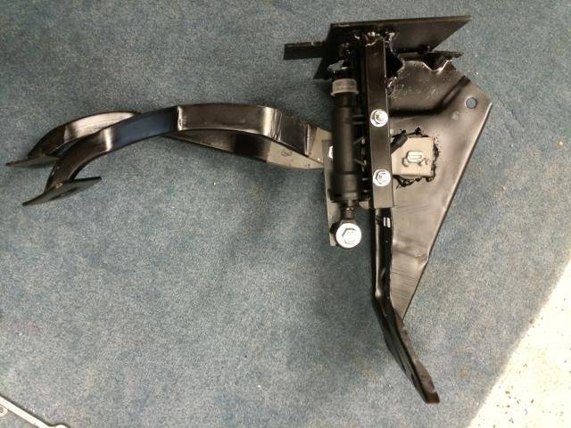

      Just finished the pedal support set up. I'm using a 2005 mustang slave cylinder and modifying the stock pedals. Notice the roller bearings for easier pedal effort.

      My Exhaust with R&C 4 Link
      Finally got some pics... Sorry they are not the best....

      That's right. You guys have the gas tank to deal with
