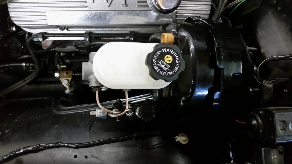

      Well, I ordered a 9" dual diaphragm booster and im hoping it's bad out of the box. The pedal presses very softly and returns very slow.....so slow I can't pump the brakes

      Quote Originally Posted by bad86ss View Post
      Who did you get it from? Did you change master cylinders too?

      Got it from advance. The master cylinder was replaced a few months ago

      Booster is a reman CARDONE and the master cylinder is a 15/16 bore from a 79 Riviera.
      Even with the brake booster not hooked up, the pedal stroke seems longer than I want too
