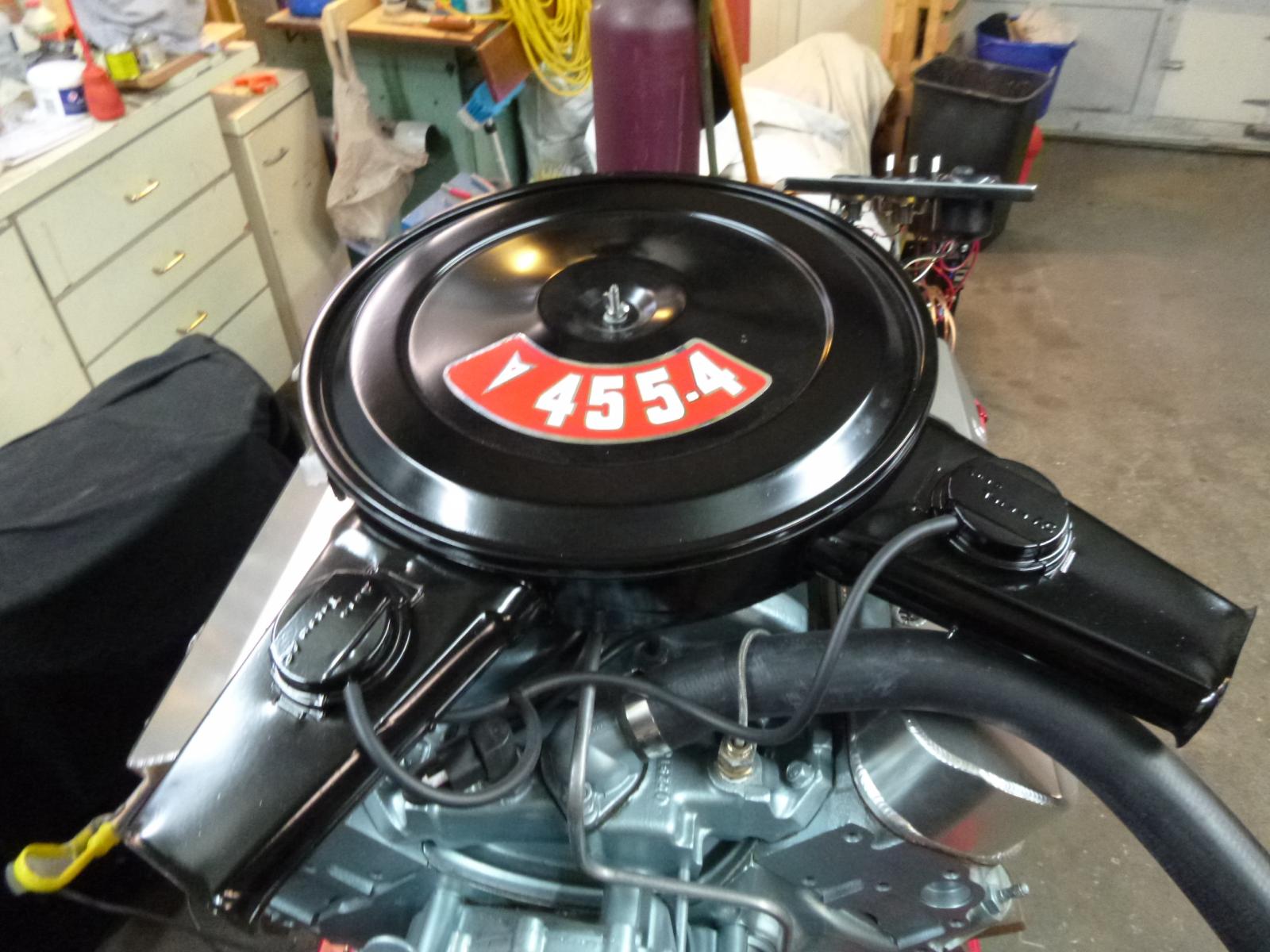

      Here is some info on the engine and drive train, forged pistons, forged rods, mild cam, mild head work, HEI ignition, port matched stock intake with a Q-jet built to Jeff Ruggles specs for the engine, a T56 out of an 01 ws6, a strange S60, C-5 brakes all around.

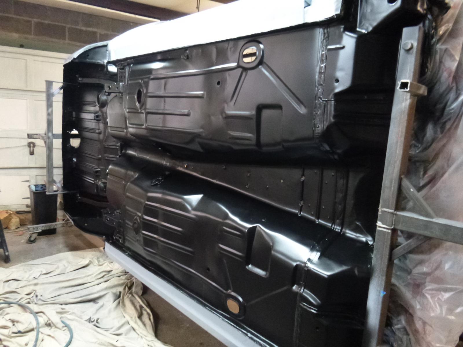

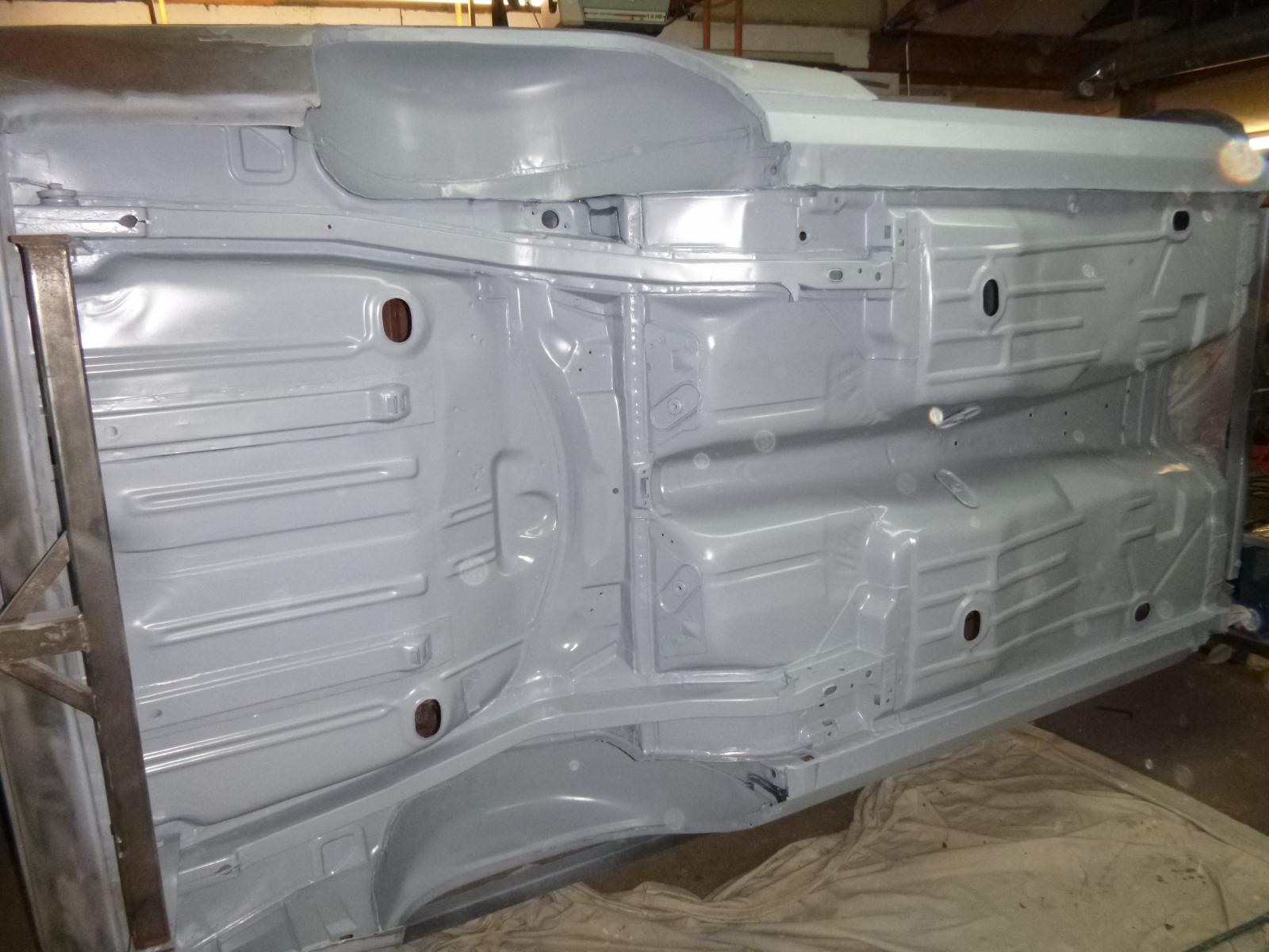

      I had the bottom of the car dustless blasted, holy crap the s#@t gets everywhere, in hind sight I would have had it dipped, bottom of the car is done ( I’m in St.Louis if anyone wants to buy a rotisserie cheap).
      Here are some pictures.

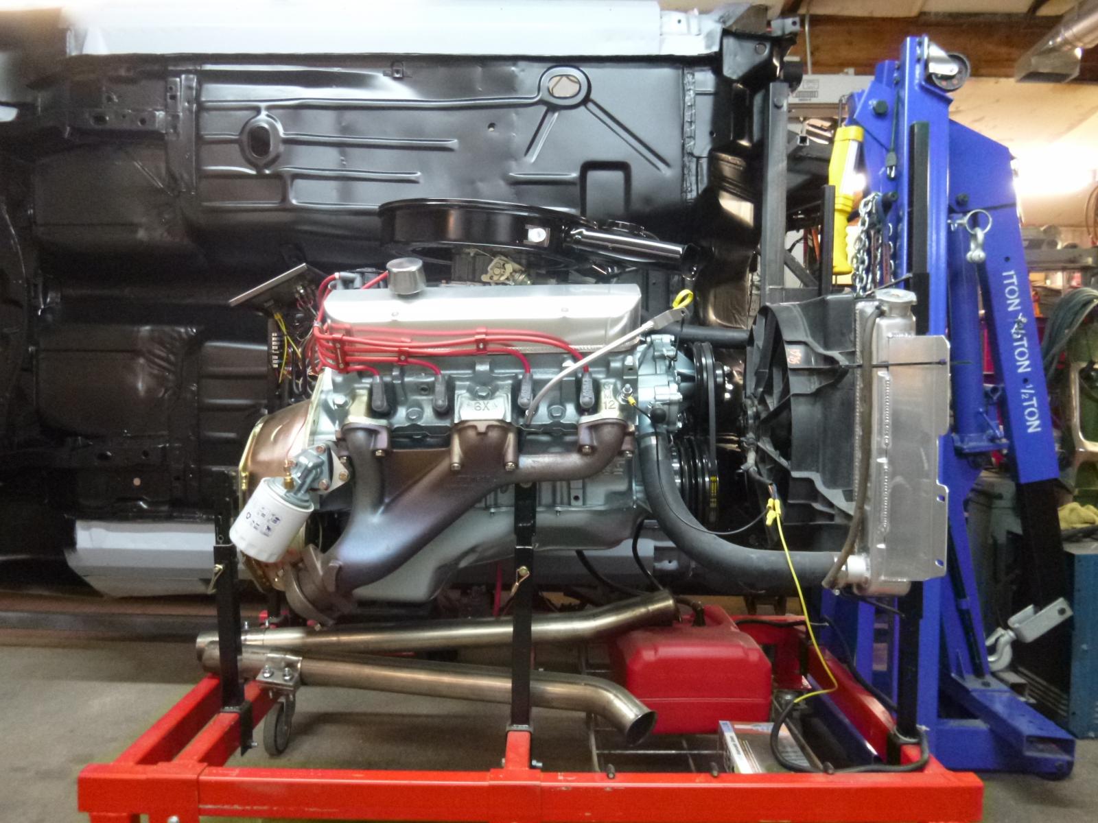

      Did you relocate the oil filter with an adapter ?
      May I ask a picture from the other side with oil filter & manifold, please ? I'll have to do the mod's myself soon when rebuilding the whole exhaust.

Size:  224.1 KBYes it is an adapter, got the headers and adapter from ram air restorations, they are larger inside diameter than factory, not cheap but they are awesome, I'm thinking of coating them with eastwood's high temp header coating.

      Thank you very much for the picture ! Now I see how the adapter relocates the filter clockwise to clear the manifold.
      I have the same manifolds from RamAir & the adapter too. Same 6X heads also, Dports right ? I hope as my manifolds are Dports...
      I also see the starting exhaust tube will have a different elbow driver/passenger side... exhaust mock-up will be a fun part.
      I think coating them is a good idea, I also bought them uncoated...

      See if this link works, its a video of the motor running.

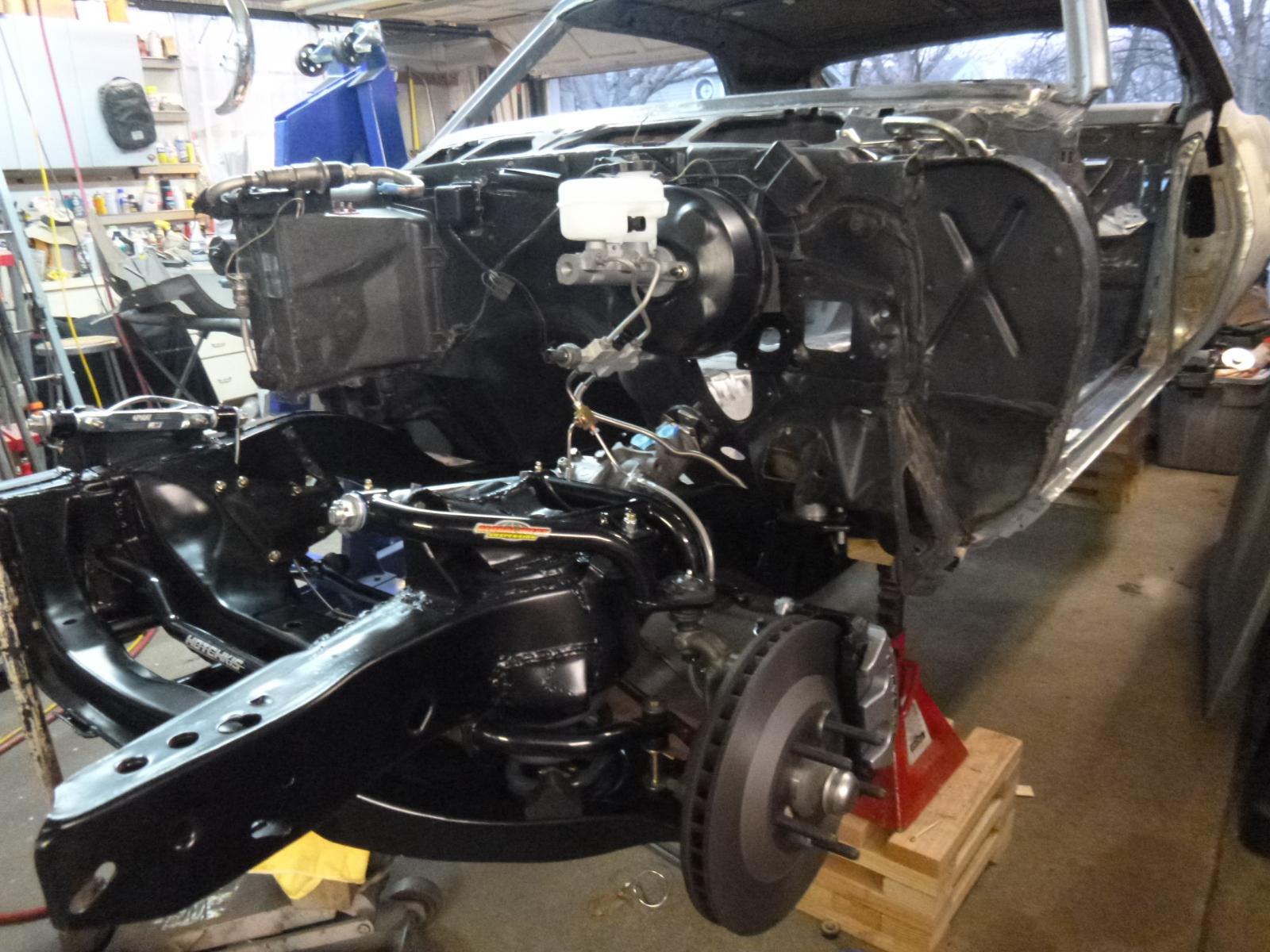

      Good progress, all the brakes and associated plumbing is done, Eastwoods flaring tool is awesome, just have to pull the master back off because I forgot the pedal carrier studs hold the master on, haven't ordered the wheels yet but I'm pulling the trigger on them this week, hopefully I will have a day or two over the next week to shoot the jambs, interior and trunk with primer.

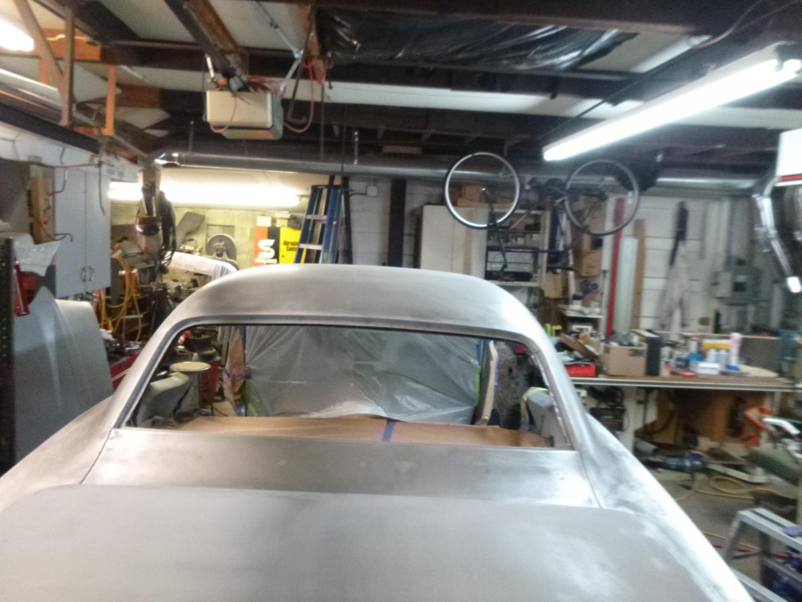

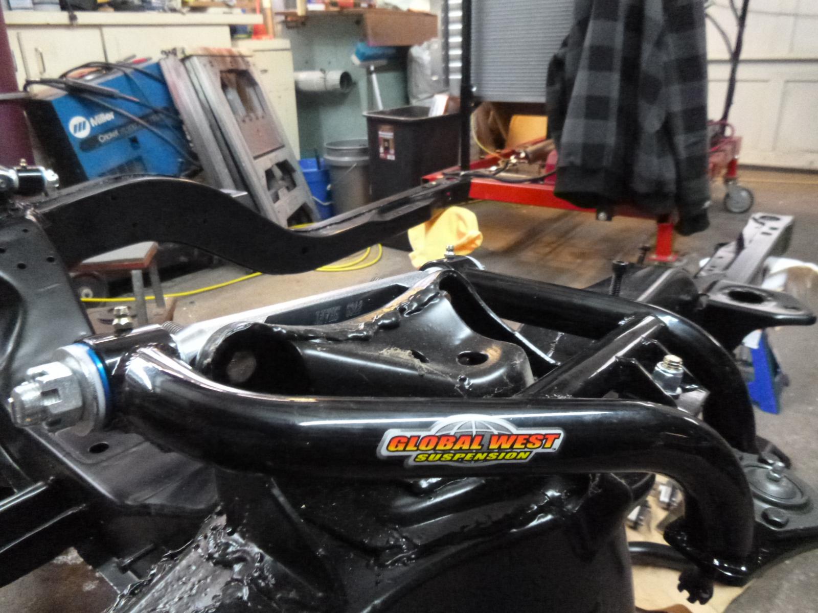

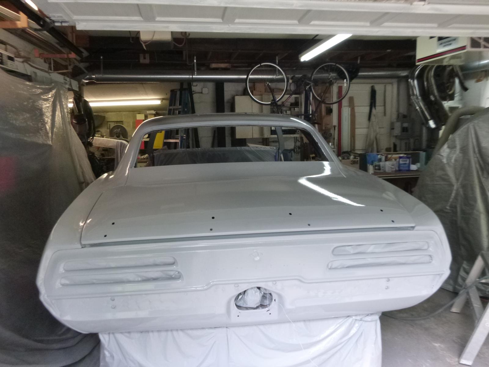

      Things have been slow going, as usual, swamped at work (is good) but the outdrive went south in the boat and now my truck is making oil, time for fuel injectors, I did get a few things done on the car, got the new fuel tank in and plumbed, the shell is in epoxy, I now wish I would not have drilled the trunk lid years ago for a Camaro spoiler, I would rather have the TA spoiler or none at all. Still trying to justify billet rally II wheels but after dropping several thou for injectors its not going to happen anytime soon. I may end up selling our 70 Bonne vert for wheel $$, I would love to keep it but I don't have room in the garage for it much less if I were try to build it, trying to store parts everywhere, seems like everything on the car is eight feet long. Here are some recent pics of the firebird.
