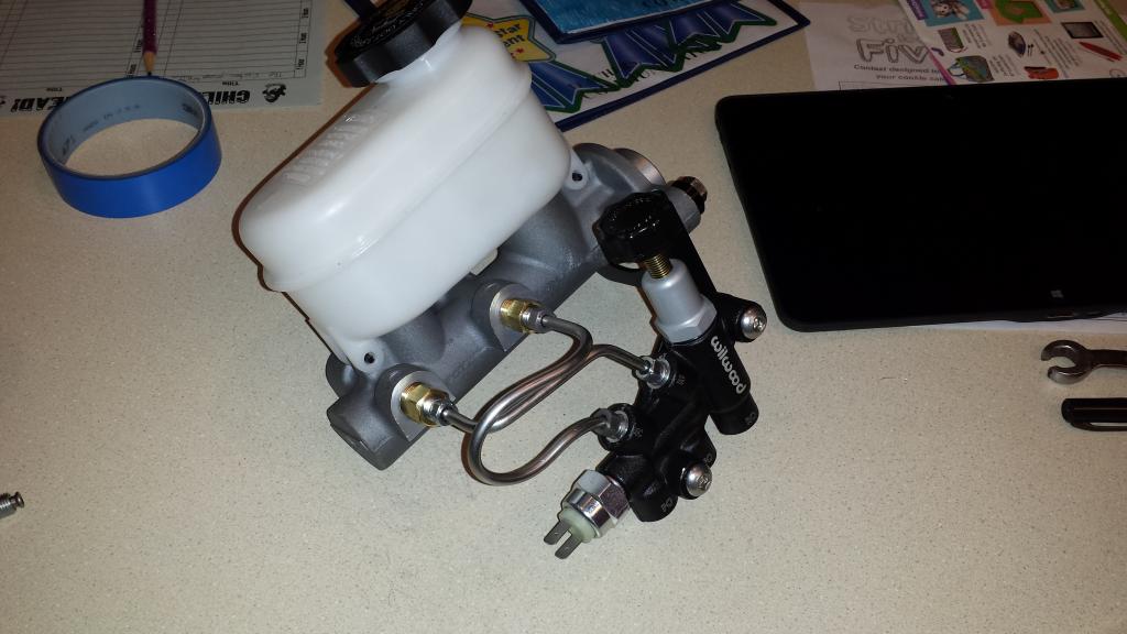

      Order is with the bracket

      Nice, did it come with a bracket
      Jun 2012
      250
      Yes and 1 line I bent the other.
