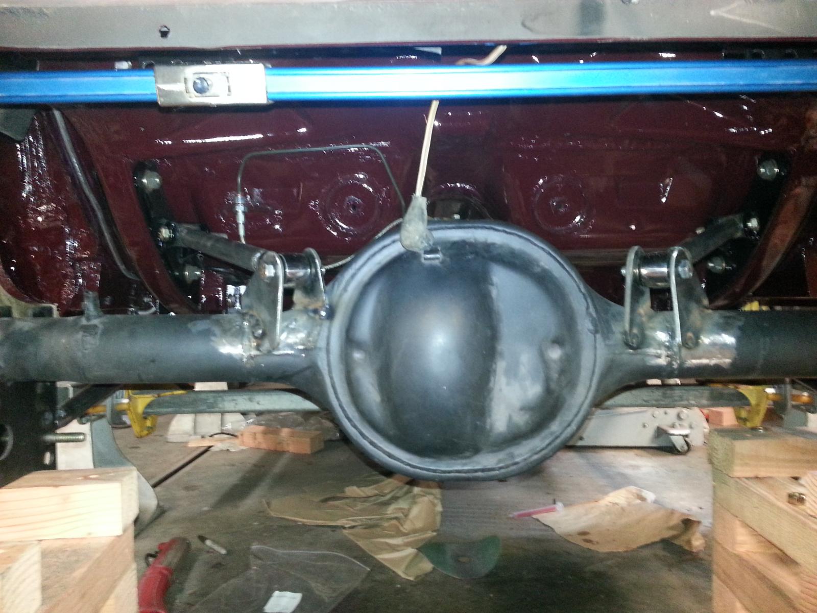

      70 cougar reborn
      The underbody was painted along with engine bay all to the body color ford Maroon. Some rust repair with a twist on rear lower 1/4 where they rend to rott out instead of using paych panel I used stainless steel on inner and outer on the bottom 6 inches did the same on the doors lower corners and also trunk lower corners.Rear suspension reinforcement brackets were bolted on after paint .
