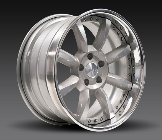

      Forgeline is out of control with the prices. give me a break. Have you look at the ET Wheels model LT III. They are a minilite design. Im actually going to be buying a set later this year. Check them out if you havent already
      Quote Originally Posted by jtwoods4 View Post
      Turns out Forgeline has a new wheel called the "Laguna" that is a modern take on the old school mini lite.
      Here is a pic. I am considering these for my car but $9000 for a ****ng set of wheels is absolutely ridiculous...

      Wow those wheels look perfect! Are they capable of withstanding the abuses of road racing?

      $9k for wheels? What is it that makes them cost 9k? You can build an entire stroker Pontiac for that much.

      There is nothing that makes them 9k. yes the wheels are nice but there is nothing about them that makes them 9k. that is a price that is set to market to a specific crowd of people that are willing to pay that and apparently that crowd of people is choosing to pay that so that's why they ask that much.
      Its just an inflated price, there's nothing special about them that you can't find in another wheel for half the cost.
      For example, Formula 43 wheels offer the same quality. nowhere near as expensive.
      the main difference is the superior design aesthetics of the forge line wheels. the designers at Forge line are producing better looking wheels than anyone else.
      Right. I guess if the market will support it then the price is fine, albeit ridiculous but ok....you will never see me even day dreaming about $6000+ dollar wheels though. Ouch.

      well I've been looking four wheels and have talked to several wheel manufacturers and it is difficult to find an 18 inch wheel that will clear the large Wilwood brakes. I called forge line and they said no worries we'll just send you a wheel so you can test fit it. now how cool is that! guess that's part of the reason they charge so much money, great customer service.
      here is the GA3R 18 x 9.5... I chose the 9.5 because that is the largest wheel allowed in the NASA vintage outlaw class.
      enjoy the video
