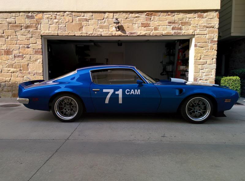

      They sure are pricey, but they do look good on a 'bird!
      (a little dark, but I love this picture!)

      Quote Originally Posted by carbuff View Post
      And worth every Penny of it... Forgeline builds quality and they tend to in general cases tend to be very light.. The nature of the design is stunning John,, and I know Ben Hermance so I wouldn't be surprised that this is no exception... It'll likely be light,, it'd built right, and it'll perform as a solid track day rim should in the safety side of the equation....
